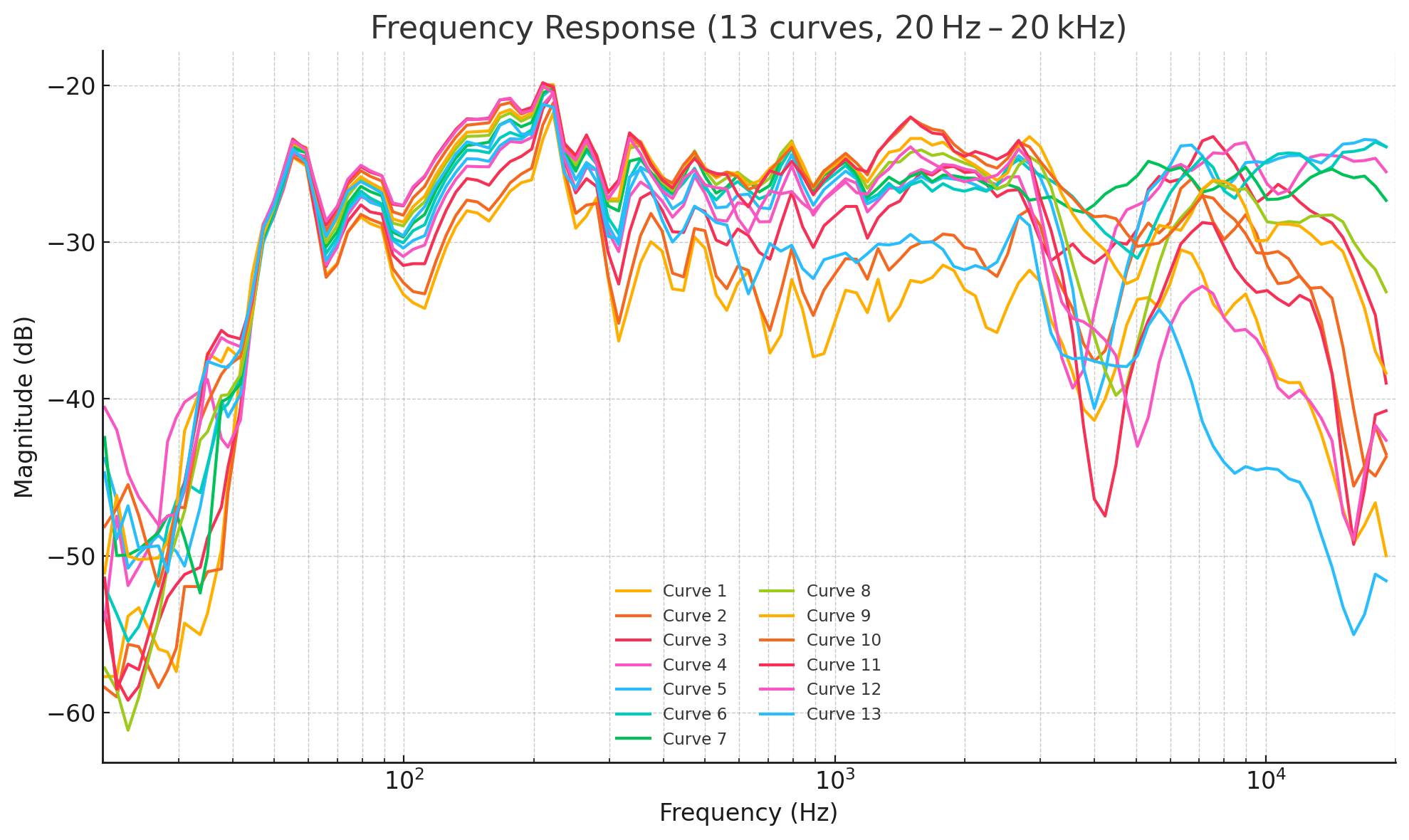

Do you have the 13 instead of the csv?13 plots. CSV attached.
Hi, I have a box, aprox. 70 liters. I have a driver, a Thomann 12-280/8-A cheapo. Now I need a speaker for passive usage as a stage monitor for drums (fullrange, ported) and/or a speaker for a bass amplifier (ported). Without corrections for bafflestep I will try to model it (and build it) using ChatGPT.

Some back up information as a sanity check maybe?
See here and maybe use as a point of comparison after ChatGPT has done its work.
https://www.hifi-selbstbau.de/index.php/hsb-datenblaetter/tieft/the-box-speaker-12-280-8-a?showall=1

Yes, I'm using their corrected T/S data, even if I'm suspecting that the tolerances are very broad in such a cheap series.See here and maybe use as a point of comparison after ChatGPT has done its work.
