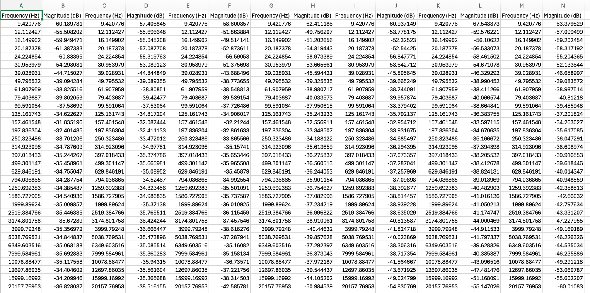

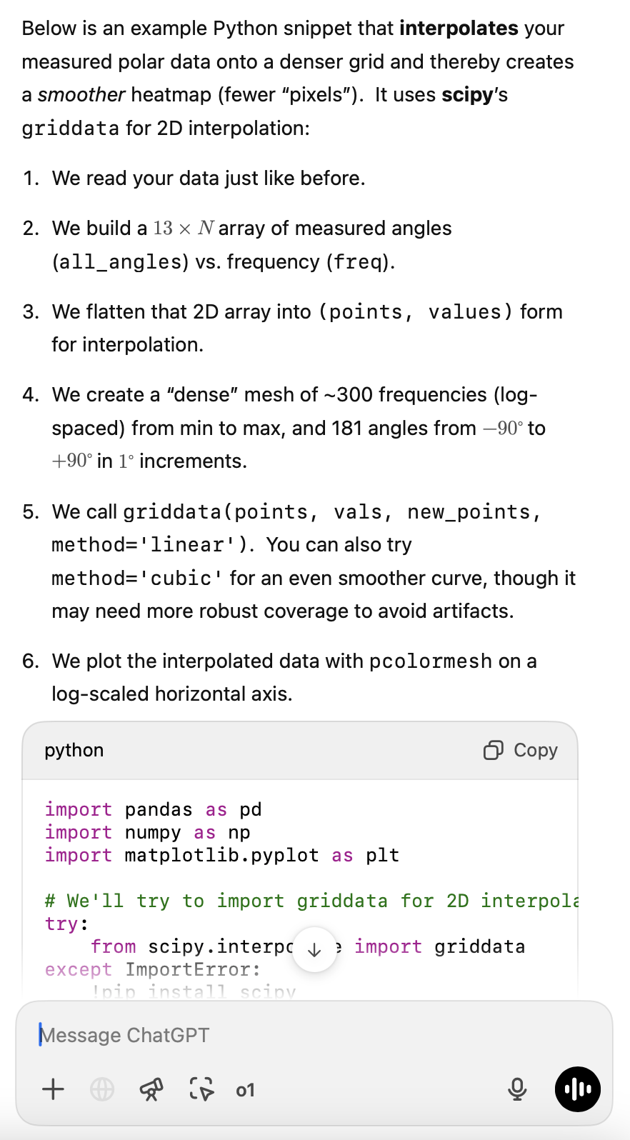

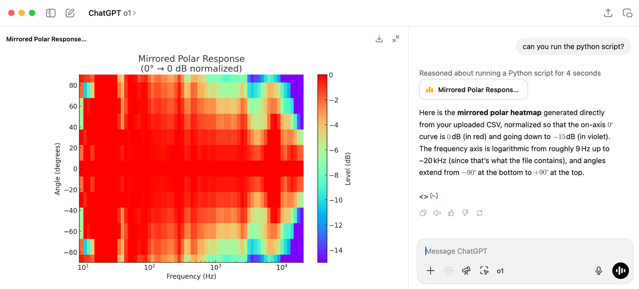

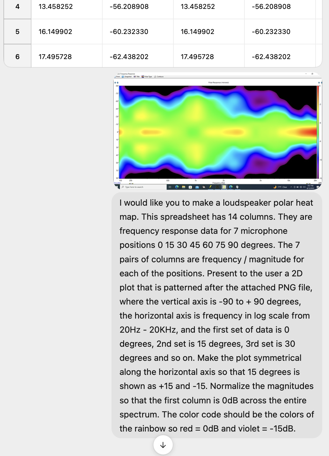

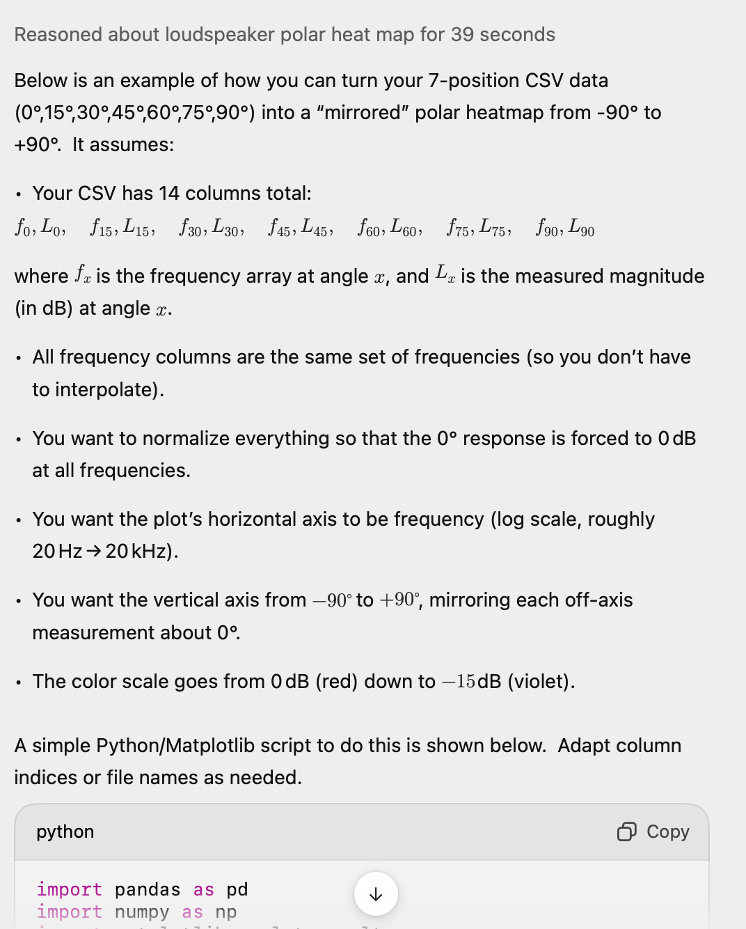

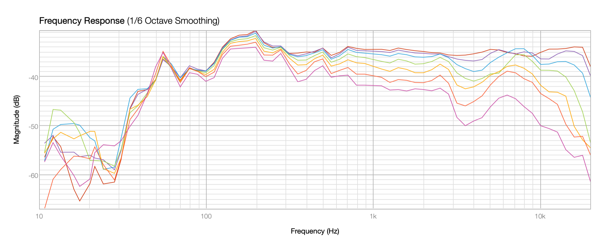

Generated from CSV using ChatGPT. Looks same as original measurements.
