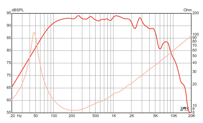

Experience/Comments Using Eminence Legend B102 as a Vocal Loudspeaker
Does what seems to be an amazingly flat output between 100hz and 2kz when installed in a 1 cubic foot sealed enclosure nearly as well as it looks on paper?
Member @conanski relayed is opinion of the similar 8" using the wizzer design as "very natural sounding" which is exactly what I desire.
I need a large quantity of sound without excessive amplitude or any sense of strain.

It is quite resonant in that range - see the impedance wiggles. I'm pretty familiar with the driver and I do like it a lot for live audio and even home audio, but it's not very hi-fi. It's more of a rich, muscular, vintage-y sound. It can be mated to a 45° waveguide HF driver really well with active or passive xover.
Thanks so much. Am happy with that description. The physical instrument it accompanies, a Baldwin M "baby" grand custom built at the height of WWII is very often described in much the same manner--for better or worse.

Having plenty of sealed 1 cubic foot boxes when fooling around with 10" drivers.
No I didn't like it sealed.
It woke up and was not bloomy like typical bass applications.
If it was put in larger 1.8 cubic feet box or basically with ports, handles, hardware blah blah
closer to 1.5 cubic.
Getting impedance sweep to have even bumps in the low end.
around 45 Hz tuning, not typical 55 Hz boxes
Basically to be honest tested it in a 12" box
and built something for it, because it woke up in the bigger box.
Not vintage it has clarity and takes EQ fine.
