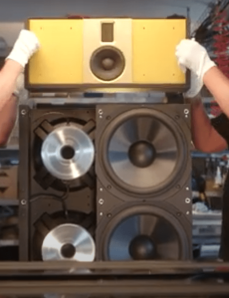

I recently read about a loudspeaker from the company Steinway Lyngdorf, the Model B. This is a large, heavy, and extremely expensive dipole loudspeaker system. It uses six 12" underhung woofers per side. This video of the company owner describing the speaker and its properties aligns very much with my own perspective on dipole systems:
The problem using so many woofer is that they occupy quite a lot of real estate. I prefer my speakers to be more compact and have a small visual footprint, so that sort of approach would not align with my goals.

Thanks for posting that video. I wasn't aware of that model B. Very knowledgeable and enthusiastic man. The bit that resonated with me was his reference to bass feeling and speed from his model B. I can certainly relate to bass speed but have found dipole midbass (above 70Hz) to be a bit thin and I yearn for more feeling. Maybe I need 3 or 6x 12" per side vs one 18"...or maybe it's the Faital driver I'm using.Another driver could be added to the list above: the Seas L26RO4Y.

So I am thinking I might try to clone the Model B woofer configuration albeit with 4 woofers rather than 6, but I’m puzzled by a couple of things; in the video PL says that they load the woofers and squeeze the sound out. This sounds like the same principle as a SLOB or Ripole, but they clearly aren’t using either of those configurations, so how are they doing it? Second, why are the woofers offset and what is happening in the space to the side of them? Perhaps the answer to that also answers my first question ??

Maybe this short YT video can help somewhat:So I am thinking I might try to clone the Model B woofer configuration albeit with 4 woofers rather than 6, but I’m puzzled by a couple of things; in the video PL says that they load the woofers and squeeze the sound out. This sounds like the same principle as a SLOB or Ripole, but they clearly aren’t using either of those configurations, so how are they doing it? Second, why are the woofers offset and what is happening in the space to the side of them? Perhaps the answer to that also answers my first question ??
