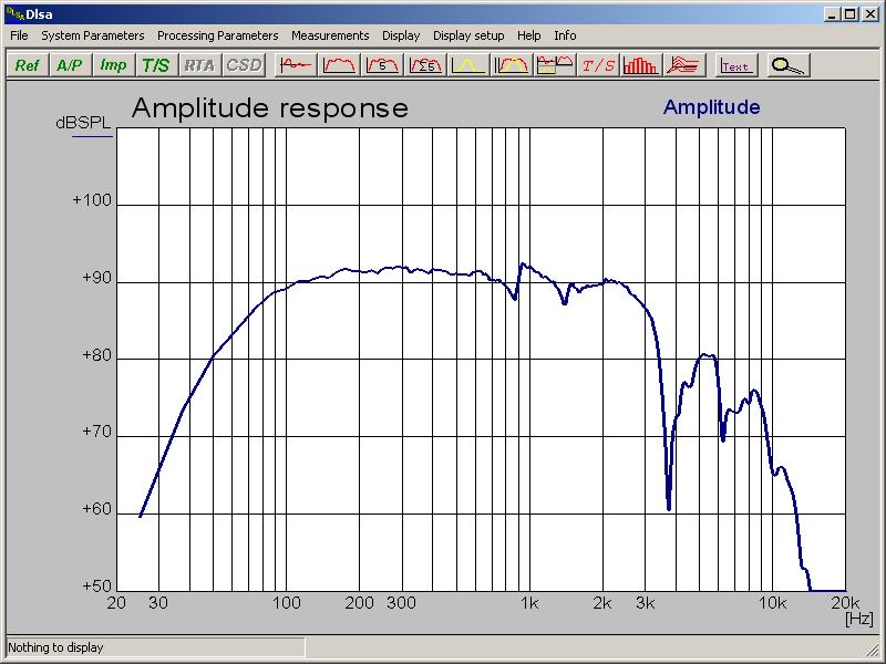

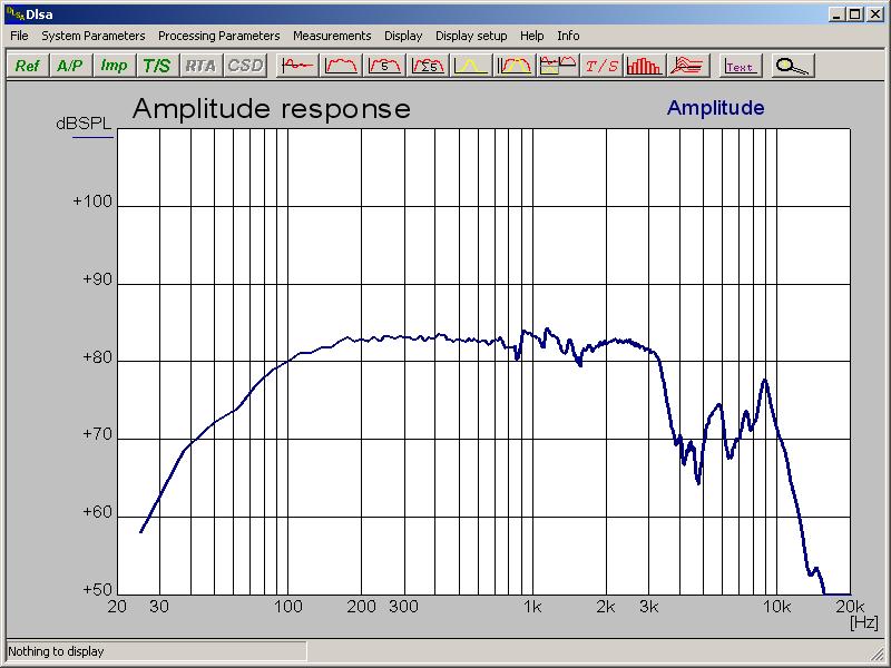

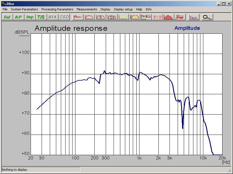

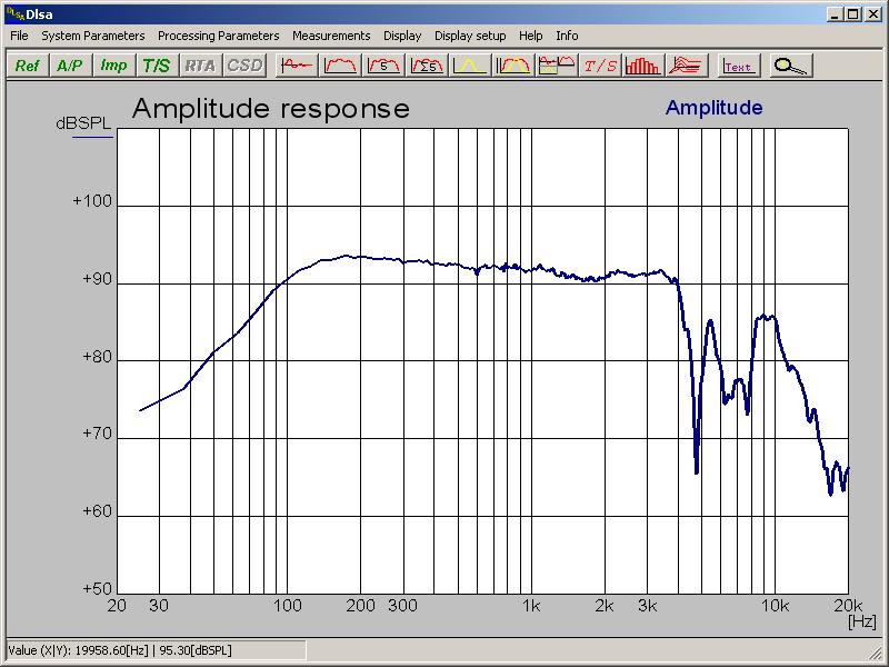

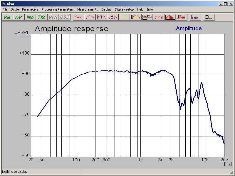

The sphere/horn works wonderful. A very nice invention of B&W. Before I build the final enclosure, I have tested the concept. To show my findings, I will post a couple of measurements. My way of identifying standing waves inside the enclosure is to measure with the microphone at a very short distance (0.5") from the driver. The standing waves leak through the driver cone, they are audible and can be measured.
I will start with the sphere with the back of the sphere open. You can see standing wave such as predicted in the white paper of B&W (900 and 1400Hz in my case are the most clearly visible). In addition, you can see the 1/4 lambda standing wave caused by the open back at 240Hz.
When the tapered tube is filled with about 10g wool, loose at the large opening and tight at the small end, all standing wave are gone. Even when the sphere is completely without stuffing! What remains is the respons of the driver, in this case the Peerless HDS134.
By the way, working with straws is not a good idea. I have tested such things, it just doesn't work. If you want to keep it simple, build a small heavy box and stuff it traditionally to obtain a clean and uncolored midrange.

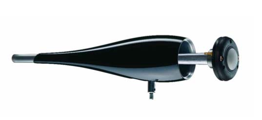

another thing that is confusing me, why does the b&W use a tapered pipe on the tweeter?? most tweeters are enclosed, why do we need a TL for the backwave, is there one??
signed,
confused.
oh well. I can follow the 'formula' above for starters.
signed,
confused.
terry j said:I use firefox (is that what you mean?), tried explorer and got the same thing.
I guess you are saddled with Windoz? Try right clicking and see if there is a "Save Link As..."
All tweeters have a backside loaded into something. There are a number that use a TL instead of a sealed (or aperiodic) chamber behind.
