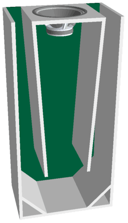

Brett if it's easy, a quick sketch would be great (gotta know what to build)
understand about the w shape, but that is two dimensional, would we get any improvements if it was 'rotated' about a central axis, ie 'three' dimensional?
TBH it would be easier done here, can use the deqx and only listen to the mids playing their bandpass frequencies.

Brett said:the length and exact details of the 'tube' will be all that important. Just get the rear wave away from the driver into a well stuffed enclosure and if the path is a bit convoluted, all the better.
That is the recipe... it is aperiodic in the end, as long as it is big enuff the other detail is minor. A heavy taper lets you get away with a smaller box. If you can make it a straight shot out the back you'll have fewer reflections... in a retrofit, i'll often just use a chunk of PVC out the back (if you are shy on cabinet volume it could just stick out of the box (with the obvious aesthetic caveats)
Here is an example of a W (just shrink to size for a midrange)
If you really want to test your cab building skills you could make the 1st section a pyramid and have 4 termini on each side of the driver.
dave
I think I can work with something like that dave, thanks. going the four terminae (?) is what I was wondering about.
a few confusions still, I always thought aperiodic was to do with 'venting' to the atmosphere, but I can simply seal it off yeah?
The enclosed volume remains the same, ie say ten l in my case?

terry j said:simply the pyramid, the w, the reflecting walls.
Since the point of thedm is to make a transmission line they need to be solid. It is the length of the TL that gets you the ability to absorb to a lower frequency (i'd never use MDF thou -- not a good material for building cabinets out of)

Terry, Dave's pic is similar to what I would have drawn, with the addition of a wedge on the wall directly behind the driver to act as a reflector into the curves.
If you meant resin and fibreglass as a wall material, that would be fine as will MDF in this application. I'd also seal the holes at the end on the baffle.
Although you only need 10L of internal volume, more shouldn't be an issue. It will just make the Qt a bit low, but you're no doubt going to EQ to taste anyway.
