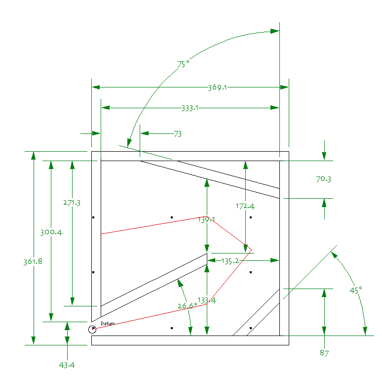

Attached is a mid-line that comes to 100-150 Hz once you consider end correction and the taper.

Ok, confusion time. A TL has to 'exit' somewhere?? I thought the B&W thing was sealed? (thought you said exit in your post, but I can't find it now, must be going mad)

Nautilus is a 1/2 wl line, which by definition is sealed. If there is an open terminus, it automajikly becomes a 1/4 wl line.
By remove the back wave you lose a lot of the time smear from reflections, increasing downward dynamic range, The box is more detailed and less "boxy"
Yes. But as long as the box is not too small it gets pretty forgiving.
A skilled MJK operater could probably get some useful sims -- the damping density push above the limits of his sw. An impedance curve on the finished box also provides useful feedback,

The B&W picture i posted is rectangular -- it has flat, parallel sides. Lots of folds and not severe so that it is a spiral. The quadratic taper in the production Natilus gives them a more dramatic taper while retaining a similar cross-section aspect ratio and non-parallel sides. This should impact things positively.

Hi Terry
Brett and I were talking about this 2 weeks ago ,I drew up some silly google sketchup tapped horn for the 10" driver that went to the ground and acted as the stand .

I did find a cutaway pic of those chambers, that will be my 'monkey see monkey do' starting point when I mock up some differing chambers. One noticeable thing in those cutaways is the obvious bulbous shape just behind the driver, which then ends in a taper.
That seems quite different than any suggestion of a simple decreasing taper the entire length.
