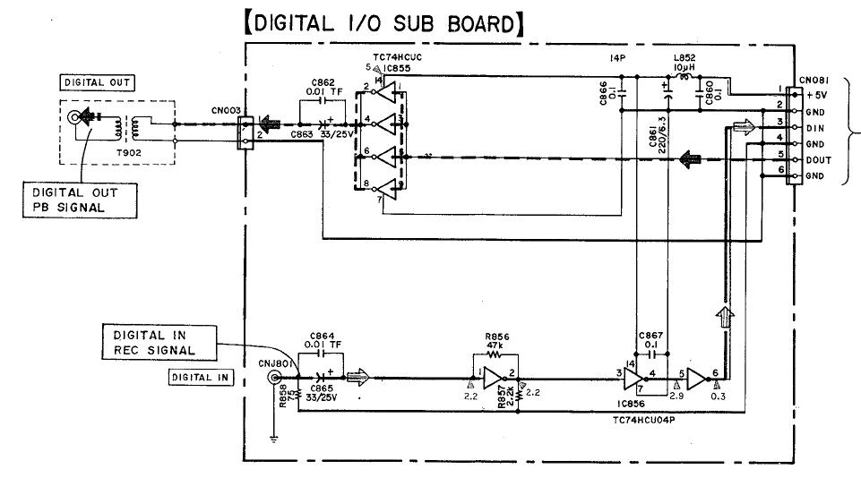

The digital I/O line goes like this:
Digi-IN/OUT > Buffer IC > Digital I/O IC.
I ran a search on IC numbers online - no info available.
Any clues?
Funnily enough I know theres USB products for laptop that support coaxial but I wonder how easy it is do this anyway, both interfaces convey SPDIF surely its an easy switch.

Thanks dacen, I already have the service manual... 🙂
Didn't see this part, but I'm still unsure how to approach this? Perhaps I'm being lazy?
Edit, I attached this section for anyone to look at

I was thinking more of a PCB part to add to the DAT or a simple mod I could apply to the 3.5mm jack of the audigy.
I do have a soldering iron, perhaps an easy lesson for diyaudio...
Even on CPC an electronics outlet doesn't have this mysterious jack/converter plug found in the audigy... If I found one online I'm sure documention can provide instructions but I've yet to find the part 😀.
Getting closer, "opto transciever" i think is what I'm inquiring about
EDIT: Can't I just add this to the corresponding + and GND ???
http://dgsaixin.en.alibaba.com/prod..._optical_audio_toslink_spdif_out_DLR2131.html

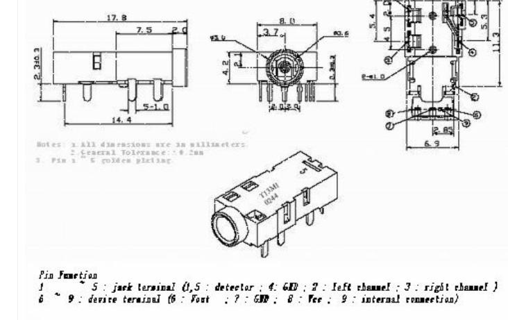

Hmmm,
If for example the below image is standard procedure in all combo jacks, can you append or swap one (or both infact) of the L+R 'channels' to the SPDIF signal.
SPDIF would this be VCC in this case? (see attachment).

I won't need that pure optical adapter (3.5 to Torx) like you suggest,
Rather;
Pry open the audigy,
Disconnect stereo dac/adc functionality
Wire SPDIF to stereo L (or R) of both jacks
Close the audigy
Run standard (mono) 3.5mm to COAX cable adapter to the DATs digital input/output.
