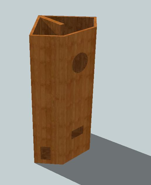

D9x cabinet
Hi guys,
Here comes a little 3D rendering of the cabinet (sans top plate) that i have been playing around with for the D9 family of units. It is app. 110l and has two ports. A pair is made up from two mirror image cabinets where one can have the lower ports facing inwards or outwards depending on what fits ones room and/or taste. The ports are easy to adjust, for more lower midrange one makes the fron port dominant and for less the opposite. I have done quite some tests with these made from standard marine ply with very good results and are awaiting one pair made from 18mm bamboo ply by the end of this month. I will get back here when i have done some more testing with the new bamboo units.
EDIT: The unit is mounted against the the center "pillar" and is just sealed against the baffle with a thick felt gasket.

Re: D9x cabinet
Dear Anders,
That looks VERY interesting indeed. Very elegant in its simplicity, IMO. Is there a long bolt reaching through the reinforcing "spine" into the threaded hole in the back of the yoke?
-- Chris

Thanks Chris,
You are correct, a threaded brass rod goes thru the "spine" and is tightened with a wing nut at the back of the cabinet. I am in the US at the moment but will start sorting out the bamboo version as soon as get back from here on the 29th.
