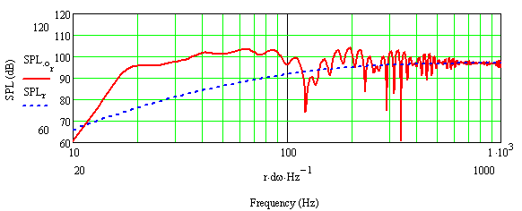

Re 16Hz out of a Lowther, it's not especially difficult to achieve in theory -the PM6C driver is on Xmax at 16Hz in this hyperbolic for example, & there's some travel left before Xmech. It's fairly efficient too, so distortion should be low.
In practice it's another matter. This thing makes the Kleinhorn look like a Frugel-horn. 400ft^2 mouth area & ~41ft long. Each. In a hybrid QW / horn design it would need some very good protection indeed to keep the driver safe if tuned that low & the response would be all over the shop. Not a good idea. FR drivers do many things well, but sub-bass isn't one of them. That's what Tom Danley-style tapped horns with 15 - 18in woofers are for.
Scottmoose said:[FR drivers do many things well, but sub-bass isn't one of them. That's what Tom Danley-style tapped horns with 15 - 18in woofers are for. [/B]
Indeed. The horn that my friend made is still in use, but it has been shortened and the Lowthers replaced by a 15in Altec woofer. As you can imagine, shortening a concrete horn is no picnic.
