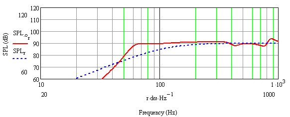

And here's a possibly useful box of the same type as I suggested above (reflex box with a massively flared vent) for the D5nf.
Cabinet is 6 1/2in wide, 10in deep. Upper chamber is 14in tall. Slot 1in deep & 3/4in thick firing down into a 15in tall flared vent. Strike-plate starts 2in down from the slot. Again, very much like the CAD render of SuziChang by Dave shown above. All dimensions given are internal BTW.
Re the BIB, I'd say it'd be more trouble than it'd be worth to try doing that -it's a horn, so you don't want to be muching up the airflow / expansion if possible.

I made a drawing to build this, so I am sharing. Can you check it over to make sure it matches your intent? Thanks
Should driver be high as possible on baffle or centered?
All parts solid "one by" (13/16") spruce board
Design name? Design credit? Donation to Martin? Lemme know if you want me to comment the drawing, like "Designed by Scottmoose using software created by Martin King. For DIY only. Not for commercial use. "
I will update the drawing with your comments.
Rich
Hi Rich. The diagram is correct, though the slot-vent only needs to be the 3/4in thickness of the build material in length. Front-back it's 1in, vertical, 3/4in. I'd mount the driver-centre 5.75in down from the internal top.
This is one of my Spawn designs & part of the Frugal-horn project (a CAD diagram will appear there in the near future). As such it's free for DIY purposes; commercial use must be discussed with the relevant parties.
If you could add the 'Designed by Scottmoose using software created by Martin J. King' to your diagram, that would be great -thanks for being willing to add that. Always best to cover all bases. We'll think up a name for it too -any suggestions guys?
Speaking for www.frugal-horn.com, which I designed this cabinet for, a small donation to the site is always much appreciated -it helps keep it going (same goes for any of the Spawn boxes). That's purely a voluntary thing DIY builders can do should they wish -we don't request anything, it's there for the community. At the risk of speaking for Martin, should you wish to make a small private donation to him for the software that was used in creating the design, then again, I suspect it will be appreciated. Being a decent bloke, Martin never asks for anything for DIY boxes designed in his software, but I imagine the gesture
