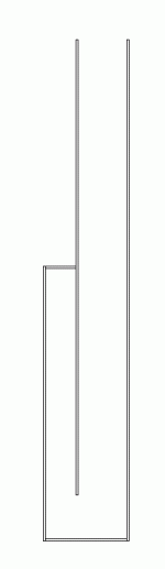

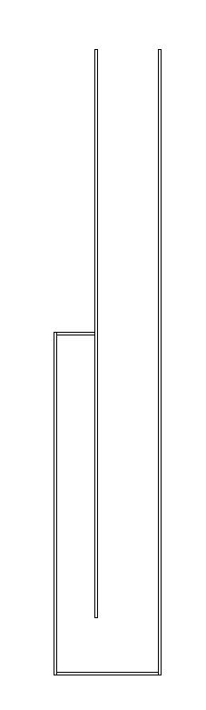

Can you talk about those cabs? They look like they are two different cabs...
Sizes. etc

That's pretty. I imagine it's a Nessie variation. Basically, a ruddy great big folded resonance tube. As a ROT, they're made of two pipes, the driver being mounted at the sealed end of the shorter one, which is of about 2/3 the CSA of the larger one to the rear. Like this:
