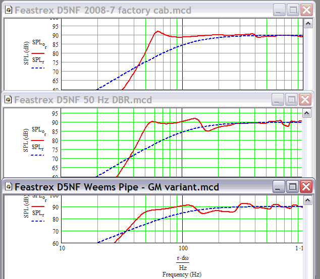

KM, here is the PDF file of the newest version of the Feastrex enclosure in question.
.........he got best results by having the distance from the center of the driver and the top of the enclosure be the same as the distance between the center of the port and the bottom of the enclosure . . .
.........he also used an OVAL port of the same area............
Greets!
Curiosity got the best of me, so did a sim of it along with a DBR and my Weems pipe variant that I believe will perform well in-room once damped to suit though they don't look as half space flat overall as the factory cab. What they don't have is excessive peaking at Fb that requires more damping than the others (even worse for the driver/vent being equidistant from the top/bottom) and only my Weems variant has any impedance damping of note.
For sure all of them will require some BSC if not wall or corner loaded and/or driven with a high output impedance amp (up to DF = ~1). That, or the driver's response is somehow coaxed into ~ flatly shelving its mids/HF response which I've never seen and not sure if it's even possible for a BW to 20 kHz.
Oval/whatever doesn't audibly affect the sound as long as its not so high an aspect ratio or complex enough shape to make it acoustically resistive.
GM

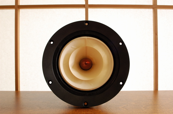

Here is another prototype from Feastrex . . . sounds very good, apparently. Width is 335mm, depth is 335mm at the top and 390 at the bottom, and the overall height is 1025‚�‚�.
-- Chris
Ahoy! yar there be the....
D5e Type I shown in the cabinet.
The inside is simply hollow. So it is a "triple port" single chamber cabinet.
BTW, as an update on the specs, I have been on the phone with Mr. Keith Larson recently and he has given me immense guidance and training, and informed me of many of the tradeoffs on the journey to make some reliable, useful measurements.
His level of customer service is simply stunning.
Again, first we will start with the basics, T/S parameters via the WT2 function, as for scientific interest, these specs are confirmable very easily by everyone "in the field." Later, we will work towards high power testing and sealed box VAS measurements of the more advanced WTPRO to start looking a bit further inside the driver's behavior with Mr. Larson's and everyone else's guidance and advice.
Also, before I forget, Mr. Teramoto has asked me to let everyone know that strictly speaking it may not be appropriate to refer to the standard Feastrex enclosure as an MLTL enclosure. That appellation was first applied by Chris Witmer for reasons that are understandable: there is no denying that the enclosure bears a superficial resemblance to some fairly orthodox MLTL designs. But the enclosure was not arrived at through the application of any of the theory or calculations that are usually involved in the creation of an MLTL enclosure. Rather, it evolved through a long process of cut-and-try experimentation (I asked him how many different iterations it went though, but I think he lost count . . .) guided by the horse sense that comes from many years of experience building enclosures -- especially on the part of the enclosure manufacturer who collaborated with Feastrex on it. Given the similarity of appearance, it is likely that there are indeed points in common with MLTL enclosures, but to call it an MLTL enclosure might tend to obscure the fact that there are also likely to be at least some significant differences as well. Thus Mr. Teramoto thinks it would probably be better to start calling it a "tall ported enclosure."
My personal opinion is that I tend to regard every speaker design as containing a certain set of tradeoffs. "Pick your poison," a dizzying choice, especially among the alphabet soup of TL types. But with enough tweaking, willingness to make mistakes and to and learn from them (and learn to live with them), and thinking outside of the box that we are building, most cabinet design types have a significant amount of musical potential. For someone like me, I am completely happy in life if I can apply myself to the grand communal cause of "unlocking the musical potential" from any sort of object. So far, I am incredibly encouraged by working with Feastrex as it appears that by biting off a bit more than I can chew in my current stage of development as an audio enthusiast, I will be forced to simply stretch my jaws.
A while ago, I was asked to tell everyone what I have been up to at Feastrex. To say that this apprenticeship has been exciting (and simultaneously difficult) for me so far is a complete understatement. The other day I started working start to finish on my first set of cones with Mr. Teramoto's attentive guidance. By starting this 2 week process, Mr. Teramoto informed me jokingly that I had just "set one foot in hell." Indeed, it is such and extreme undertaking that it likely contains parts of heaven and hell. He tells me frequently to "meditate on nature" while doing all the tedious and delicate assembly work. "Hell" probably comes from the fact that I will be waking up in the middle of the night from time to time, further obsessing about cone construction... "Nature is thinking so that I can be making nature sound." (If that sort of "Japenglish" starts to make sense, you know you have been in Japan too long . . . )
I should note that the fact that I have started this process hardly means that from here on out, I will be making any significant portion of Feastrex's cone output. As even my slightest of mistakes as a trainee makes the units unfit to sell. As one might imagine, QC for drivers of Feastrex's pedigree is the absolute first priority. Conceivably, it might even be years before I can get a handle on everything to the point where I can be entrusted with the sort of start-to-finish building of drivers that Mr. Teramoto is doing now.
Back on the topic of cabinets for Feastrex drivers, it is my understanding that people are definitely encouraged to come up with their own designs, and to excersize their creativity. The recommended tall ported enclosure could be considered to be a good starting point and reference for a speaker designer wishing to come up with their own unique Feastrex cabinet. Regardless of whether one decides to build upon that design or move away from it into another philosophical direction, the standard enclosure needs to be part of any would-be designer's initial frame of reference. Some people consider the looks to be rather plain, but with regard to function, from an end user's standpoint, the recommended cabinets are great because when well built they sound quite surprisingly and even amazingly good, letting the speaker driver do most of the "speaking" and they do not dominate the room visually.
