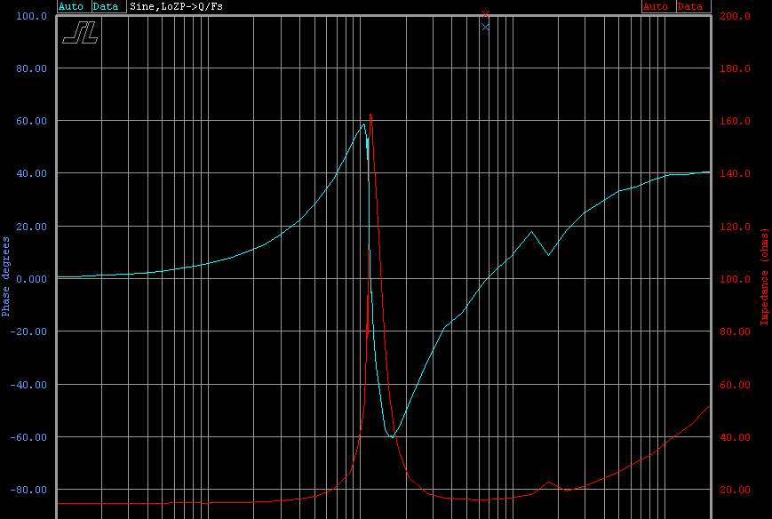

Attached is plot of impedance and phase vs frequency.
Frequency is log from 1Hz-20kHz. Scale is cut off.
Note anomalies ~1700Hz. This happened on every run, both drivers, regardless of test suspension.

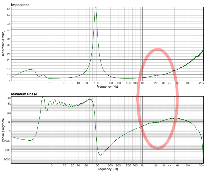

planet10 said:
The Fostex FE126 & FE127 have a similar anomaly in about the same place.... and they have no whizzers. But they are about the same cone size.
dave

Well, what can I say, there has to be a mechanical XO between the main cone and whizzer and there's no other phase 'wrap' shown in the Feastrex's impedance and since I know of no way to completely damp it down............

GM said:
Anyway, from just looking at the 126E's pronounced curvilinear cone profile, I wonder if it's a reflection from the 'mouth' to the throat', like happens with a horn that doesn't have a smooth enough mouth transition.
Possibly. I can reduce the magnitude of this bump by about half with the damar trifoil + puzzlekoat part of the cone treatment.
dave
Hmm, is it a spike in the impedance or an actual phase 'wrap'? A spike would be easily damped as its just a break-up mode, but a phase 'wrap' typically requires some serous damping, like excessive stuffing in a TL.
GM
I see no phase wrap in the impedance plot, but neither it, my monitor, or my eye's resolution is good enough to tell for sure, so for now those in the acoustic plot looks like either standing waves or break-up modes.
