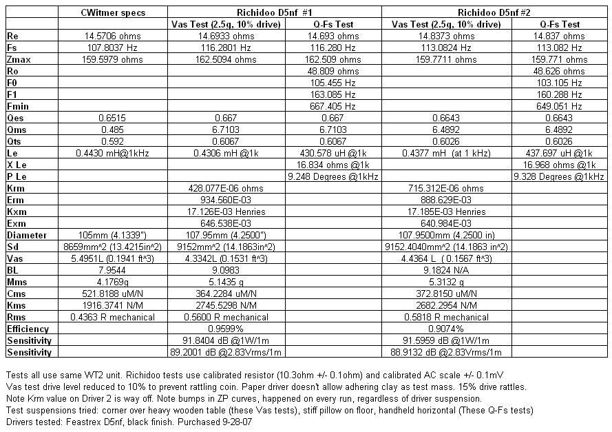

I spent yesterday and today getting familiar with woofer tester 2's idiosyncracies. :) I have run a few trial runs today and starting to get some consistency in the results. I hope to have best data possible (from WT2) posted by the end of the weekend. First glance shows that Chris' original specs are not too far off.

I also picked up a WT2 a while back and have swapped a fair number of emails with Keith Larson regarding it's use. I've done numerous measurements on the D5nf drivers but have not added any weight to the cone to do further testing of Vas, etc. I've decided the best possible method is to use a sealed box for the second round of measurements. Keith suggested around 5 liters would be good based on (his) limited information on the D5nf.
I'd be interested to hear your results.... especially if you're adding weight to the cone for testing.

Hmm, well, he knows his test gear, but it sure doesn't jive with the standard Vas sealed box measurement where you must raise Fs at least 50 %, which isn't going to happen if the original Vas measurement is even in the 'ballpark'.
Anyway, based on folk's comments about this driver's detail/clarity/BW, adding weight to measure it doesn't seem like any better a plan than adding it to an ultralight HF compression driver's Al or Be diaphragm. Indeed, I have to wonder about even subjecting it to a small enough sealed box..........

OK, here is the data. I tested them as carefully as possible. The tester has a personality, but we eventually got along. I have pretty good confidence in these numbers up to the limit of the tester's accuracy. I did many practice runs and the results remained consistent no matter what I did to screw them up. I was pleased to see that they mostly jibe with Chris' previous tests. Slight differences between my two drivers can be seen, and could explain the larger differences to Chris' test drivers, different batch, evolved design, etc.
Vas test was done with a penny. Turning down the juice kept it from rattling. The software told me I was within 10% of the ideal weight. Finding optimum mass and drive took a while. Perhaps the results would be more accurate if driver was driven to higher level with adhesive mass, but this will have to be good enough. If you want the air sprung test, I will build a box of MDF for it. Please advise how to estimate the interior volume with the driver installed. And no, I will not fill it up with sand or rice. hahaha I can just do my best guess, try to remember some geometry.
Attached is jpg of spreadsheet. Have fun!
