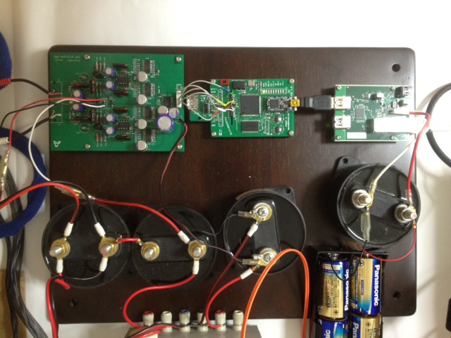

I'd like to report two products, at up-steam and down-steam of exaU2I.
I hope exa065 will not delete this post as "Off-Topic" or "Opposing his idea".
1. Adnaco USB High-Speed optical isolator
In the early days of this exaU2I thread, RayCTech reported his attempt of isolating USB High-speed input and an improvement of SQ. However, his method seemed too proprietary and violating USB specification. No one might have reproduced it.
Besides, exa065's position was, according to my understanding, that the most effective isolation point was the I2S as he provided.
Recently, I could get a certain level SQ improvement by applying an optical isolation on USB High-speed 480 Mbps connection between PC and exaU2I with a USB spec compliant generic product.
The product is "Adnaco-S3B – USB 3.0 Over Fiber Optic Expansion System" .
I tried it with DSD256 and DSD512 stereo play and found no problems even on such a high speed data transfer.
2. ElectrArt's "DSD principle board" (DSD filter)
Based on my experiences, I think it's not easy to establish a stable play of DSD512 using such commercial DAC devices as ES9018.
I applied ElectrArt's board as a beta-tester and got a good result.
ElectrArt?Digital Audio??? ???????? 1bit delta sigma DAC (In Japanese)
His board simply filters DSD signals and output audible analog signals through FIR circuit and OP-amp circuit.
Here is a schematic.
I could play both DSD256 and DSD512 output from exaU2I without any harmful "unlock interruption" nor "digital burst noises specific to DSD".
In the uploaded picture,
A. at the upper-right, Adnaco USB extender board with a battery power
B. at the upper-center, exaU2I board with USB bus power from Adnaco board
C. at the upper-left, ElectrArt's "DSD Principle Board"
I hope this information is something useful to "DSD-orienting" exaU2I users.

Hello Bunpei,
Thank you for posting about this project. The DSD512 board is exciting.
I see the benefits of the optical link when a longer cable is required. In terms of isolation it is redundant. There is no point to isolate twice, I am sure that that this will have no sonic effect.
Beside the cost, optical isolation is great. If you want to take this experiment further, you can remove the GMRs from the exaU2I. This will reduce the jitter. It will be still higher than the jitter of the new exaU2I V3.
Note to the exaU2I users with ES9018 DACs - don't bother removing the GMRs - in your case removing the GMRs won't make any difference. ES9018 takes care of the GMR jitter, and replacing the GMR isolation with optical isolation will not present a rational improvement.
