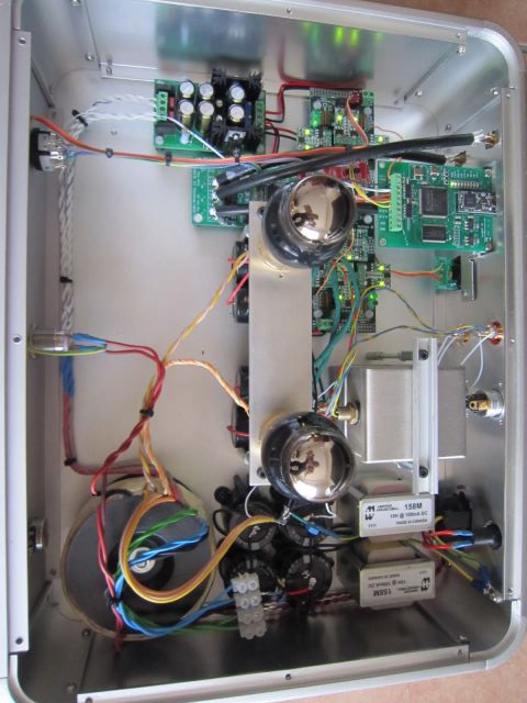

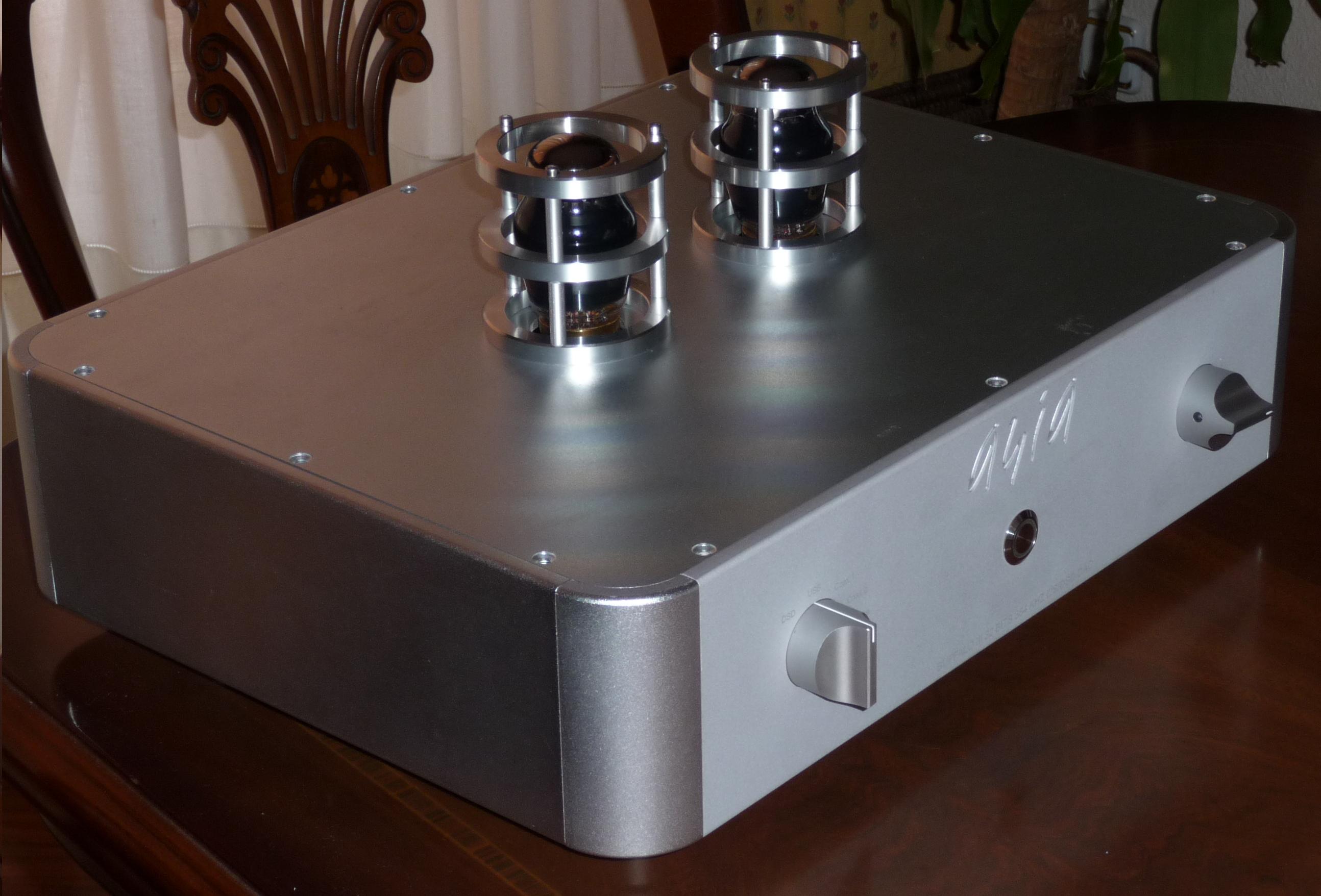

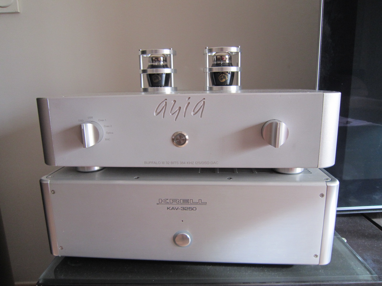

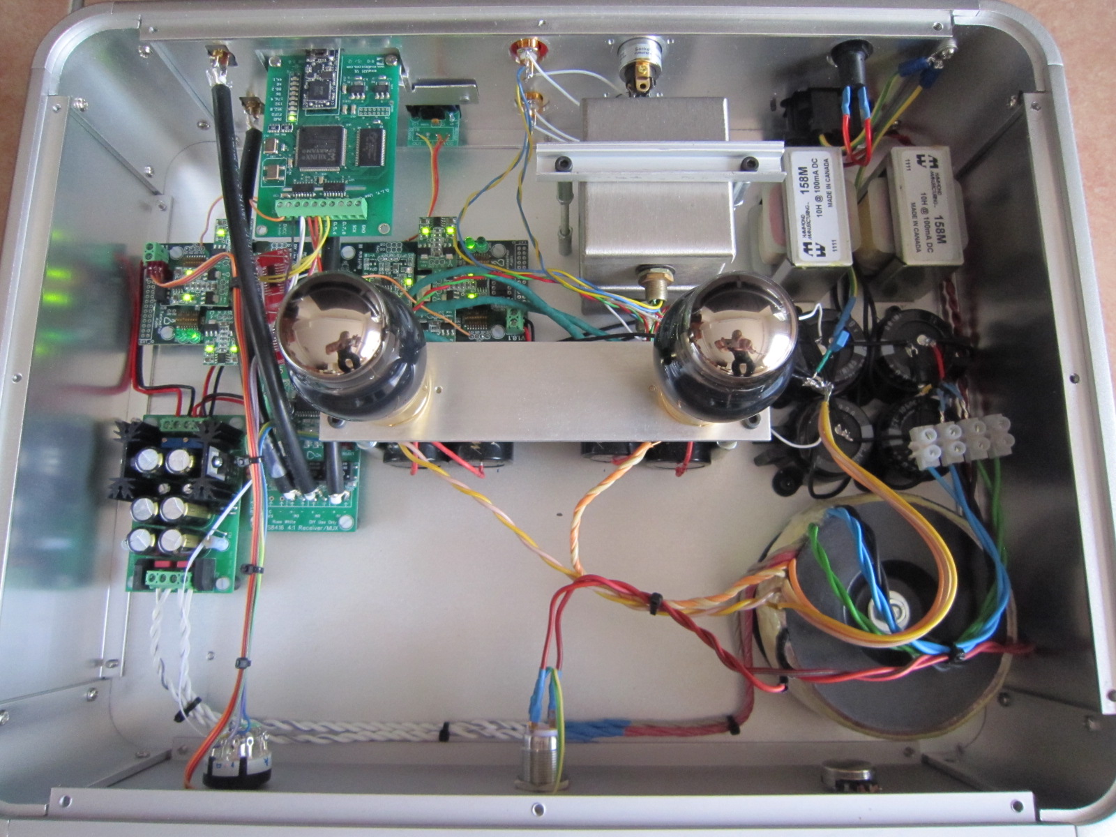

I present the project AYIA (in tribute to his "perpetrator", Smanz in Diyaudio forum)i. I have not made ​​myself, just so enjoy it.
It is a dual mono dac cv181 tube.
Princiales components are:
- 2 Reference 9018 Sabre DACs (Twisted Pear Audio)
- USB EXAU2I
- Analog output with Psavane cv181 tubes, capacitors Mundorf MCAP gold silver oil, transformer Sowter
- Inputs 1 USB (exau2i), 2 Digital coaxial (75 Ohm WBT), 1 Toslink, 1 BNC.
- Outputs RCA analog outputs (WBT) Balanced (Furutech)
The sound is realistic, three-dimensional (in untreated room) and detailed. I've never heard anything like it, and is still running.
The output selector allows dsd for exadevices dsd player.
People who have heard talk sound much better than more expensive commercial dacs (and is not cheap)
Is everything perfect, I just need to get exadevices Audirvana direct mode 🙂
Some pictures:

Great project, Jorge. Congratulations!
I will email Damien from Audirvana one more time. I need his help for enabling direct mode. Here are the pictures from your post, embedded here for easy viewing.

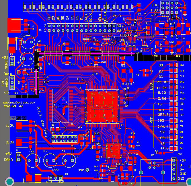

Here is again an updated list of features for the next generation exaU2I:
  • Just about 1ps jitter
  • Two sets of clocks for synchronous and asynchronous operation with ES9018
  • 8 channel DSD
  • 8 channel DXD / 384 kHz PCM
  • Individual LEDs for all PCM and DSD sampling rates
  • Easy elimination of USB power
  • Macro USB connector
  • Header for connecting external USB connector
  • Connectors for external power sources
  • New ground isolation technology
  • Micro BNC output connectors
  • Elimination of the USB daughter board
  • No need to rewire the outputs for DSD and PCM (ES9018 only)
  • I2C header for ES9018 volume control - if we can make it.
  • Multichannel support for PCM1704. This option will rewire alternative firmware, and it may be a separate product.
Attached is an early version of the PCB. Please post to this thread if you think you are interested to buy one. Indicate your preferences:
  • ES9018, PCM1704 or a third party DAC.
  • Let us know your priorities - all in one board or multiple specialized products for lower cost
  • Asynchronous operation (only two clocks) or all clocks installed.
  • Two channel only, PCM only etc.
