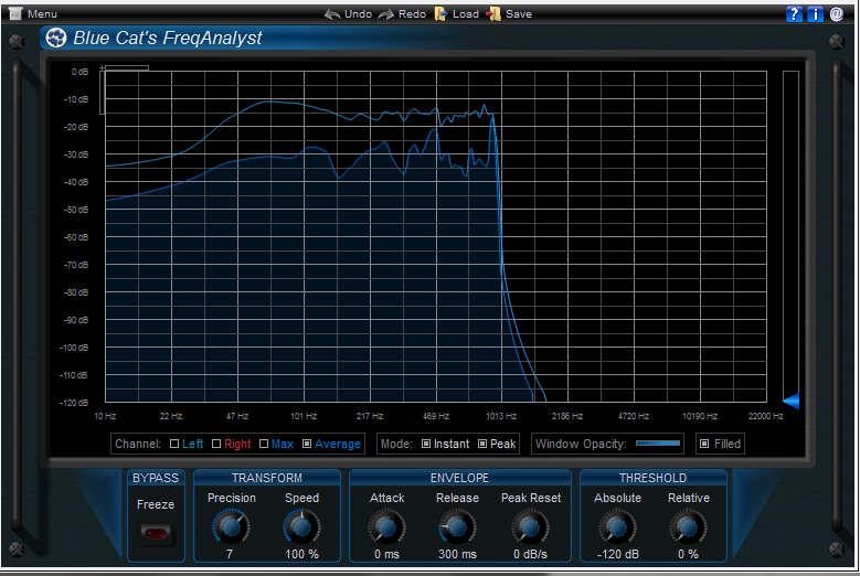

Hi exa065
Now I'm listening 2 way VST straight FIR channel divider, with..
foobar2000(ASIO) - (Reaper + 2 VST_FIR) - exaU2I.
This solution is very simple. great. 🙂
(but there is performance overhead for Reaper)
Screenshot: shows very sharp Low pass filter.
Source code: small enough, this is VST source code which has VST interface, FIR coefficient generator, and CUDA FIR logic.
(requires VST SDK and CUDA SDK to build)
The reason why I am sticking with Straight FIR (not FFT FIR) is, FFT FIR requires Hunning Window processing on input signal.

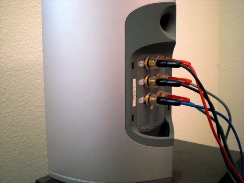

Hello KOON3876,
Can you tell us more about your system? What kind of speakers do you use? Have you tried any high-resolution multichannel sources?
Hi Now I am using LINN Komponent 104.
(before I had also LINN Akurate 212)
This is 3Way speaker, Crossover can be bypassed.
Stereo Source, foobar etc -> Reaper+straight FIR channel divider -> exaU2I -> this amplifier (up to 4Way) -> Stereo speaker, multi-amplifier configuration.
So I am using exaU2I not for multichannel, but for Multi-way stereo configuration.
That's an interresting configuration. Never seen an amp like that before. Is it a diy project, or is it store bought?
There is no amp in that picture. That is the input connector panel for a 3-way speaker. Linn has been making products for thirty years, sold in audiophile shops. They're quite keen on biamping and triamping speakers, so it is not too hard to disable or segregate the crossover to access individual speaker drivers within the same cabinet.
Linn - Music Systems - Komponent
I would be very interested to learn what filters, and slopes are most effective for the Komponent 104. Does the owner's manual mention frequencies, or do they consider it all proprietary?
I was of course referring to the 8 channel digital amp in this post: Post #786
Interresting piece of gear
Owner's manual does not show the filter detail, but crossover frequency = 1kHz and 3.5kHz.
I used IIR 24dB/Oct filter before, Now using FIR (200dB/Oct or so).
