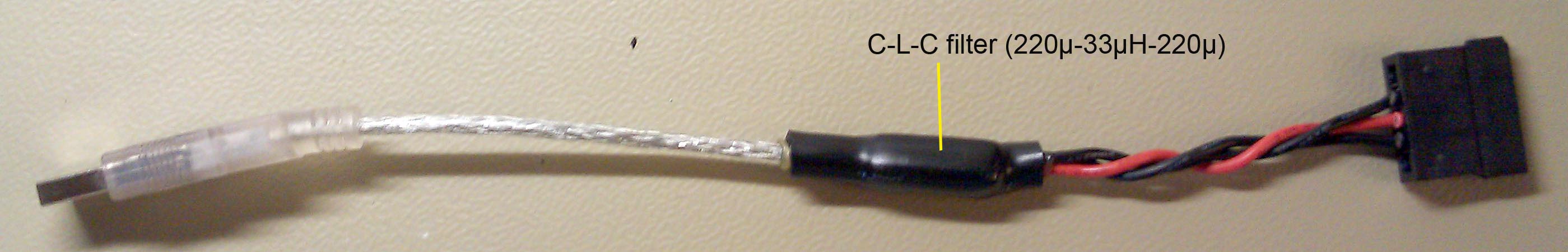

Best solution in this case is to have music files on an SATA HD (eSATA). Best of all is to use an SSD on eSATA. Then you can use from USB port only +5v to power the eSATA (SSD) HD. An CLC filter on that 5v power line from USB port is also recommended...

What would be the advantage of using a second cable to supply power from usb to an external eSATA-HD? The eSATA cable already supplies the required power. If supply filtering improves SQ, this could be done in the eSATA cable or (much better) in the external eSATA case.Best solution in this case is to have music files on an SATA HD (eSATA). Best of all is to use an SSD on eSATA. Then you can use from USB port only +5v to power the eSATA (SSD) HD. An CLC filter on that 5v power line from USB port is also recommended...

I personally use an ordinary SSD as external HD, and I have a SATA cable which is normal on one end and eSATA connector in anther end. I use an eSATA port to connect this standard SSD to. So, is not any power for the HD in this set up. That because I have to use an USB port to power my SSD HD.
Referring to your question, there is no any advantage to use another power supply if one use exclusively eSATA interface on eSATA device. But I would want to have that filter anyway on power rail.
On the player I have there is an difference between using USB as HD interface and using an existing eSATA port for HD with the music files. In my case it sound better with HD on the SATA. Else, if is about a PC-media machine with exaU2I on USB I think is better to have the files on internal SATA. If one use an external/mobile HD to a dedicated media PC or player, then is an advantage to have one external HD, which can be connected where is need it for playing/update the files.
The only problem I can see is when data transfer ocure on USB interface (using USB HD), and in the same time, the same type interface in a PC is used for drive exaU2I. I would prefer to have a different interface involved in reading files/data than I will use for output with exaU2I.
Sorry, you are of course right. The eSATA cable has balance transmission for send and receive, but power to the external drive is provided from a small power supply from the mains. You could possibly put additional filtering there or replace it with a linear supply to test if this affects SQ.eSATA port is not provide power for external device
