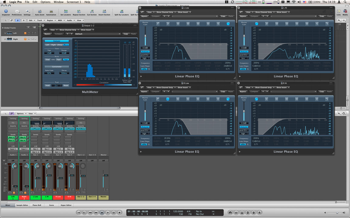

If you want to emulate a passive analog crossover made with capacitors and inductors, then Apple provides low-pass and high-pass AudioUnits for free - with the operating system. You just need an application that can host them.
Thank you Rsdio for the advice. I did almost the same, but through the Logic. I was planning to share it here, so here is the opportunity. Hopefully someone could use it, just like I learned from you and RayCtech
My situation, and believe anyone else's doing active on Mac is that although there is an exceptional application - Pure Music that hosts its own crossover, it doesn't cover everything. In another word, I could play my files from the hard disc, but I cannot simply slip CD into and play, or I cannot play streaming radio stations. Now, for the highest fidelity I could do no better than PM. Plays from memory, plays easily FLAC files, uses iPad to control, and uses iTunes for file management. Awesome, but sometimes I just want to stream my favorite Absolute radio station... or pop fast CD. So what than if my crossover is hosted by Pure Music?
I used Jack for rerouting to Logic that is hosting my plug ins. From Logic I go out to whatever my output is, for now RME card, soon replaced with I2S to USB card. I tried very popular SoundFlower, but that did not work for me. Instead when I tried Jack it work flawlessly, and it comes with good documentation.
Logic is an awesome app, and plug ins that comes with it are really good. As far as I am aware, there are no crossover plug ins for Mac, but as you suggested using low shelf, high shelf or bandass filters do a perfect job. As you could see, I was able to control the angle of the curve in dB just like with any crossover, and filters used are linear phase. The amount of additional filters that could be used if desired, such as room correction or similar is limited just by memory and processing power.
This way my crossover is independent of the music playing apps, and I could combine various players for various needs. In my listening tests I did not hear any difference comparing to regular crossover (the one implemented in Pure Music). I am happy camper so far.
The shelving filters are not appropriate for crossover use, but I see that in Logic you are actually using the high-pass and low-pass that are appropriate.

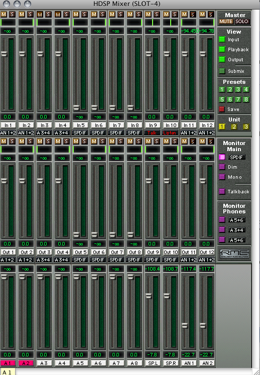

hang on AR2, which rme have you got? depending which, you can use totalmix to route an output back to the input without wires and access the audio that way without needing jack at all. just control click the channel strip of the output (see below) that has the data you want playing so that it turns red, then in logic you set the outputs of your crossover to the channels after that. you lose 2 channels, but you dont need to use another application. then as you are probably doing, you hit record and pause to process any audio playing through the plugins and assign your channels. make sense? the output from the bounce will be seen at the corresponding inputs, so to monitor a bounce from channels 1 and 2 as here, from memory they will be available on input channels 1 and 2. if thats wrong just play till you get them, or send me a pm and i'll double check, its been a while since i have used it in this way.
Quisp, thank you for the treasure of info you posted here. really cool stuff.
Many questions, but here are some answers. Until just recently I was using Fireface 800, but I gave it to my son. Now I use Fireface 400. Your advice on rerouting RME is really cool, but my intention is not to use RME interface but instead USB - I2S converter. I am not sure I could use both at the same time? If that is not the case than you solution is certainly way to go. Wave - I have a full collection, quite honestly there are way to many plug ins there, haha I get lost there finding what I need. I wanted to use native Logic plug ins to simplify life, but certainly I will try wave as well. I might have a few :headbash:questions, but I will send it to you directly, in order not to pollute this thread, you are correct on that one.
