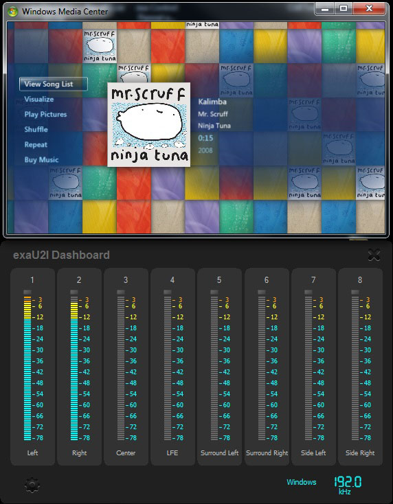

I am pleased to announce that exaU2I now works with native Windows players like Windows Media Center, VLC, and MPC-HC. Support for native playback is achieved by using a third-party WDM driver - the Virtual Audio Cable (VAC) from NTONYX.
The Beta version of the new software - exaU2I Dashboard is available for download to registered exaU2I owners on our support website. Detailed installation instructions and screenshots are posted on the exaDevices Blog.

That's great news. How do you handle volume control? If you adjust the volume with the app (WMC, VLC, MPC-HC, etc.) does it adjust all channels simultaneously? Can you also adjust each channel individually?

When using the Windows native driver you have the choice to enable the Windows volume control. It will adjust all channels just like any soundcard. You can use the Balance control under Levels in the Control Panel to adjust individual channels.That's great news. How do you handle volume control? If you adjust the volume with the app (WMC, VLC, MPC-HC, etc.) does it adjust all channels simultaneously? Can you also adjust each channel individually?
Yes, you can do anything at the player and it will work like with a normal soundcard.With MPC-HC, you can configure it to use specific audio decoders and filters, like ffdshow and other DirecShow splitters/decoders. Some of these decoders have a GUI that provide features like bass management. Do these still work with Virtual Audio Cable?
When using the Windows sound system under Windows 7 you don't have automatic sampling rate switching the way you do with ASIO. You have several choices:After reading the adjusting sampling rate section of your installation and configuration guide, I noticed you recommend setting the sampling rate for watching movies to 48KHz. Is that just to match the sampling rate of DVDs? What about Blu-rays, which might have a sampling rate of 96KHz or 192KHz? I've ripped my Blu-rays to MKV and converted the audio to FLAC and kept the audio at the original bit depth/sampling rate of 24/48, 24/96 or 24/192. Will I need to remember the sampling rate and adjust accordingly before playing any blu-ray movie?
- You can have VAC and exaU2I Dashboard set to 192 kHz. All sources will be up-sampled by Windows
- You can set VAC and exaU2I Dashboard configured for the sampling rate that is most-important for you in terms of quality. All sources with different sample rates will be re-sampled
- You can keep changing the configuration manually
- You can use ASIO for fine listening and VAC for movies 🙂

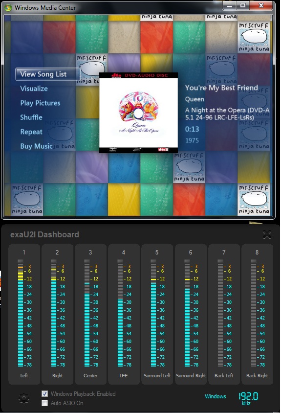

Is it now possible to enable 5.1 / 7.1 for movies in windows mediacenter?
It will take time to try all media formats in all players. So far I've tested 5.1 WMA audio both in Windows Media Center and Windows Media Player 12 running on Windows 7 64 bit. I've also tested MKV video with 5.1 sound with VLC.

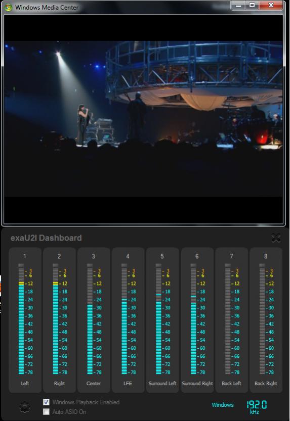

So far I've managed to test exaU2I / VAC with the following players:
- Windows Media Center on 64bit Windows 7 - 2.0, 5.1 DVD, 2.0, 5.1, 7.1 audio (WMA, WAV)
- Windows Media Player 12 on 64bit Windows 7 - 2.0, 5.1 DVD, 2.0, 5.1, 7.1 audio
- MPC-HC x86 on 64bit Windows 7 - 2.0, 5.1 DVD, 2.0, 5.1, 7.1 audio, 2.0, 5.1, 7.1 MKV (AC3, DTS, FLAC)
- VLC on 64bit Windows 7 - 2.0, 5.1 DVD, 2.0, 5.1, audio, 2,0, 5.1 MKV (AC3, DTS, FLAC)
- Cyberlink PowerDVD 11 Trial - Bluray - Mono (Center Channel 🙂)
So far, the player that can do all formats is MPC-HC x86, VLC is lacking 7.1 support. MCE is doing great if you can limit yourself to Microsoft media file formats.
