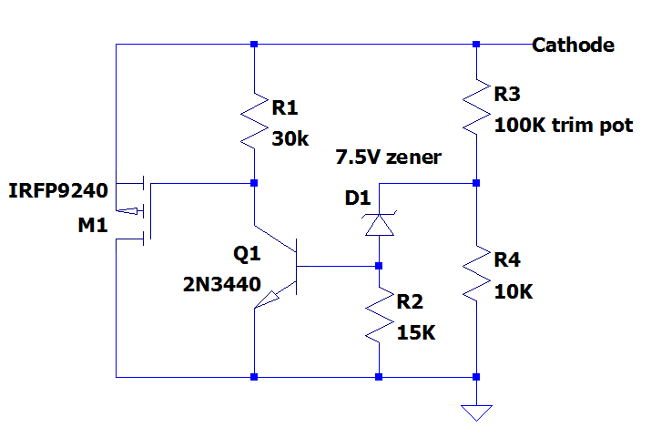

Hi there,
I came up with the idea using the IRFP9240 P-channel MOSFET as adjustable Shunt Regulator for my 300B SE amp. I came up with a prototype circuit and built it with a small PCB.
With use of LT Spice simulation, the minimum holding current required is only 1mA. I just need to use a 200K resistor connects to B+ and cathode to provide this holding current.
Bypass capacitor is not required.
After live testing for 2 days, I found how much I have missed from this 300B amp for years using RC self bias. The sound is incredible clean with details that I never heard of.
For details and schematic, please check my Facebook Group "vancouverdiyaudio".
Great to be a DIYer.
Johnny

Hi 6A3sUMMER,
Yes, you have mis-understood my words. The circuit is not CCS. I thought about using variable CCS as cathode circuit for the 300B. It can be done but the CCS has very high AC impedance. The circuit would require a Bypass capacitor to provide the AC signal path for the 300B.
With use of shunt regulator, the AC impedance is close to Zero and no phase shift issue. No bypass capacitor is required is the very best thing.
I am still searching for IC which can stand 150Vdc with very minimal hold current which would be very nice.
Johnny

kmtang,
For discussion clarity: I will use the words 'plate current' to mean the filament 'cathode current'.
They are exactly the same until you have grid current (Class A2).
For Newbies, I do not mean the current to heat the filament (1.25 Amps).
Regarding your circuit in Post # 24. If it causes the voltage across its terminals to be constant, even when the 300B plate current varies from minimum to maximum versus the music signal (or versus a test tone), then true, you do not need a bypass cap across that circuit.
In that case, the 300B bias will not vary.
But if the voltage across your circuit varies versus plate current, you Do require a bypass cap.

Hi6A3sUMMER,
Thanks for your clarifications.
First of all, with the LTspice simulation and live test of the 300B amp with sine wave and music, both shows the cathode voltage is being hold constant. I added a 200K resistor between the B+ and 300B cathode in order to feed to the shunt regulator circuit in order to maintain the regulated voltage when the 300B being turned off to 0mA when it is driven to the extreme. I am rather confident that NO bypass capacitor is required for the circuit.
When the 300B is driven to maximum which will cause the grid current to flow. This will affect the bias of the 300B no matter it is with RC self bias or shunt regulator. Of course, the RC self bias would have less effect in such scenario. I am using Tannoy Edinburg speakers which has 95dB efficiency. I don't need full power from the 300B amp. Therefore, this is not an issue to me.
Anyway, the Shunt Regulator circuit is so wonderful that I enjoy the music from the 300B amp so much. Of course, the Fix Bias arrangement may have the same performance. However, it is rather difficult to modify the SE amp with self bias to fix bias. Shunt Regulator seems the easiest way to do.

Sorry, I don't understand how it works well.
If the 300B produces more current (for example indefinite grid voltage, damaged grid leak resistor etc. ), the voltage on cathode resistor will growing.
The shunt tries to adjust it, the shunt FET start to conducting to stabilize voltage on cathode resistor.
If the growing of anode current of tube continues, the FET conducting more, stabilizing the voltage on cathode resistor, but current of tube continues to grow, because of current via cathode resistor AND current of FET flows through the tube.
The voltage on cathode resistor potentially constant, but dissipation of tube can growing even up to melting.

Congratulations!
You are correct.
Now, for a few Generalizations that may prove helpful:
For this discussion, when I say 300B "cathode", I mean the mid voltage of the filament (filament with Either 5Vrms AC; Or 5VDC).
Un-protected circuits, versus 300B plate dissipation, in regards to certain types of circuit and tube failure modes:
1. Shunt constant voltage "cathode" bias
2. Zener "cathode" bias
3. Constant voltage fixed bias to the grid
Some kinds of circuit failures, and tube thermal run-away are not protected in these circuit topologies.
Protected 300B plate dissipation circuits:
1. Self Bias ("cathode" resistor to ground with a bypass capacitor across the resistor).
Some kinds of circuit failures, and mis-calculated circuits are not protected. (Example use a 50V rated bypass cap when the 300B tube you have runs at 65V bias everyday (watch out for the electrolytic to dry out, or watch out for excess capacitor leakage current, or even to become a short).

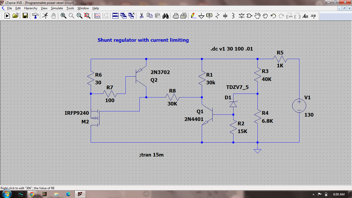

I experimented using the AZ431L shunt regulator IC in my 6SN7 line amp. Too bad that it causes so much pink noise which is totally unacceptable. However, the quality of the sound was so nice that made me to search for a better low noise shunt regulator.
I used the LTspice to work out a two transistor shunt regulator circuit. The dynamic impedance is approximately 8 ohm which should be good enough for amplification and driver stages.
I had this installed in the 6SN7 line amp. Wow..... noise level is low. The sound is so dynamic, detailed, and open.
I love shunt regulators!
Hi Jaclvarez,
Well, the circuit diagram is just for trial with the LTspice simulation. It is not specific for 300B or other tubes yet. It will be my project later on.
By the way, my buddy said having the shunt regulator for the SE amp sounds like between fixed and self bias one. Wondering if you have experience in SE amps with fixed bias???
