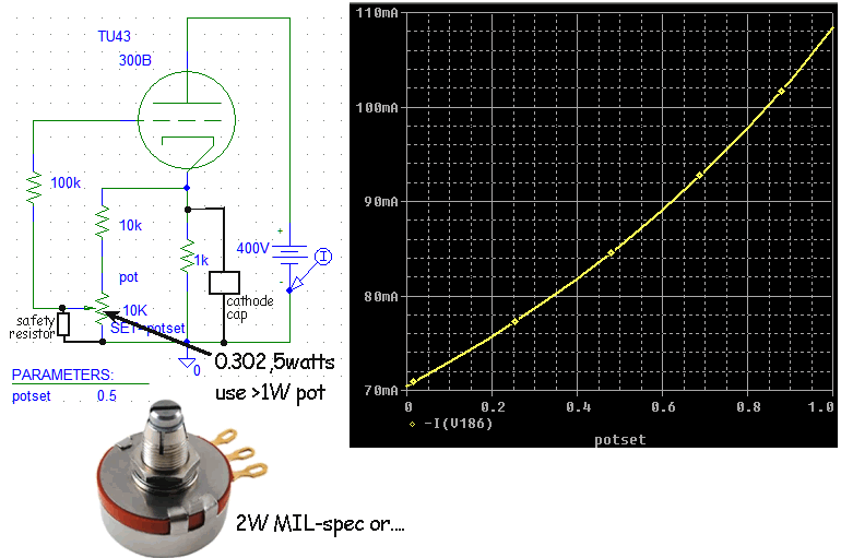

Unfortunately I don't. My only SE prototype amp used self-bias, the usual resistor + cap cathode to ground.By the way, my buddy said having the shunt regulator for the SE amp sounds like between fixed and self bias one. Wondering if you have experience in SE amps with fixed bias???
My push-pull amp does use fixed bias. It sounds great, but again I have nothing else to compare it, well, other than my Onkyo SS amp.
