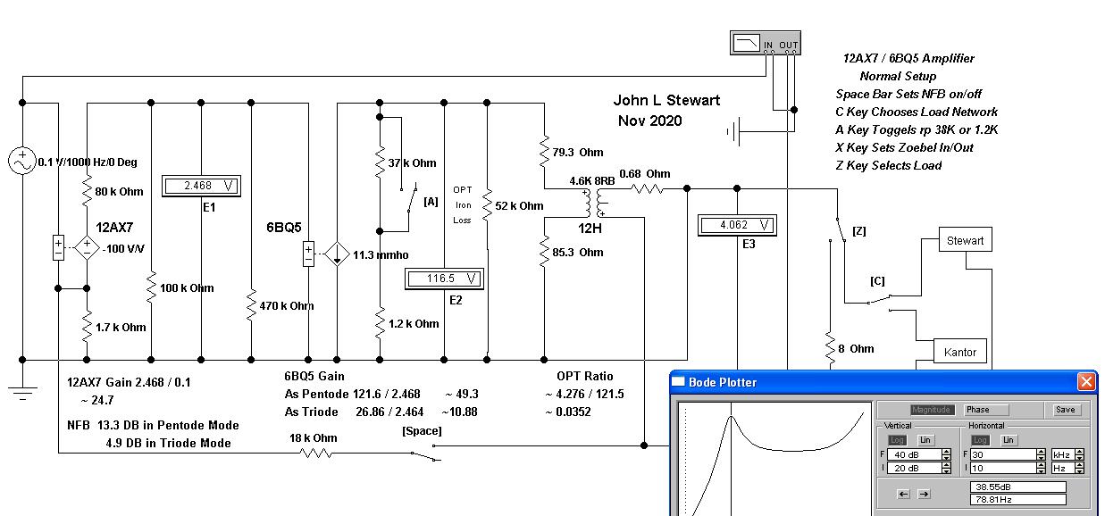

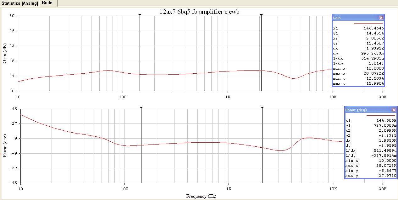

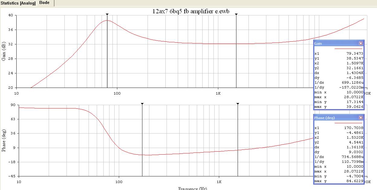

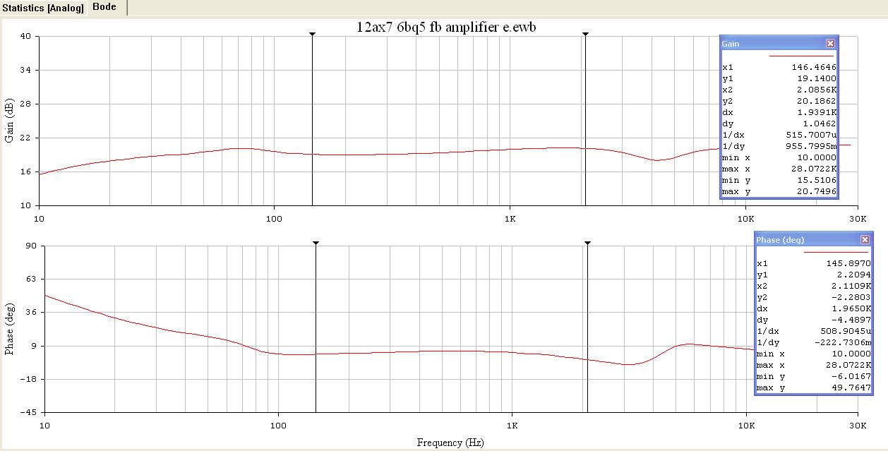

The OPT in the simulation has been corrected so that the results now make sense. I've used sub circuits in the schematic to save space, otherwise they are the same as used previously. So three different conditions, first a normal 8R resister load to establish a base line. Then the two speaker simulator loads for comparison. I've included an example of how a sub circuit appears when called up in the display.
In this case the OPT primary inductance would be typical of a low cost SE amp. As it turns out, increasing the inductance of the OPT increases the height of the LF bump. The 12H choke is already down 3 db at 61 Hz, just below the LF resonance of the test loads.😱
I appreciate Mondogenerator's carefully considered response above. And refer him to post #1, this thread covers amplifier testing, not loudspeakers. Starting a separate thread on loudspeakers would make more sense than here.🙂

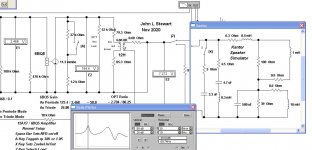

  • 12AX7 6BQ5 FB Amplifier Schematic with Kantor Load Sub Circuit in Pentode Mode.JPG

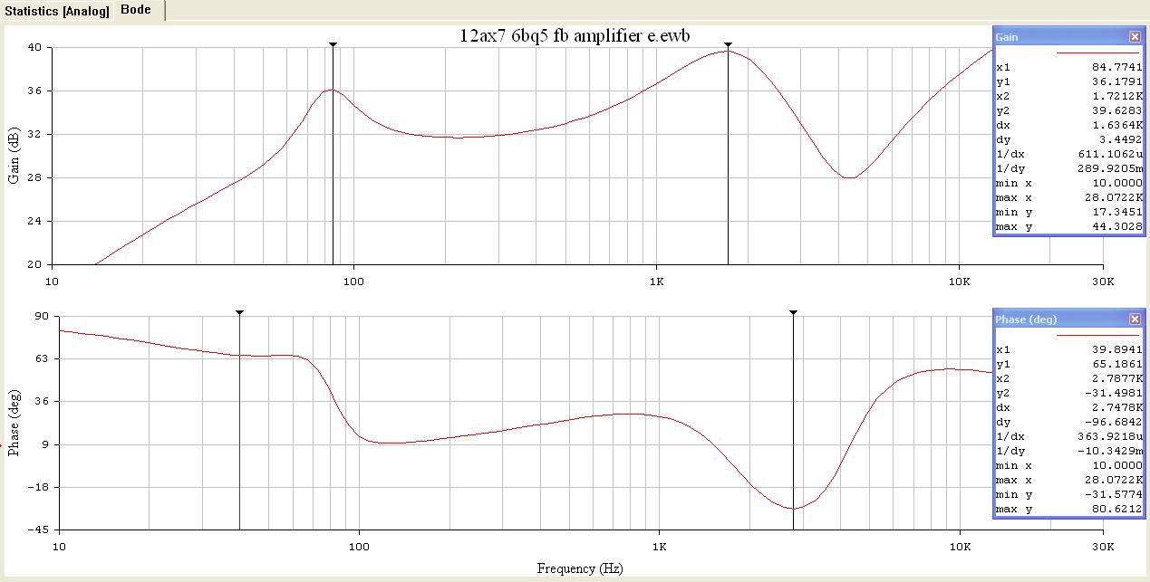

Here are some Phase & Gain Results driving into the Kantor Network via the triode connexion with & without limited (4.9 db) NFB. The pentode as well with 13 db NFB so a comparison is possible to the previous results without NFB.
I found the LF 3db down for the triode was at 16 Hz in previous tests, compared to the much higher rolloff of the pentode connexion.
All looks stable as it usually is running simple FB pairs, whether triode or pentode connected. I've run 20 db NFB with pentode NFB often with no problems at all, even while using the peanut size OPT in AC/DC receivers. Think 6SQ7/50L6.😀
Try adding in some OPT Leakage Inductance next.🙂
