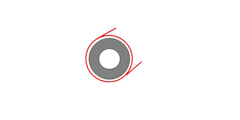

The leakage comes from imperfections, for example when you wind the turns in a way that it goes around along the core, then you make a single turn choke in excess the toroid. Not equal distances are the other source of leakage.
Even if a toroidal coil is wound perfectly it still has one single loop that is causing a stray field. And this is unavidable. Don't forget about that !
Regards
Charles
I didn't forget, I wrote about it! (Maybe I wasn't totally clear.) But actually it is avoidable! With two layers. Or it can be minimized with only one layer, if you split the coil into two symmetric halves, then connect them paralell (very small values) or series (higher values). You can decrease it further, use your imagination!

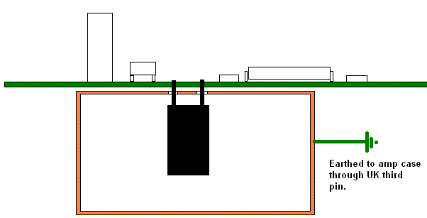

if you can't contain it shield it?
I thought the same thing and started placing them under the PCB into one of those small shielded boxes you can get and earthing it to the case... which is in turn earthed to the UK third pin.... no idea if it makes any difference but I feel better for doing it 😀

Another simple way to eliminate the flux leakage caused by the loop: before winding the coil make a loop in the other direction!

You're still under the misconception that you can eliminate the flux leakage entirely. Let me assure you cannot. And while that may not make a difference in low frequency applications, it certainly does in high frequency ones like this.

No, obviously I haven't said (or thought) this. Please try to understand what I wrote! Simply denying is pointless.
Regards
Charles
It is not uncommon to have a single anti-turn on the PCB that cancels the single loop formed by the toroid. It's not perfect, but it can be quite effective. for a core who's axis is parallel to the PCB, this can be accomplished with a loop of wire, or for better cancellation, two parallel loops on either side of the toroid.
