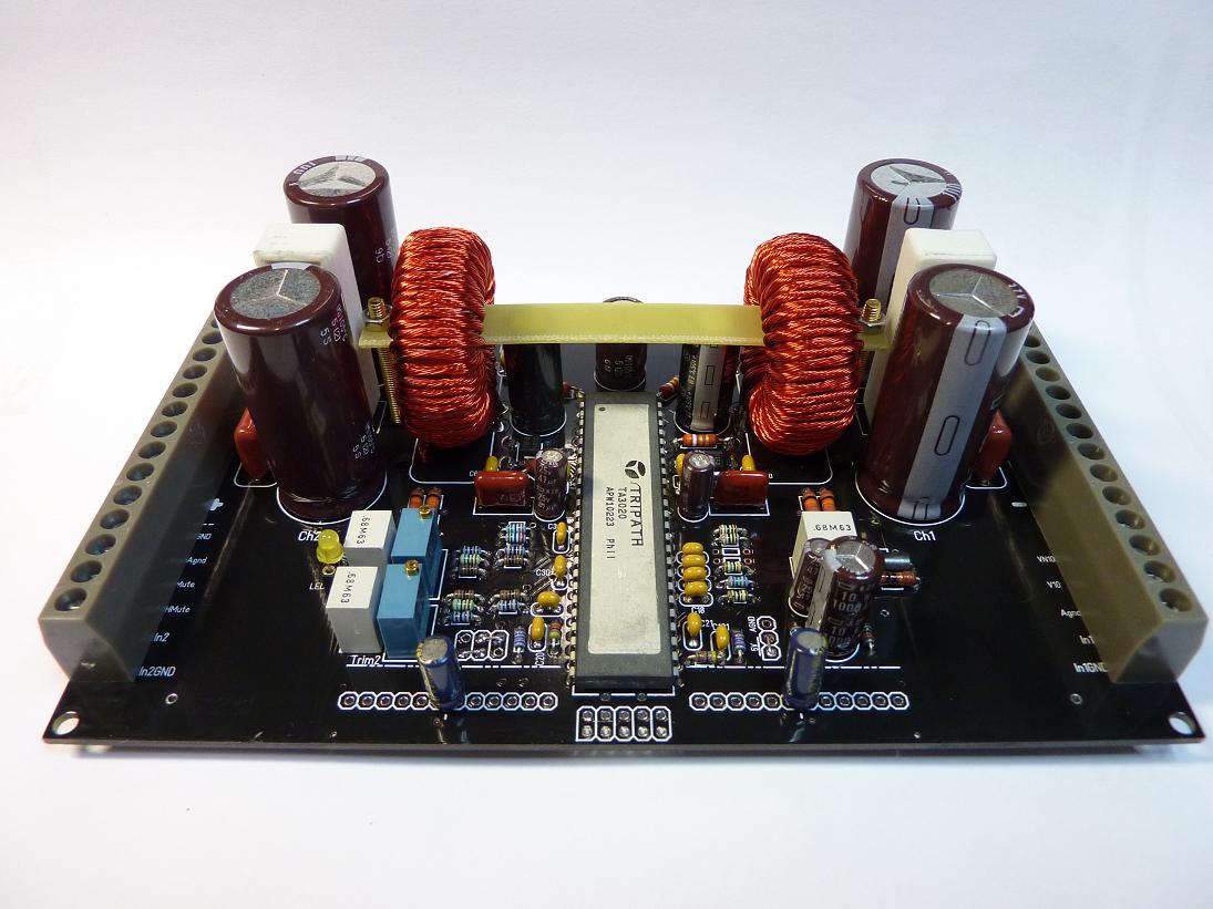

The toroid air cores do exhibit much better containment than the cylinders but still leak a little more than the T106-2 cores. Even the type 2 cores are not as silent as you might think. Are they leaking from the leads? The original little smd shielded bobbins were dead silent. Anyone care to try their amp and report back? Maybe all of our hand wound cores leak a little. I am listening with an AM radio tuned between stations to the switching frequency. Turn your amp on and off and listen to the difference.

Try some air toroids out of more reasonably sized wire and pop them into a set of hacked off pipe caps and solder them together.
No iron distortion.
No radiation.
It looks like you're off the deep end of milliohms with that wire.
Edit: You're never going to get a leak-free toroid because the windings are not perfectly uniform and everywhere.
Edit2: What is the RDSon of the output transistors?
Air core Class D inductors??
I think air core inductors are going in the wrong direction. You want a very low DC resistance for these inductors. One way to achieve that is to use large diameter wire. Next, use a core that produces the desired inductance with as few turns as possible. Now, pick a magnetic material and mechanical configuration that allows you to create the inductor you desire without causing saturation of the magnetic material at the level of DC/AC (audio) current that it will see. Plus the core should confine the magnetic field such that radiated energy is tolerable. If the inductance collapses because of magnetic saturation, the filter no longer works as designed.
Air core inductors use too much wire. The DC resistance is higher than necessary. This will cause a lower damping factor on the output of the amplifier. The bass will be less controlled (dare I say "flabby" or "less tight"??) than it could be with a higher damping factor. Yes, people listen to AM, which is why you need to keep the stray magnetic fields under control. Air cores just radiate too much, unless you completely shield them magnetically.

I have three identical amp boards. One with the 20ga. type 2 toroids and one with the 20ga. cylindrical air cores and the air cores sound much more transparent even though I can't use them because of EMI. The big 14ga. air core toroids destroy the sonics of either one and have emissions on par with the type 2. It's not just me. The forums are full of class D people who have listened various (and unknowingly noisy) air cores and I have yet to read a single post where they preferred the type 2 core which is otherwise the de facto. Too bad the forum search doesn't consider "air" to be an important enough word to find as it would be easier to read about.

The Wurth coils are the best coils I tried so far for my system with the Shure 2x100 amps.
They are better than 10uH air cores that I took out of my Charlize and
many others that I bought and wound.
For the price you should at least try them in your system.
They do equally well with my full Horn-system, KRK monitors or Fonken.

How to install a Wurth coils on a board that uses the toroids?
The Wurths XXL are SMD while the toroids are soldered "through-board".
Is it possible to install the Wurth coils raised up a little with rheophores?
Any drawbacks of this solution?
Thanks, bye!

Once a board is installed in a metal case, isn't that shielded? So the emi pollutions shouldn't be anymore a problem. What do you think about?

Yes the Wurth XXL coils are my favorite as the sonics are very close to an air core with some advantages of much smaller size and less EMI. Much better sound than the undersized type 2 cores that everyone uses. More loss than the air cores though so battery users will find less run time. Just add some solid core wires to the Wurth coils and fit them down to the board as best as possible.
