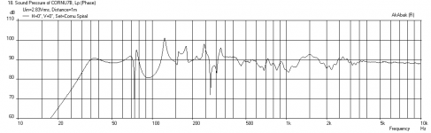

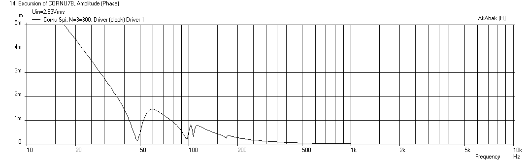

Here are the sims for the A10.3 with some stuffing in the channels from the driver chamber to the bifurcation. If you amp is capable of driving freq lower than 40 Hz you may want to be careful with either high pass or limit power as excursion is runaway at lower frequencies. Looks pretty decent though as Cornu goes and the A10.3 has some enhanced HF's that will help to balance out the bass. Keep in mind that the Alpairs have very thin metal cones that are susceptible to back wave reflection coloring the sound. You may want a conical sound deflector behind the driver magnet like in the Cornu patent to prevent this. Can be made of of a rolled up piece of foam core made to look like a conical funnel or "dunce hat".

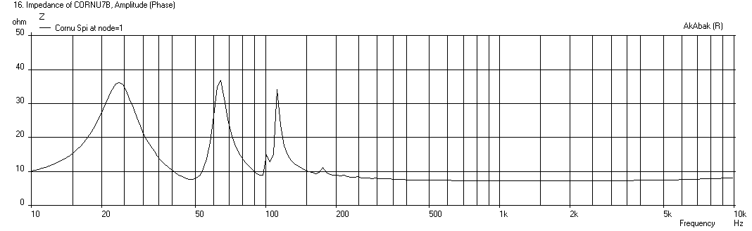

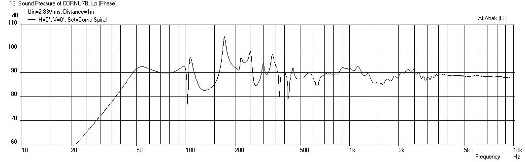

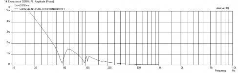

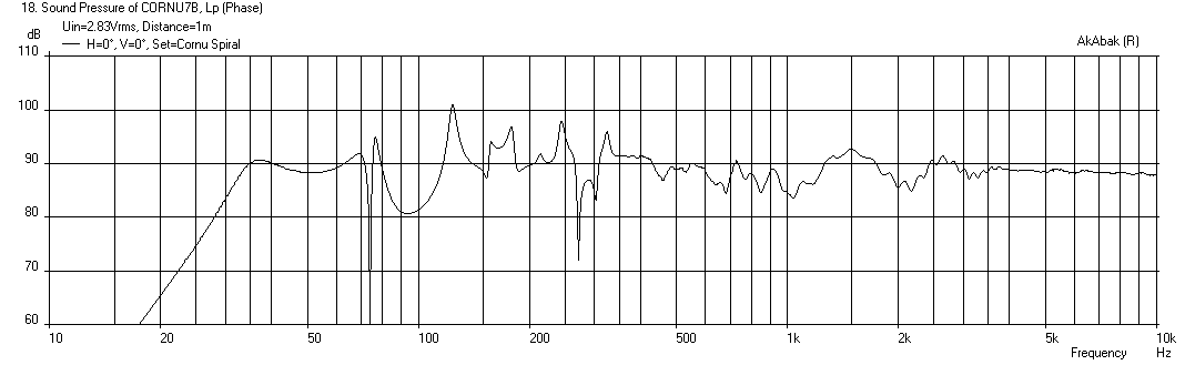

The FE206E will require a 50 inch x 5 inch deep Cornu in order for the driver to fit in the chamber. It will have bass extension to 32 Hz (-3dB) and about 90dB sensitivity. Go for it if you have the wall space! :D
Here is the predicted frequency response:
430665d1406718818-ever-think-building-cornu-spiral-horn-now-you-can-cornu7b-fe206e-freq-1m.png

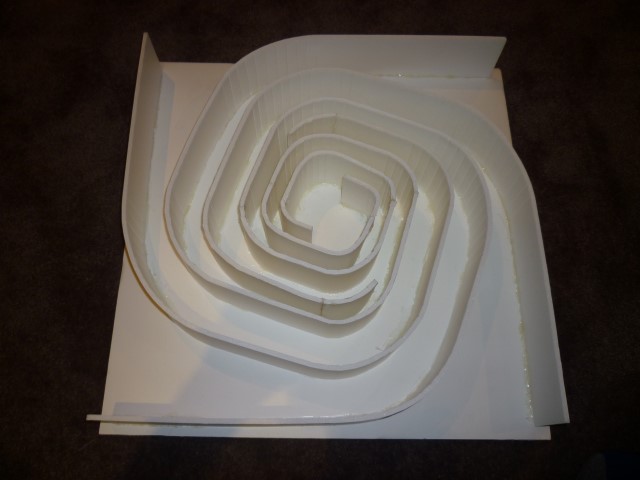

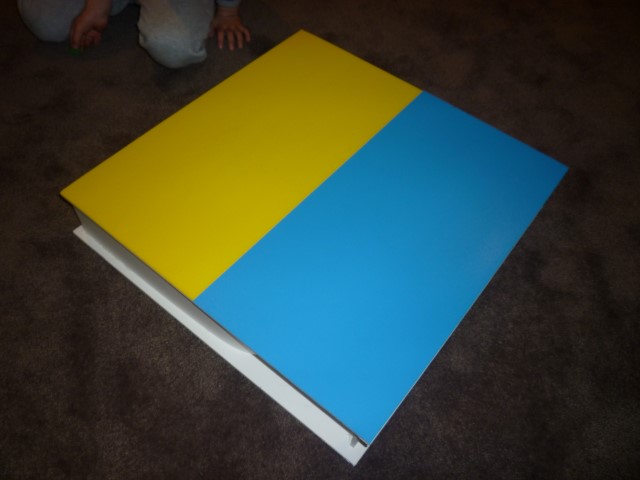

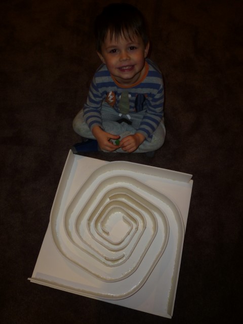

Hi all,
Thanks to X for helping me get started with building foam core speakers. I'm putting together a set of 50x50cm Cornus with a channel depth of 7.5cm, using the Vifa TC9FDs.
Foam core board not as affordable here in Oz (almost $10 a sheet), but all in all it's still worthwhile considering what you can produce with it.
I'm hopefully close to completing the first one. The spirals are all glued up, and soon I'll be mounting the binding posts, attaching the driver, and adding the stuffing.
My son is eagerly awaiting completion as the Cornus will find their permanent home in his play room. He's been asking me when he'll be able to listen and dance to some Cat Stevens songs!!!
SWMBO is actually interested in the project too. Being Ukrainian, I've managed to get the big nod of approval after she saw the blue & yellow coloured foam, which I plan to use for the baffle (baffle will be double thickness, since the coloured pieces will be glued to the standard white board).
Anyway, will post some more photos as I progress.
Thanks to X, Cal and the rest of the crowd for sharing such a fun project.
Pete
