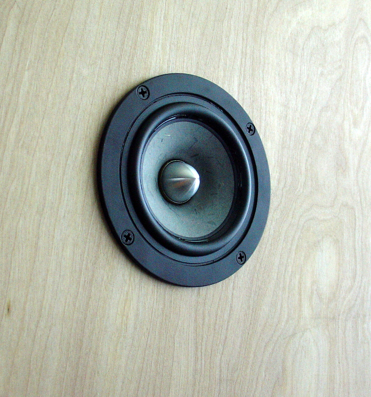

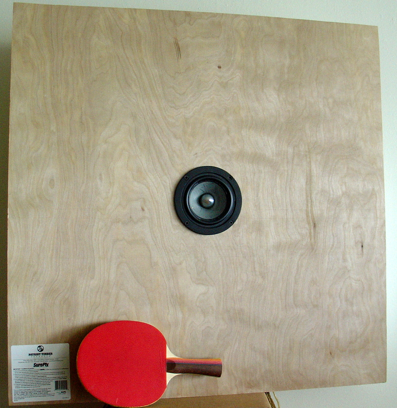

I'm not sure if I reported, but I finished my thin plywood 4in bamboo drivers cornus a while ago, and have been just listening to them. I like them!
I mean they're finished functionally, but not yet done with the looks. Big dilemma, leave them natural wood finish, cover them with fabric...
Cool. What dimensions did you end up going with? Photos?
