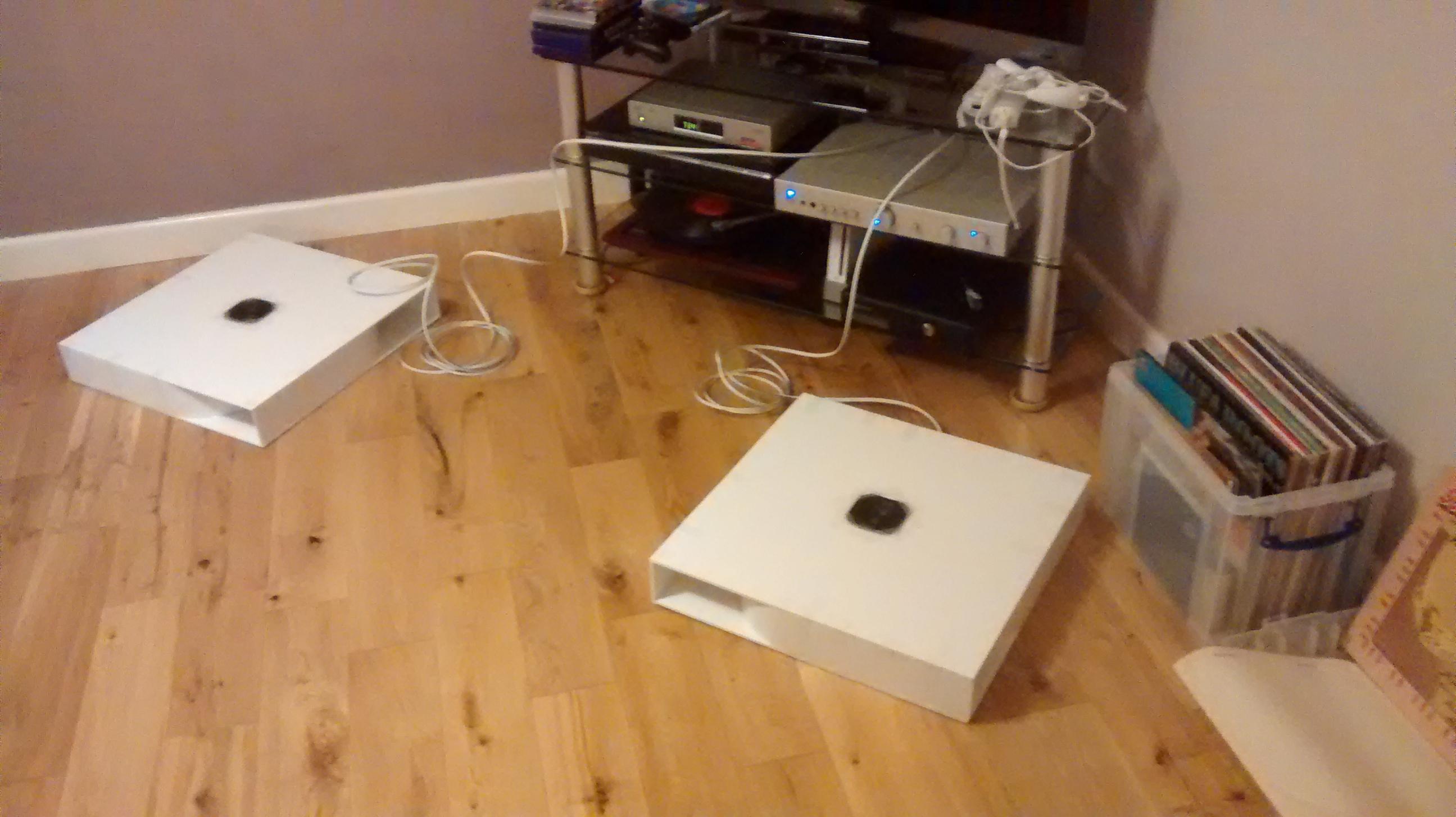

Hi fellow Cornu makers 🙂 Had to take mine down for the moment because we're doing some `redecorating` So i was thinking this might be an excellent time to start on that second pair.

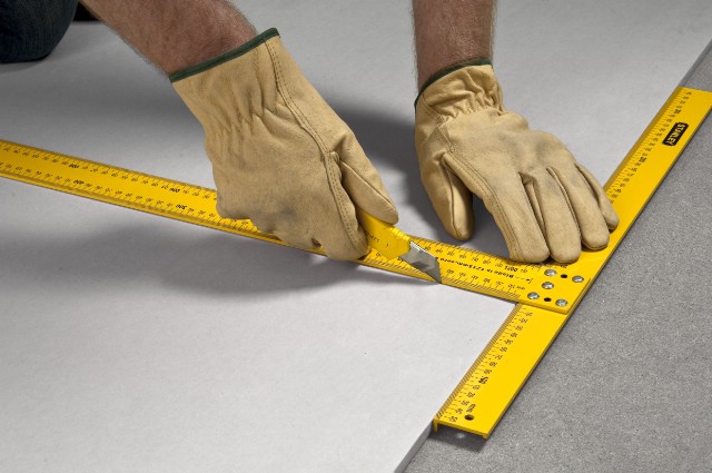

I was wondering how everyone is cutting their foamcore, i was using a knife and a ruler. But i was having a little trouble getting them perfectly straight, especially after cutting a few lanes there would be a few mm difference.

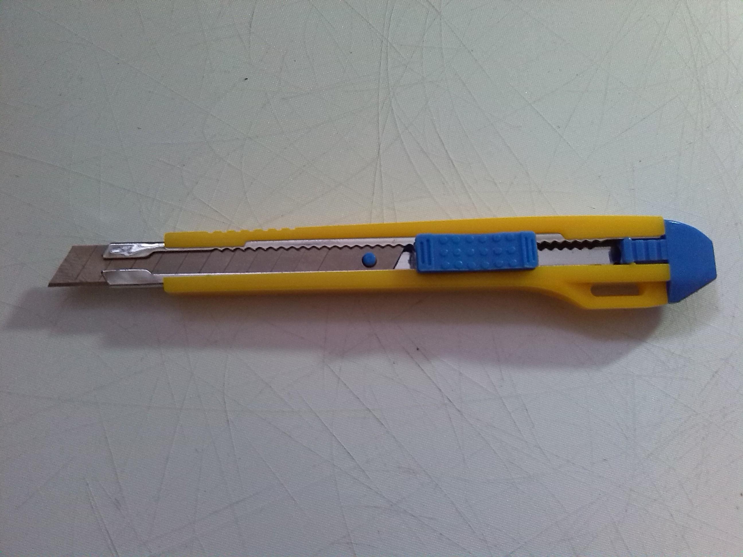

I get good success using a dry-wall T-square. It is considerably thicker than a normal metal ruler and thus provides a larger surface to keep the blade perpendicular. I use thin bladed "utility" knifes that I get from Dollarama ($1.25 for two knifes with spare blades). And I perform all cuts in two passes - the first cuts the top paper and half the foam, the second cuts the rest of the of the foam and the bottom paper.
Other things to consider:
* Important to keep the blade perpendicular - this may seem obvious but can be tricky with thin blades that have a tendency to bend, hence the drywall T-square.
* As soon as there is even a hint that the blade is not cutting cleanly, as noted by the foam being "pulled", sharpen it or in my case break off the next section of blade.
* Cut all the pieces in one session using the first piece of a particular width as the template for the subsequent pieces to ensure identical width.
Cheers!
Awesome tips for the FC master Grandcalmar. I actually use 3 to 4 passes and I use a big piece of masonite (leftover back panel from a old cabinet) as my ruler. $1 utility knives are the way to go 🙂 Or xacto blades for curved cuts. The key is to use the first piece as the width gauge for all subsequent panels that need to be same width. I get +/- 0.5 mm thickness variation doing it this way and it makes the box construction much better. I have been meaning to get the drywall T square!

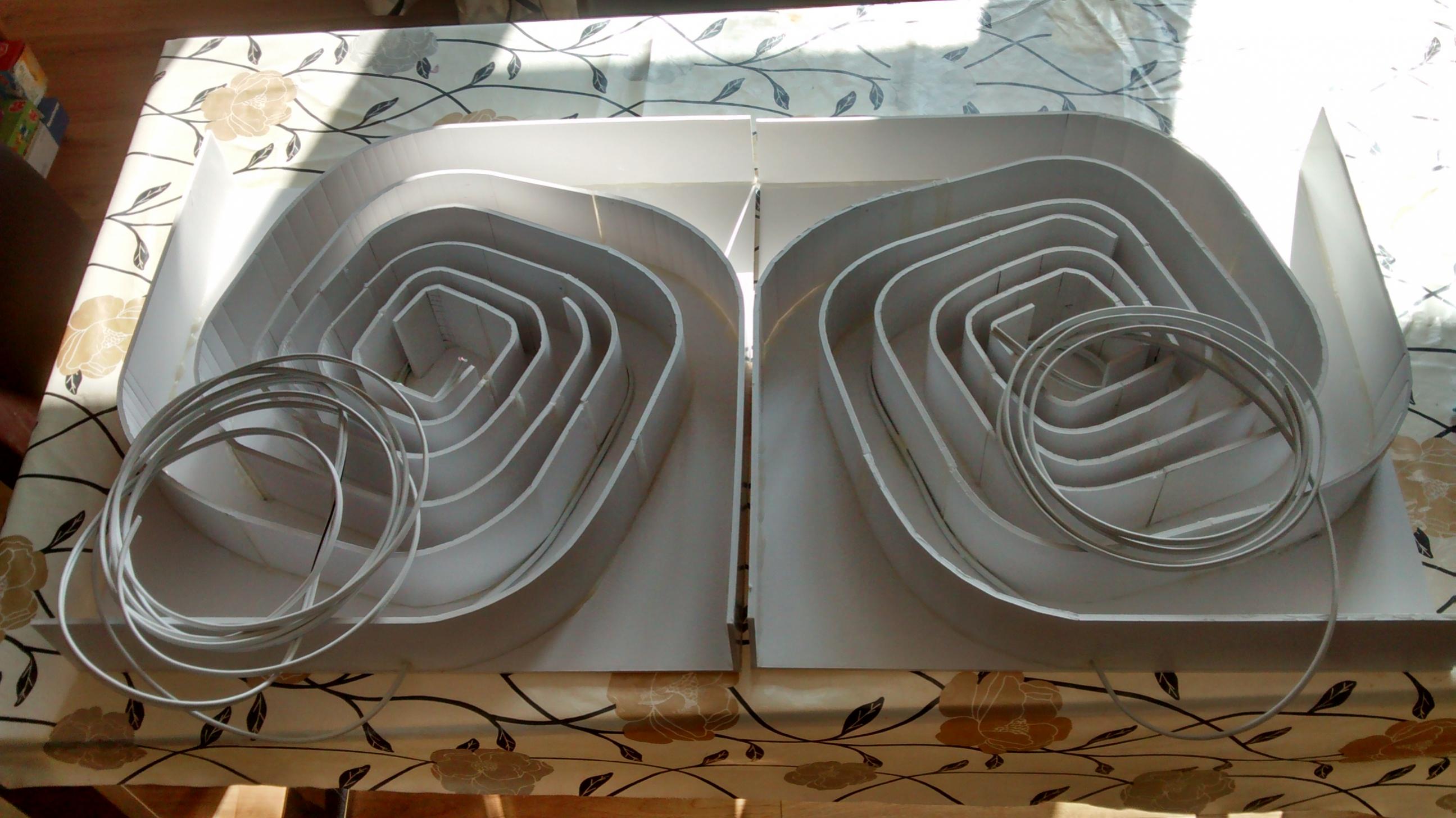

More progress on the Cornu's today. Sourced some nice wire from the local electrical wholesalers and wired up both cabinets.
As I've been itching to hear them in action, this evening I did a dry run with the front baffles taped on; the driver chamber stuffed; the drivers held in place with tape; and the speakers on the floor. Even though they weren't properly sealed or correctly positioned, I was still more than impressed by the quality of the sound they produced.
Hopefully tomorrow I'll have a chance to get the PVA out and get the cabinets properly finished 😀

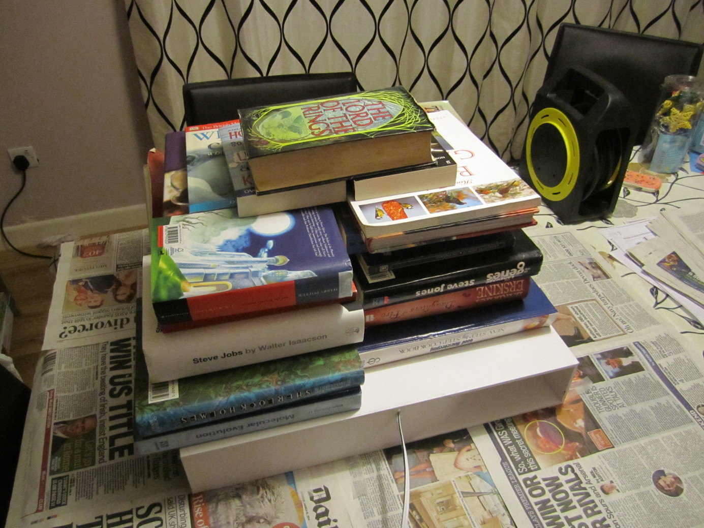

Got both cabinets glued up, attached pic shows the second cab last night, finally found a use for my PhD thesis after all these years, applying pressure while wood glue sets 😛
