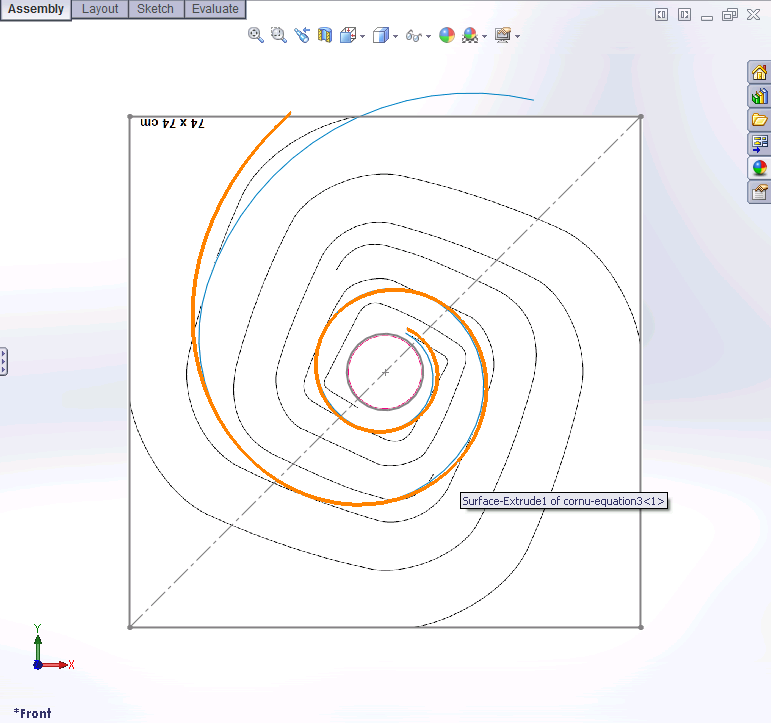

Quick update on the spiral cornu progress. I used the existing design as an underlay and did a first pass at the spiral using arc sections (see pic1, blue highlight). Then I mapped the clothoid (hyperbolic) over top of it. It turns out to be pretty close once you use the right part of the clothoid curve (see pic2, orange highlight). The cool part about the equation is that the wall curvature is now totally smooth. Seems close enough to me - what do you think?

Looks better but you need to end in a zero deg tangent to box edge to get the full horn expansion. If you are looking for smooth round spiral, I believe there is a set of plans in pdf by Endia in post #30. It may not be a clothoid but it is a smoother spiral and ends in tangent to edge.
Smooth walls are definitely cool and fun but will not filter out unwanted "mid-range" frequencies from the horn output. Smooth would be desirable in a front horn but not a backhorn. A front horn has output at the mouth; a backhorn has output at the mouth(s) and speaker membrane, if the same frequencies are originating at different points there is cancellation/combing and, I guess, "time smear" due to different path lengths(?). I'm thinking of going opposite of smooth, with some Nagaoka style hard bends, in my next Cornu.
Build a smooth one anyway, it's cheap enough to build for experimentation. This way you will be able to say you actually experienced the effect... or maybe you will like the weird effect, or it will sound awesome all the way and you can tell me to go suck an egg 🙂

Cal will recall that the very first foam core Cornu speaker I built (20 in x 20 in x 2.38 in deep with Vifa TC9FD), I manually added sharper corners internally to increase the amount of low-pass filtering available. I am not sure if all this is needed... because the other thing that really has an impact on how much high frequency leaks out is the ratio of the throat to driver chamber volume. The smaller that is, the lower the upper cutoff frequency. So a small slit with a large chamber will really limit high frequencies, but carried to an extreme and you won't have enough to fill in the gap left by the main radiation from the front of the driver. I think the equation for the upper cutoff freq is fh = (C * So)/(2*pi*Vol_driver) where C is speed of sound, So is throat area, Vol_driver is chamber volume.
As an example, take an average Cornu, with a driver chamber of about 6 in dia x 4.5 in deep with a throat gap of 1.2 in. This gives a Vol_driver of 2654 cm^3. The throat area is 70 cm^2, C is 34,200 cm/sec. So fh = 143 Hz, which is not a bad upper cutoff for a bass horn. Independent of sharp corners internally, the driver chamber and throat are already providing some nice low-pass filtering. This equation raises the novel idea of tuning fh by adding inert-volume blocks inside the driver chamber. This will have effect of raising fh. The actual magnet assembly of the driver and the stuffing to a certain extent do this so one can expect the fh to be upwards of 200 to 250 Hz.
Alternatively, one can add an extra extension just below the driver to increase the volume without increasing the throat area and this will reduce the fh value.
The second Cornu I built had smooth spirals with no sharp bends and it still sounded pretty good. So depending on your design and how big the throat is, YMMV. 🙂
