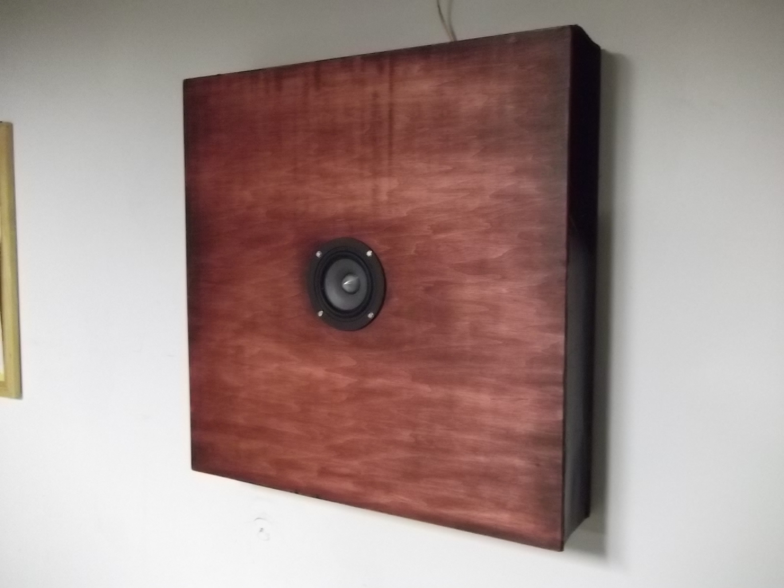

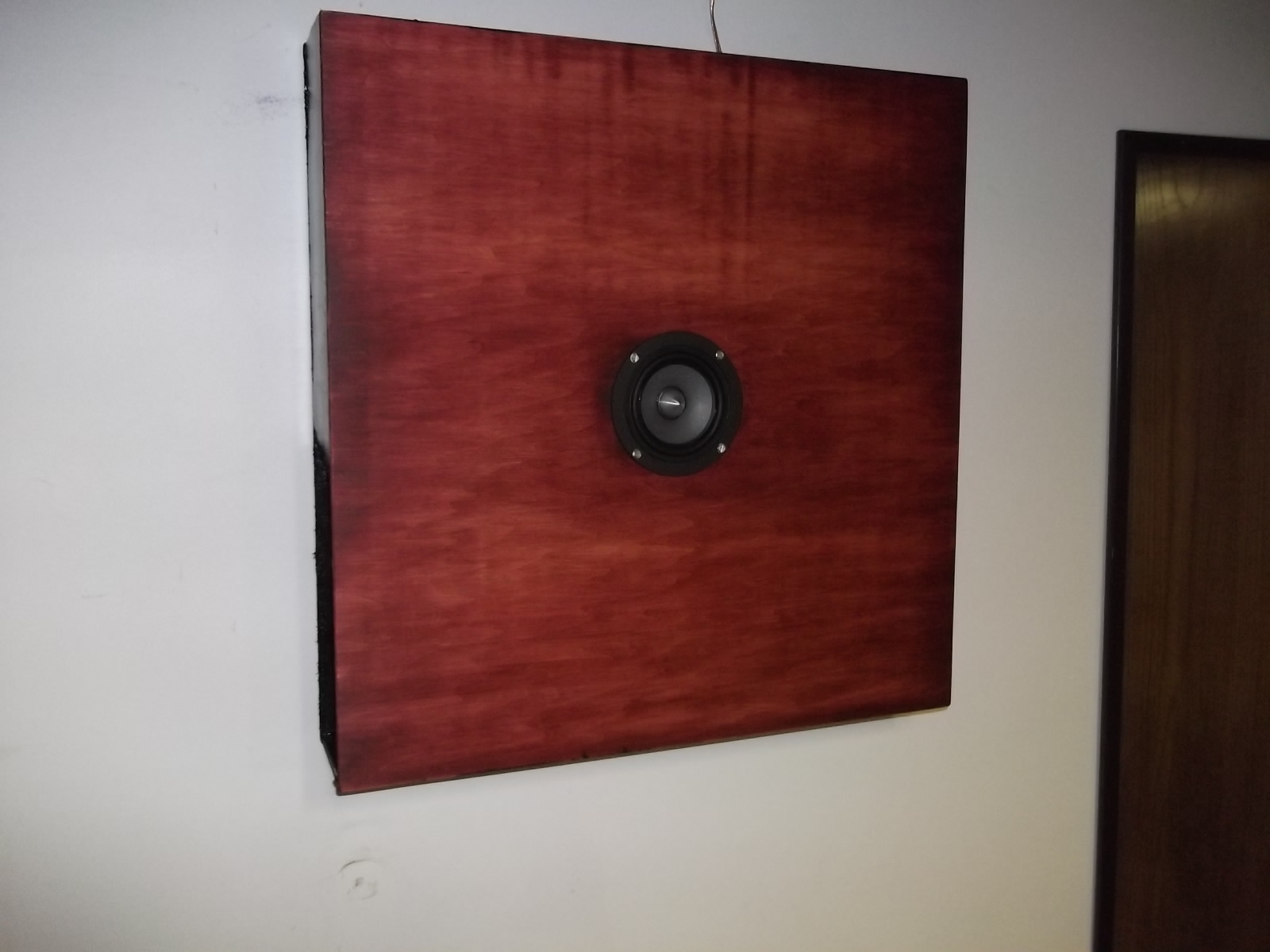

Well I finally got around to getting my pictures off my camera.
I've been enjoying these Cornu's for the past few months. 24"x24" with 4.5" channels. I went with the tangband 4" bamboo driver and love them!
I have many friends that can't believe the sound these put out. Such great low freq extension.
I monkeyed with the stuffing a bit behind the speaker a bit and it sounds great.
Fyi the foamcore doesn't really like latex paint. haha It separated from the foam when I got too wet. I just turned that horn to ceiling so no one could see it. Lesson learned.

Ryani,
Those look great! You are the first one I know who went with the 24x4.5 with TB bamboo. I guess it worked out well. How did you arrive at the dimensions? Very nice work. I wish I could hear it. Now I am thinking the next drivers to get are thr 4 in bamboos. Is that the 1337sdf's?

With a tip from you! Way back when. They are a little more expensive than most of the drivers I have used but they are robust little drivers. I'd sure use them in more projects. Great sounding.
They look great!! Congratulations!! 😀
How did you damped the driver's cavity? Which damping material did you use?

Ryani- They look really good. Thanks for mentioning the problem with latex 😱 I was ready to paint the sides of my newest ones 🙂
Thanks for the compliments.
Actually I used an old pillow for stuffing. I did it three times. The first time I had too much in....very low output from the horns. The next time I took too much out...way too many high frequencies. The final time was just right...at least I was happy with it.
prezden I think many light coats of spray paint will work better, making sure its dry between each coat. I did a little experimenting with some scrap after the fact.
I was in Hobby lobby last week and found many many colors of foamcore. So you can use the cheap white stuff on the inside and then use the colored stuff on the outside horn. No painting at all.

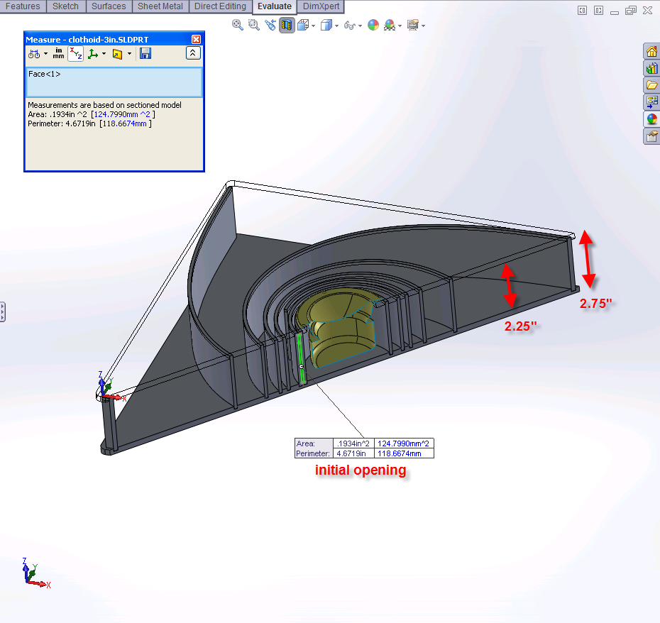

I'm new to speaker building, but thinking about trying this out as well! I have a few Hivi B3N drivers lying around that seem like they would work. I'm also planning to use a true clothoid curve profile for the horn. 😀

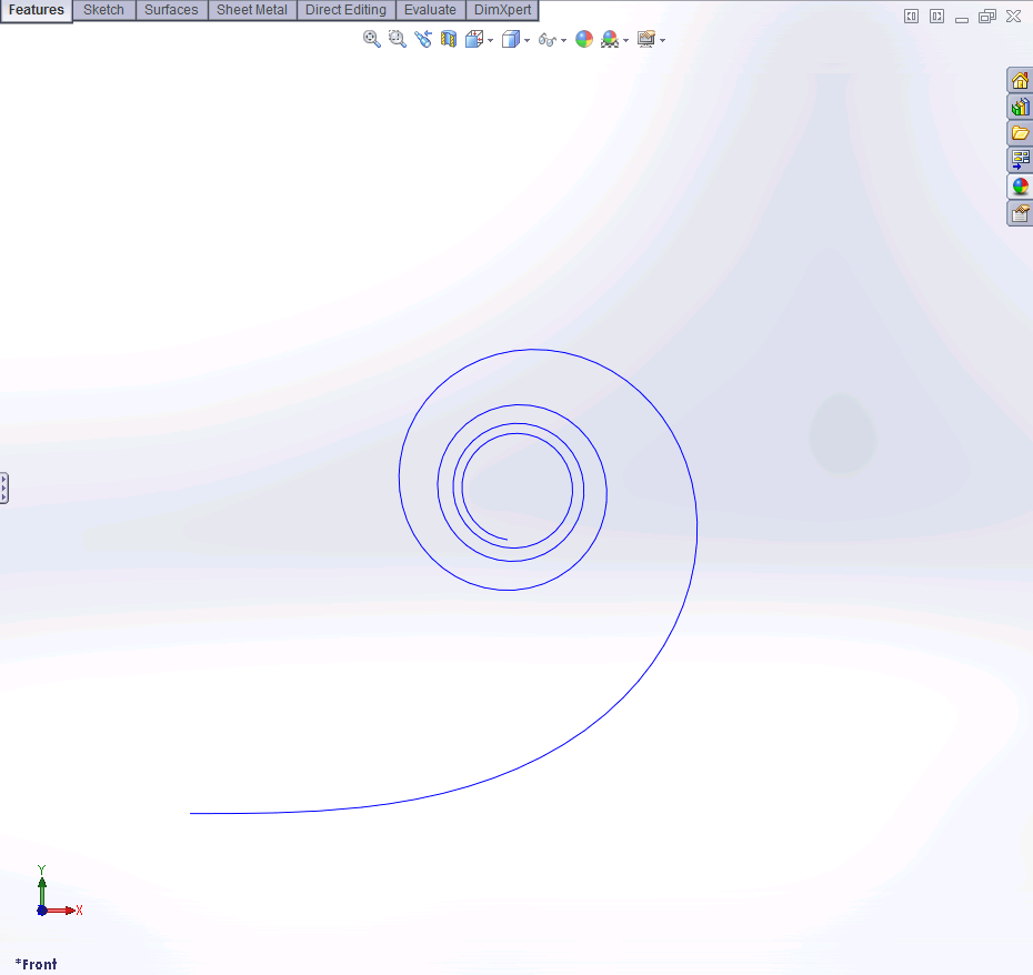

See attached pics for what I've drawn up so far. I've trimmed the full curve to 1.875 turns for the inner set of walls ones and 1 turn for the outer ones, following the lead of the existing posted design.
I would like to keep these boxes as thin as possible, but I'm not sure how to figure out what the area of the opening into the central speaker chamber (highlighted green on the last pic) should be. Does it have to match the Effective Piston Area (Sd) of the driver? The current opening is only 0.000125m^2, so I'd have a ways to go before getting to the 0.0030m^2 of the B3N.
I'll most likely CNC machine these parts and am thinking to start out with foam core to see how it pans out. What do you guys think?

Chandra,
Nice work on getting the clothoid equation into Solidworks! Were you able to directl run the equations in SW or did you import a parametric curve? I found I had to do the latter. The cloithoid or true Cornu spiral is very tight near the middle and this will make the freq cutoff very high and not good for bass. It will take some tweaking with curve parameters to widen up. But yes to first order adjust throat area to be no less than 50% of Sd of driver.

Some nice progress in here since my last visit. Good work guys.
Chandra, X is right when he says the spiral is too tight. Loosen them up a bit and make the box a larger overall dimension if you want to extend the horn length.

Thanks for the feedback - I'll update the design with a looser spiral and 50% Sd throat area. I'll probably overlay the existing design to see how it compares. What is the "normal" size for a 3" driver using the existing spiral design?
Also - the curve is a "curve through points" using point data generated in excel.

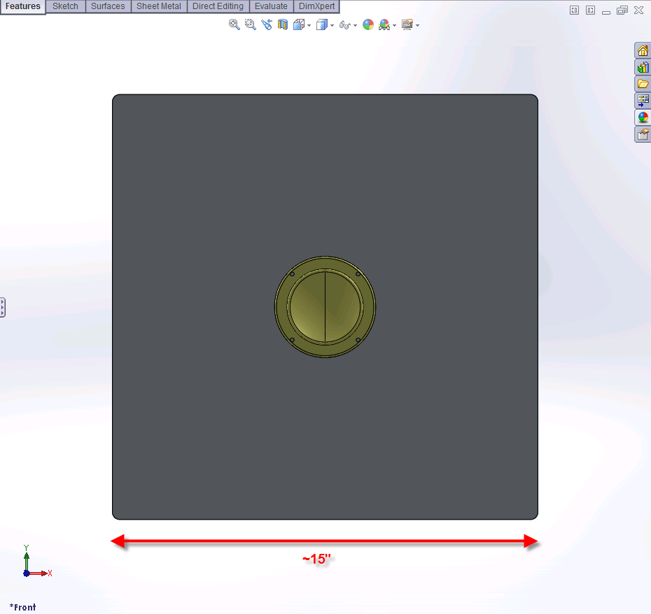

Chandra,
A typical cornu speaker with 3 in driver will be about 20 in x 20 in x 3.5 in deep. I had to import my curves the same way. There is a way to do a spiral directly in SW with a variable pitch. It won't be a clothoid but approximates the cornu spesker well if it were round without the square corners.
