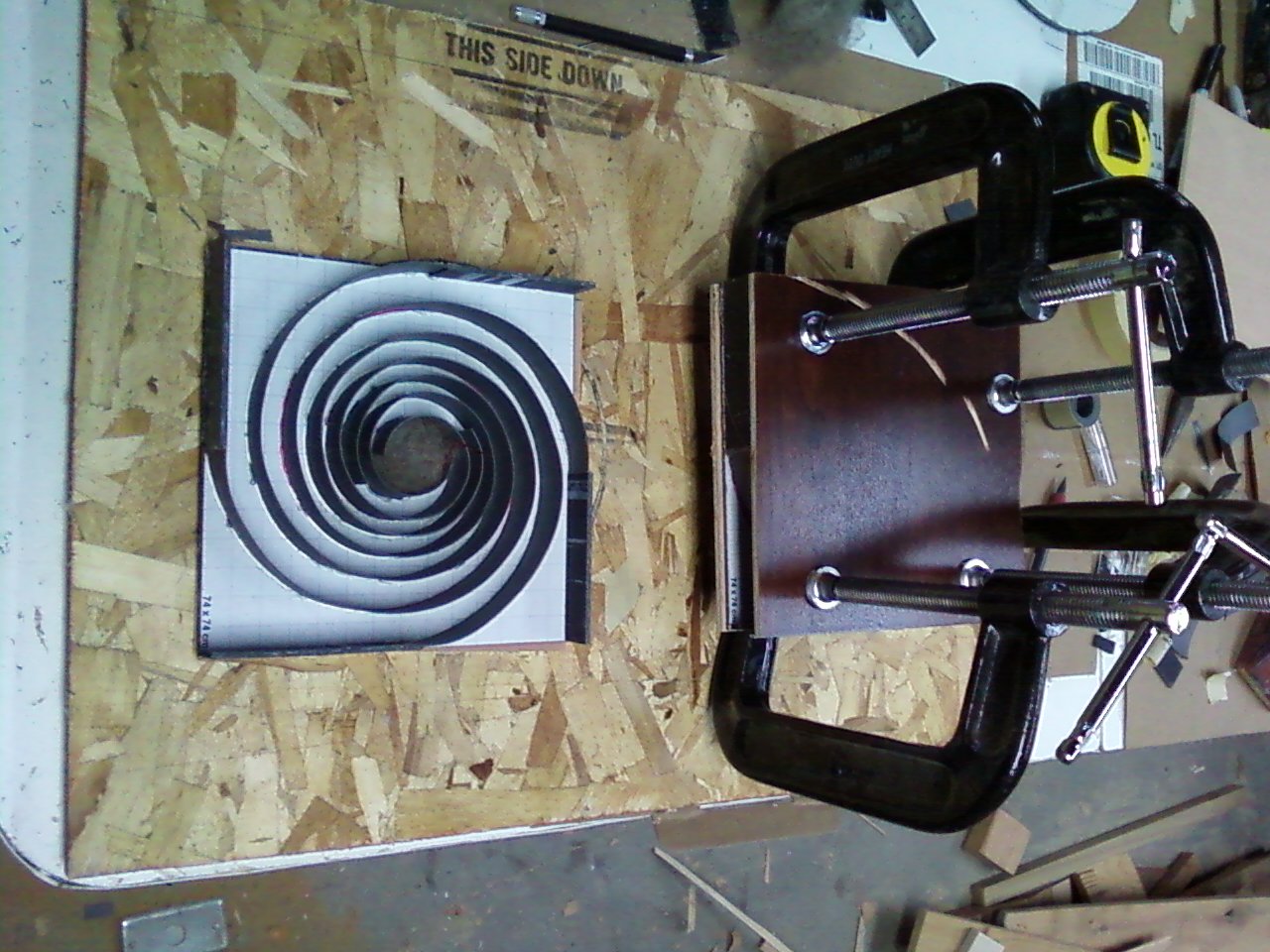

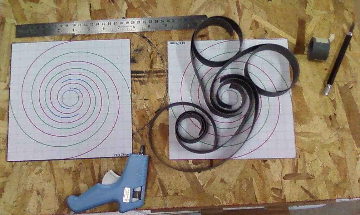

gluing together the spiral sandwich
Thank you Cal, you save my life! Had a crazy busy week and was not even back here on the thread. All 4 spirals are done and I will use your suggestion with the paper strip this weekend - excellent!
Originally I designed the drivers off center to get them closer together, because they are also separated wide by the fireplace. Off center they will be now about 2.5m or 8plus feet apart. Yes all 6 horns have different length and that will be an extra bonus I hope.
Yes I cut up some of my templates for joint tape. Made about a dozen of them in different sizes on the copy machine to help me design the real thing.
They have to be real good for me to build more than two. Was not all easy sailing to coax the spiral strips on their places.
Think I try single spiral ones next with 5 inch or 4 inch driver.
Am I seeing that correctly, that the driver is mounted off center so there will be 6 different length horns? If so you certainly have all the bases covered with tuning frequency. 😉
The foam joint tape - is that your spiral template? hehe, what, are you only building two of these?
As far as the glue drying, I would first install a 3/8" wide strip of paper to the cardboard edge with PVA glue, let it dry and then you will have a wider surface to put your glue on for the baffle piece.

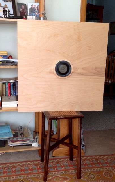

I´ve built my first Cornu, 56x56 cm, with two 2" drivers.
Purely for proving the concept, but I was not so happy with the large excursions the little drivers were force to.
So now I´m thinking of what to do next.
First is to have a larger driver for the Cornu, maybe something that is laying around and then complement it with my 2" driver(s).
So to be able to fit the larger and deeper driver I thought of extending the compression chamber in z-direction towards the listener by 2".
Actually it will be a second front to the Cornu. In the space between the two fronts will be regular 2" thick foam with an cut out chamber for the driver.
So what about the 2":ers? Well, they will be mounted in the second front with their own outcarved boxes in the 2" foam.

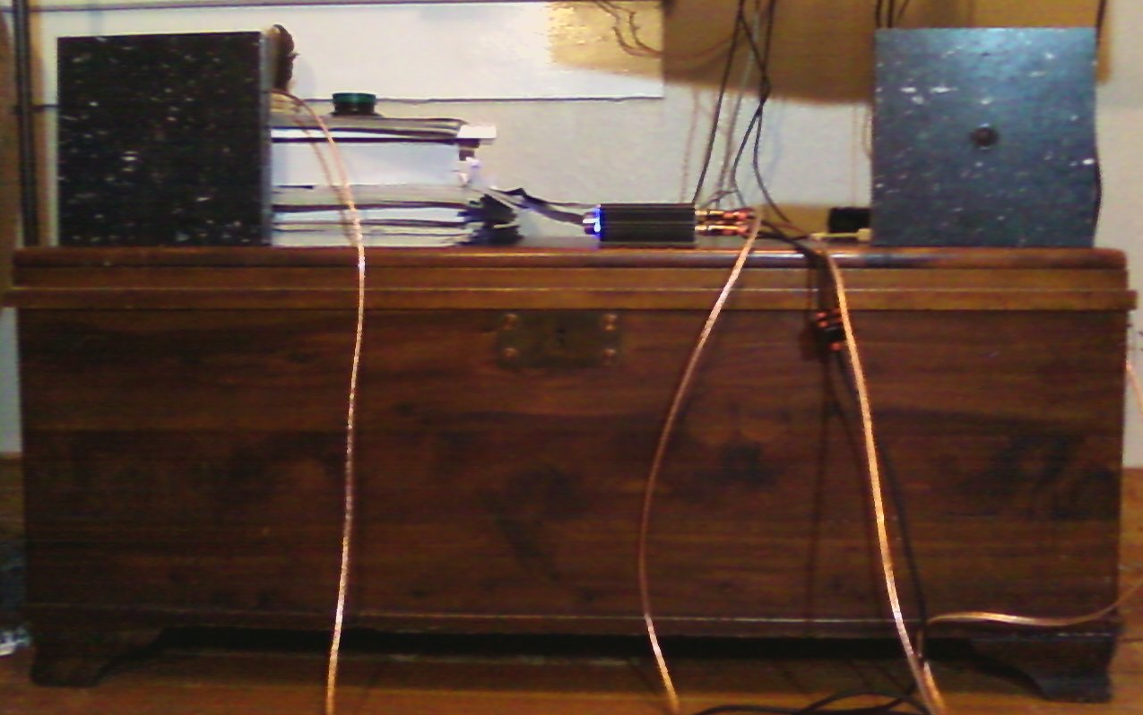

Feb 9,2013
OK, so I moved the speakers off the wall over the mantel and down onto the floor and six feet apart (which I am sure is a big help). They now are on the long wall rather than the short wall of the room. WOW! what a difference. They sound so much more open and airy. Sound stage depth increased as well. Even my wife immediately commented on the improvement. The dip in the 100-125 Hz range improved slightly, but isn’t fixed. And there is now a bump at 200 Hz. The bump at 80 Hz went down (shift in room mode?), level at 63 Hz went down, and spl at 50 Hz went ip. Note that on the floor one of the horn mouths is blocked. Then I moved them up off the floor, which isn’t much of an improvement, except at 200 Hz.
Again I used the 1/3 octave warble tones on Stereophile test CD #1 to see what was happening. Here are the measurements, made with a Radio Shack meter.
Hz: dB on wall: dB on floor: up off floor:
1,000 68 68 69
200 72 77 73
160 74 73 71
125 64 66 57
100 64 65 61
80 75 71 68
63 73 69 64
50 61 64 61
So far, I still prefer the Mets, which I guess isn’t surprising, since I have built 4 pairs of them.

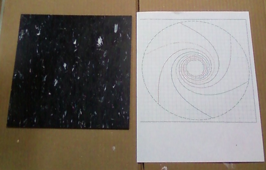

Sunday's Project
Been working up designs for the 1" Tang Band FR speakers in an 8" Cornu. Thought I'd try the 6 Horn design, but couldn't get the dividers to work because the tolerances were too close. Reverted to the 4-horn spiral. Using a fiber gasket material, 1/32" thick, that I got from an auto supply store. Cuts easily, and is rigid in compression. It came rolled, but I cut 1" x 26" widths and left tightly rolled over night. Took the .pdfs scaled to 8" and used spray adhesive to attach the print to the back of commercial grade floor tiles (cut to size on a table saw). Gluing the spirals went pretty fast; for the ends where they run straight along the sides I cut pieces of tile to fit. To stick the top on I put a thick coat of spray adhesive on the back plate, threaded the wires through while standing everything on an edge, then clamped together using some 1/8" plywood for backing. Before gluing I stuffed some wool behind the drivers.
Looks O.K., sounds horrible with cutting in and out. The wires on the speakers are so fine it's hard to get them attached well (even with soldering). Will do some troubleshooting, but the wife just walked in and turned the amp off saying she couldn't take it anymore. Well, that's development: win some, lose others!
Jsouder,
Wow, floor tiles and gasket material! You really are trying some neat alternatives there. Does it sound bad due to loose wires or is sound bad? Prezden made a small one for a 1 inch driver with some success but I think it may have been bigger. Very cool, and glad you are thinking out of the box! Thanks for sharing.
X
X
jsouder, great idea with the gasket material. 1/32" that´s only 0,8 mm, right?
Isn´t it hard to get the whole box rigid enough?
Perhaps it is if it is only 1" deep though.
I´m using floor dampener, 5 mm thick XPS foam.
The initial horn is then a little bit harder to get correct:
Perhaps the gasket material could be used in the beginning for flexibility and then have foam for rigidity.
