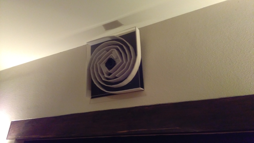

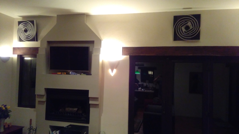

Decided to make some (more) Cornus as per the original XRK71 model, this time out of clear perspex for the front and black MDF for the back, so the spirals stand out really well.. Very happy with the end result.
I would have preferred to hang them a bit lower on the wall, but this is the only wall space I have available, so I have tilted them downwards a little bit.
I've had a pair of Cornus like this (made from all MDF) for a few years now and I still really like the sound.
I have a little Sure Electronics TPA3116 amp driving them (stock except for Panasonic Oscon caps upgrade) and I really think its a great combo. All thats left to do now, is to make a perspex case for the amp.. 🙂

Cool - those look great! What a neat idea to use Perspex. You can run strings of LEDs in them for Xmas🙂
Good amp to go with it.

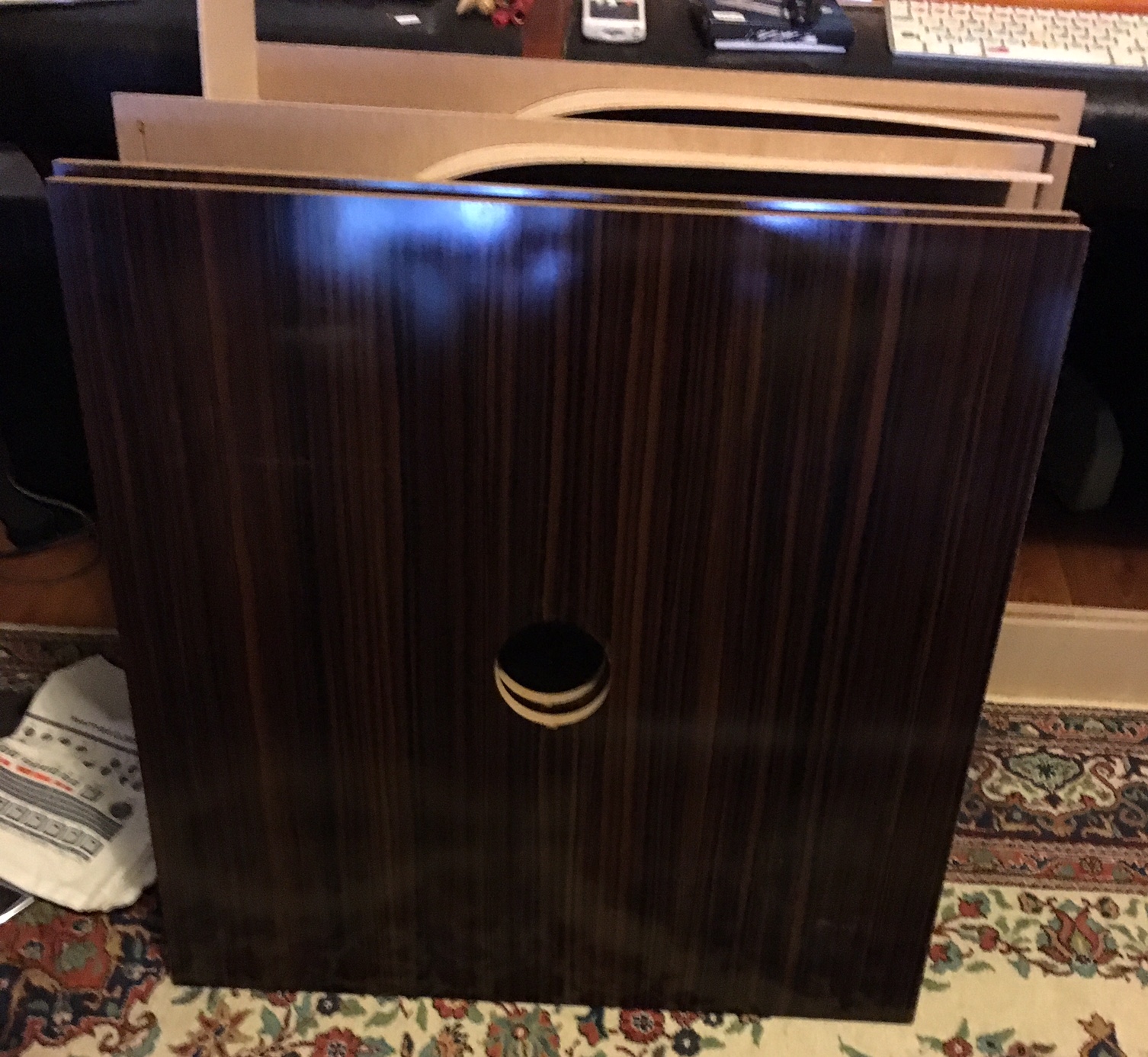

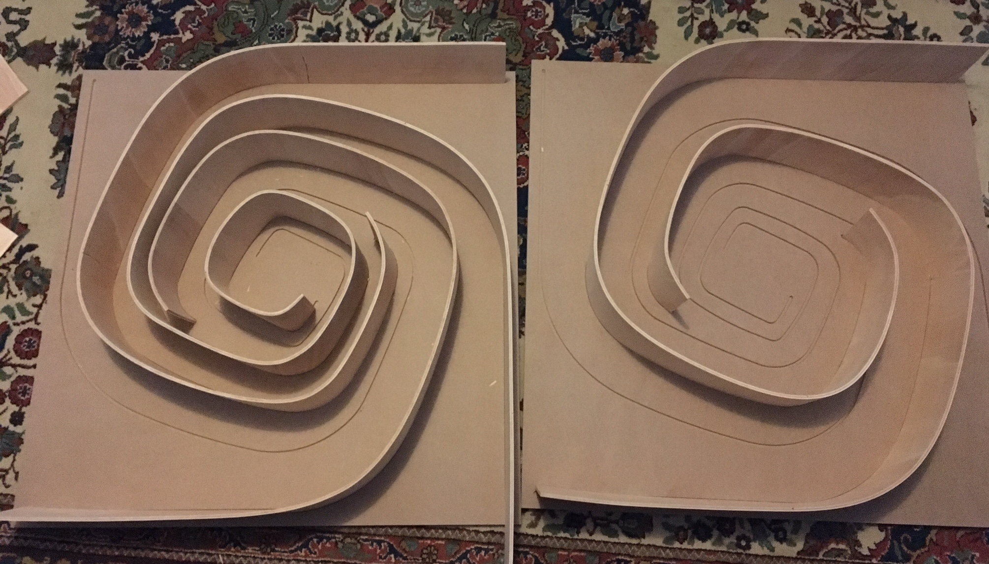

parts cut
I got the parts cut and I tried them, everything fits 🙂
I have a week of leave and will be travelling off country, when I come back I will finish these 🙂 can't wait
The front plates are 18mm mdf and the back plates are 12mm mdf. The flexible plywood are 5mm thick.
When I am putting it altogether, I will have better photos and with all parts together...

Nice work there Kodomo - great to see someone make it with CNC channels and flex plywood. Should sound very nice.
