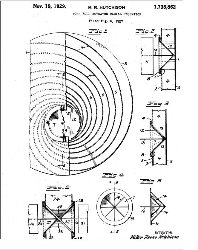

Thanks for finding that George. I am not sure where the actual driver is as I don't see a voice coil or magnet. Just two opposed conics?
The single (or two opposed, both arrangements are shown) "conics" are the driver cones, driven via pushrod from an external unit. In the Cornus in this thread, the arrangement is approximated by having the back of the driver in the throat of the spiral.
