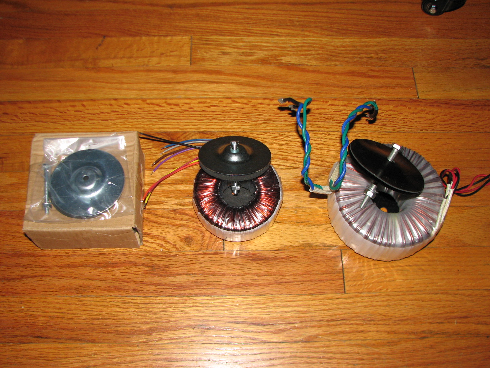

Avel-Lindbergs arrived. They are a high quality unit, very tightly wound. Compared to the 500 VA Antek they look like something I would use in a preamp! I know they will do the job no problem, and they should given the higher price.

No, I bought two of the 250 VA 18 + 18 pieces. They will be for standard dual mono FirstWatt clone. That is why they are smaller, but also appear to be wired tighter. Of course they are smaller, 1/2 the VA of Antek. I have a pair of Antek 300 VA in a F5, l will compare the Avel-Lindberg unit to them.

Take a photo

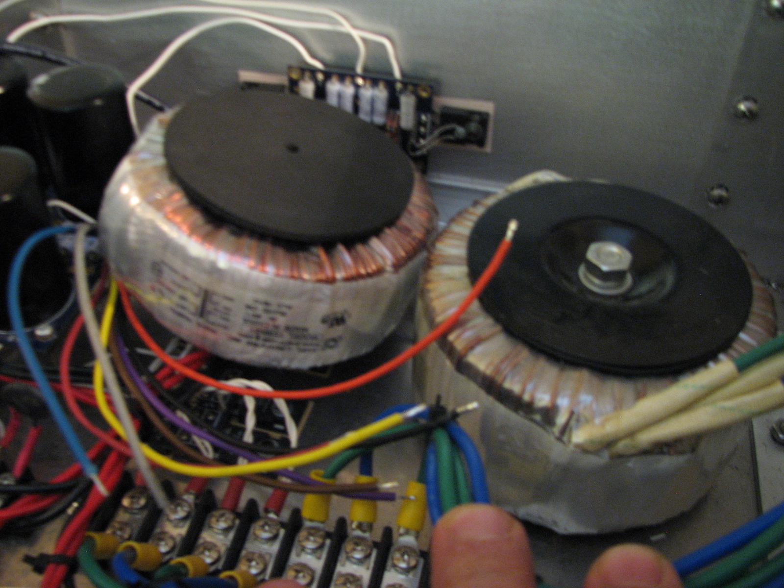

Here's some pics of the transformers. The larger transformer is the Antek 500VA I removed from the amp. The other pic shows it compared to one of the Antek 300 VA transformers in F5. Its turned off unplugged and so forth, Avel-Lindburg transformer laid beside it.
The replacement Antek 500 VA transformer is on its way.
