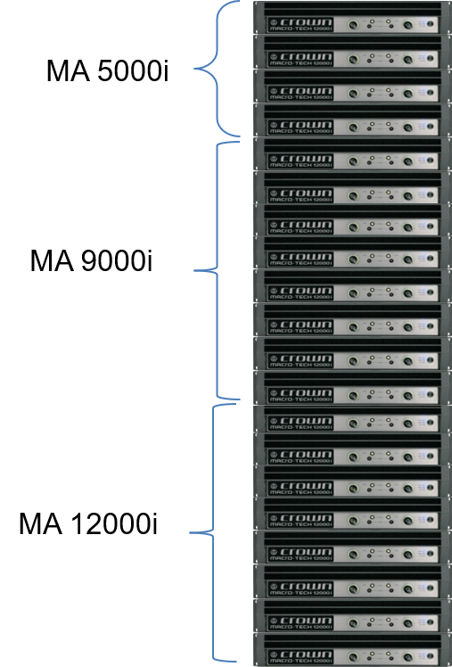

Chris,
This is a pic of what the rack looks like 20 Amplifiers, the system is 32 QRX 218 Subs 12 EAW 860's and 8 smaller line arrays and some other smaller system in front. Please note my only issue is with the back low bass

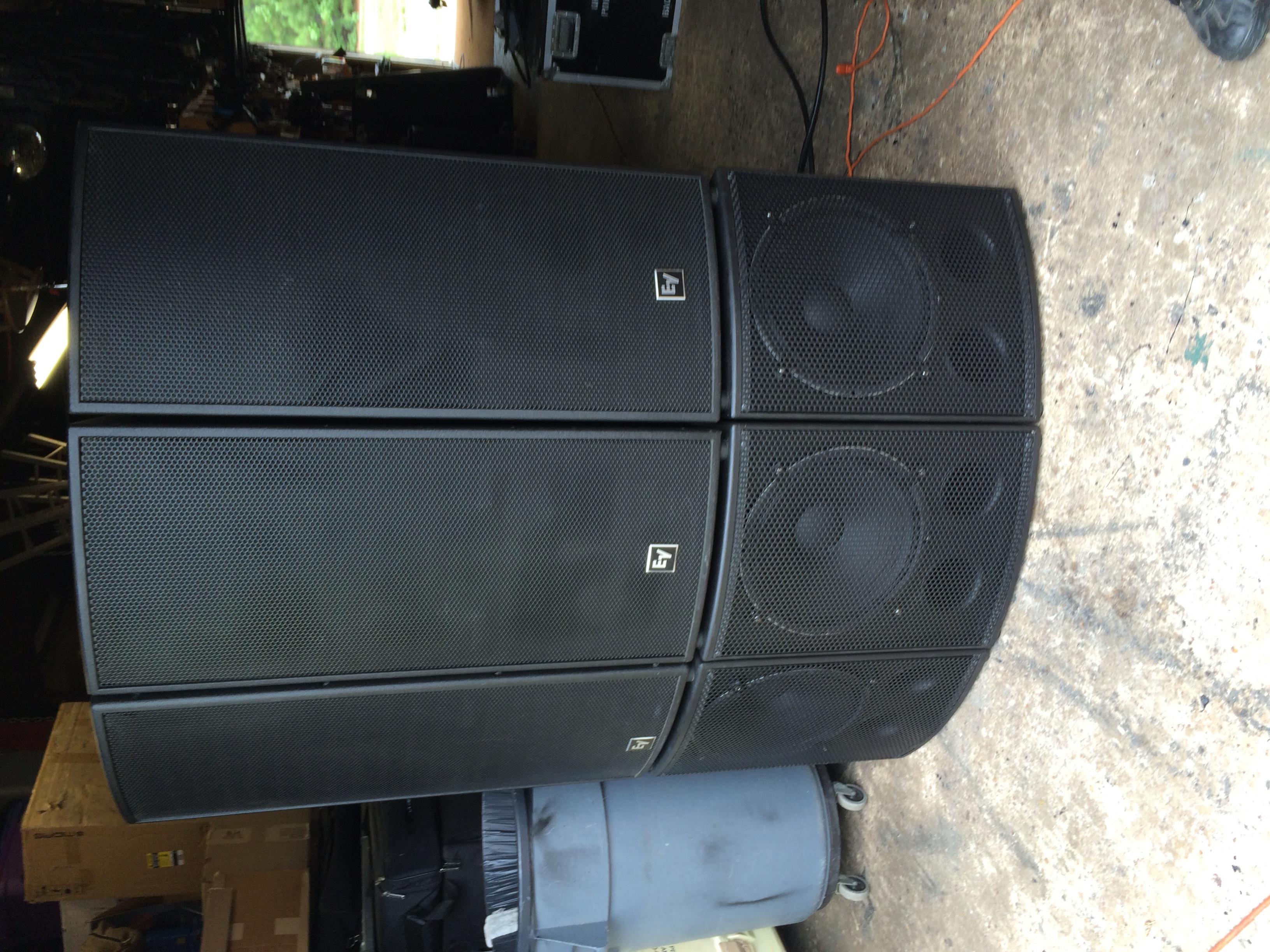

final QRX outcome
Sorry, busy as heck.
When I did a Pink Noise assessment of the box the HF was at 105db with a nominal signal input with the the meter about 40" away from the grill. The mid was at about 104db. The 15" was about 95dB! Way behind.
That's when the push went to shove with the second 15" added to fill the "hole" in the response curve.
A LOT has changed since I last posted. Blew every HF driver on a really loud outdoor show and revamped the entire box. The boxes are now 3-way active (NL-8 connector) and XTA 226's as controllers.
Changed those drivers/horns out to 2" BEYMA 850's on an aluminum B&C ME-60 horn on pin 4.
No more problem with the down-firing, I just tilt them in the air for coverage. Each box still only weighs
95#. Single 15's weigh 44#. Flybar is steel so it's 50#. 467# before copper and 1/4T motor.
Mids stayed as they were, very clean and warm on pin 3.
15's in the box are pin 2, separate single 15" box outputs on an NL-4 on pin 1 to that box with 90 degree NL-4's. Can't even see them they hug the box so tightly.
Subs for the system are QSC 181's in a triangle to get cardioid subs. Processing is done on a EV DC-1 and are always driven from an aux or from the center channel of the Midas M-32 (my preference) because it's always post everything on the board and is assignable. Little if any bass onstage keeps the wedge volume way down.
It's a little ridiculous I know, but it's point-source stable sister is a NEXO Alpha rig. It has to compete with that 20 box monster when their budget or ballroom location means a fly-date.
In it's defense, it flys super quick, absolutely kills in a ballroom, and weighs 500# on a single fly-point. It's WAY warmer than any line array I compete with in this area and looks great flown. The cardioid subs are just amazing. I usually shove them under the deck. I love the looks I get when that bass punches up out of nowhere..........
