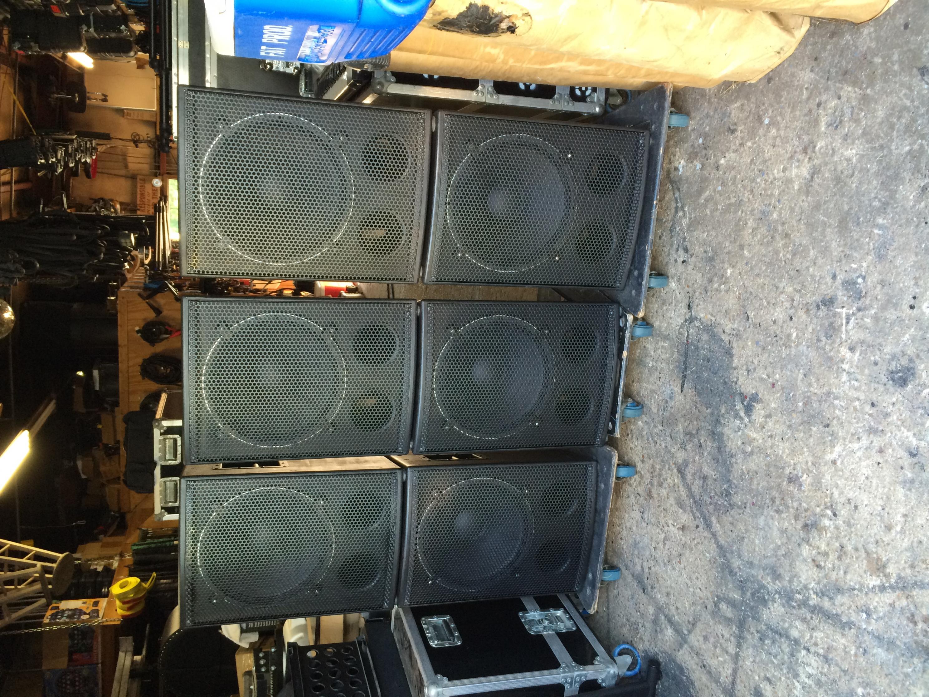

The solution I went with was to add 6-single 15" boxes (3 per side) for more low-mid and getting the boxes stacked higher as well.
Anybody who uses these boxes know they fire downward at a 10 degree angle. Great in a ballroom when flown, not so great when stacked in some instances.
The same drivers (3015's) were used in a similar alignment as the 153. 2.8 cuFt, 2x 4" ports, their medium box alignment.

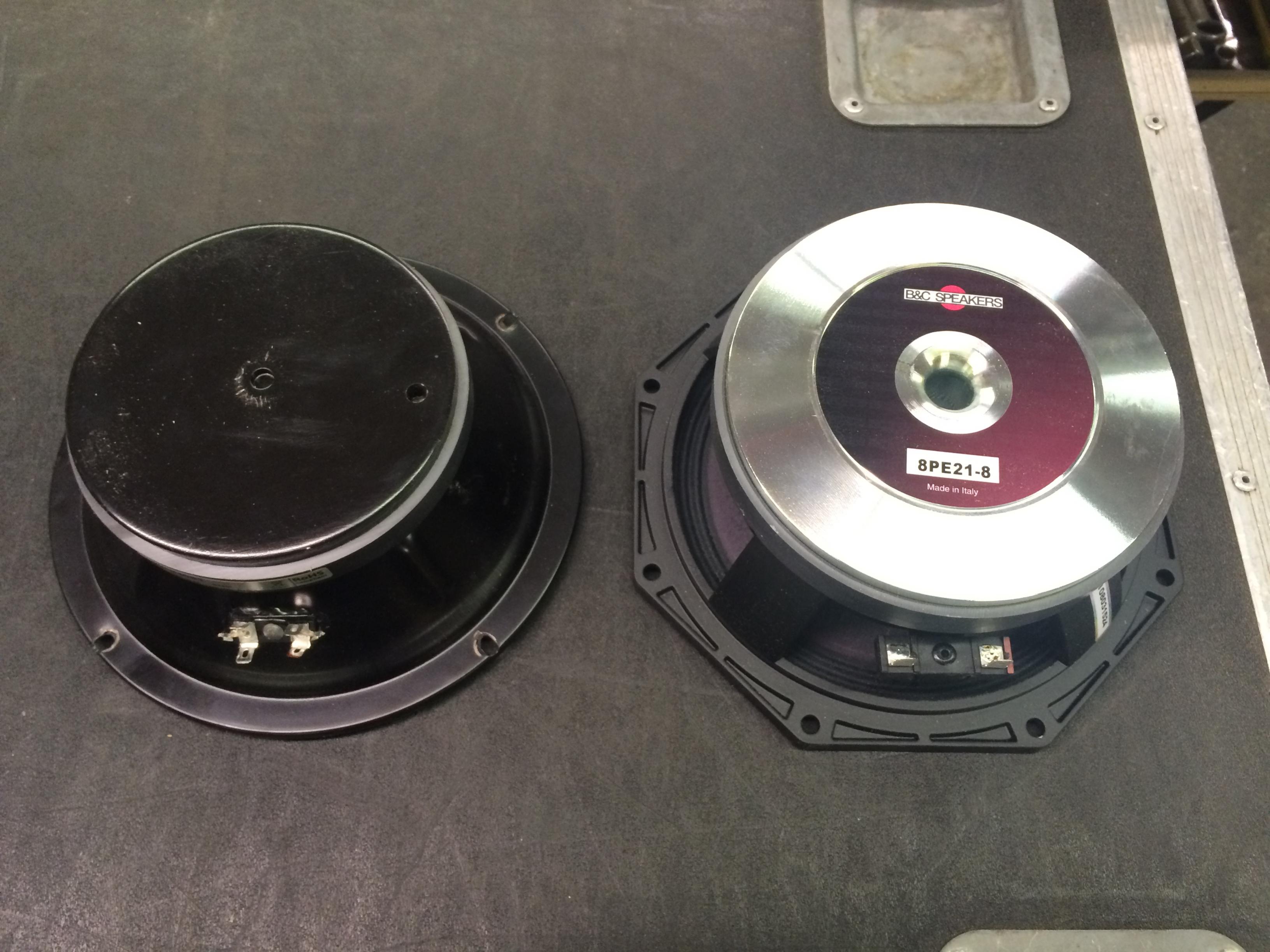

About this time I pulled a 8" horn out of the box and was quite shocked. The plastic horn was warping badly at all the fastener points, and there was NO phase plug. Just an Eminence sealed-back 8" slapped onto the horn opening.
As I looked into this further I found the Eminence driver they used (Alpha 8MRA) had a FS of 514hz! Dead at the start of the passband! Couldn't have all this.............not at all.
I knew jumping into this would be expensive and a lot of trouble.
I should say "a lot of trouble" is southern for a lot of work.
The final replacement driver I chose was a B&C 8PE21. Good power handling, FS way down low (87hz), It just needed MAJOR construction to make it work on the factory horn.

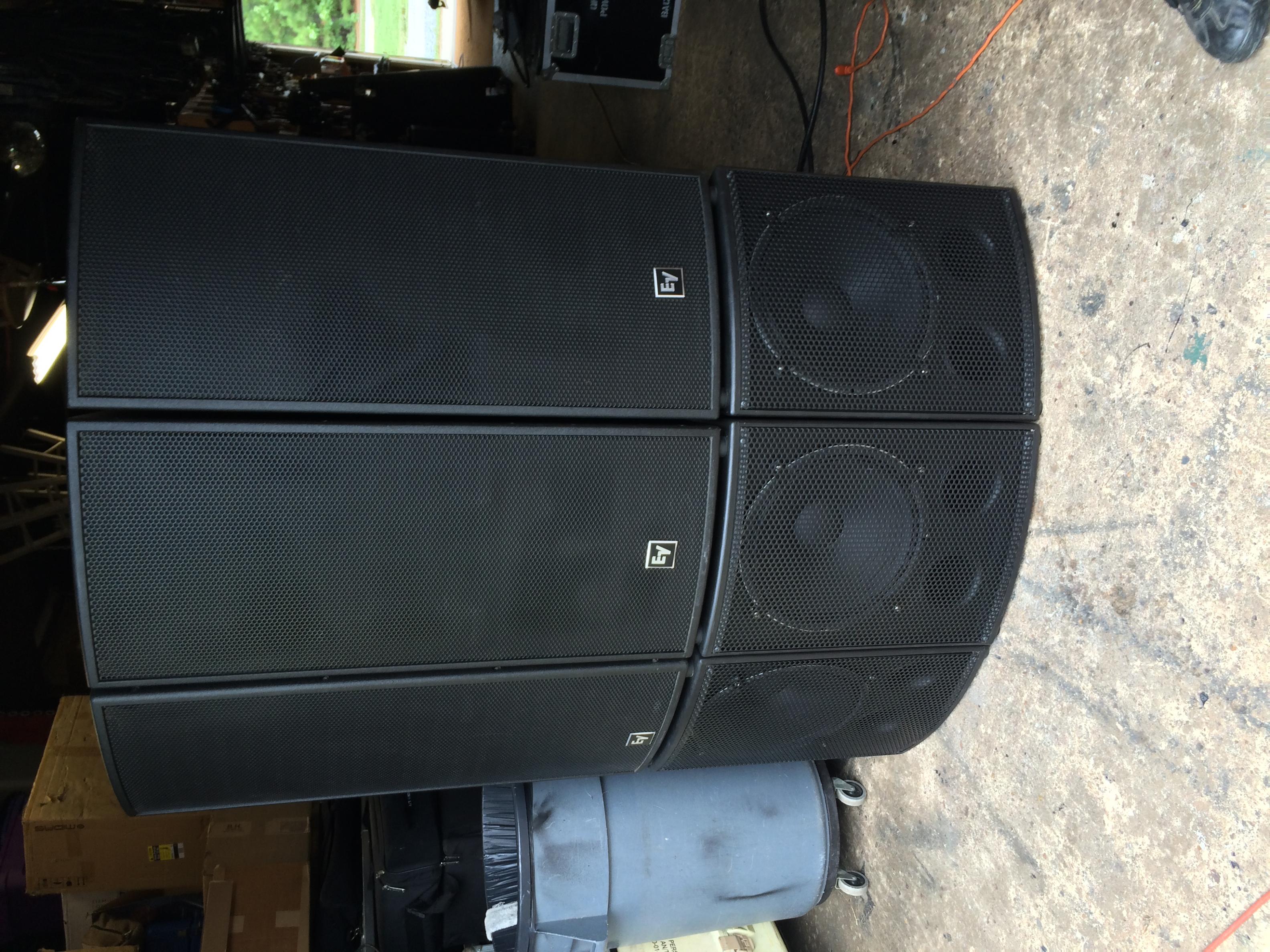

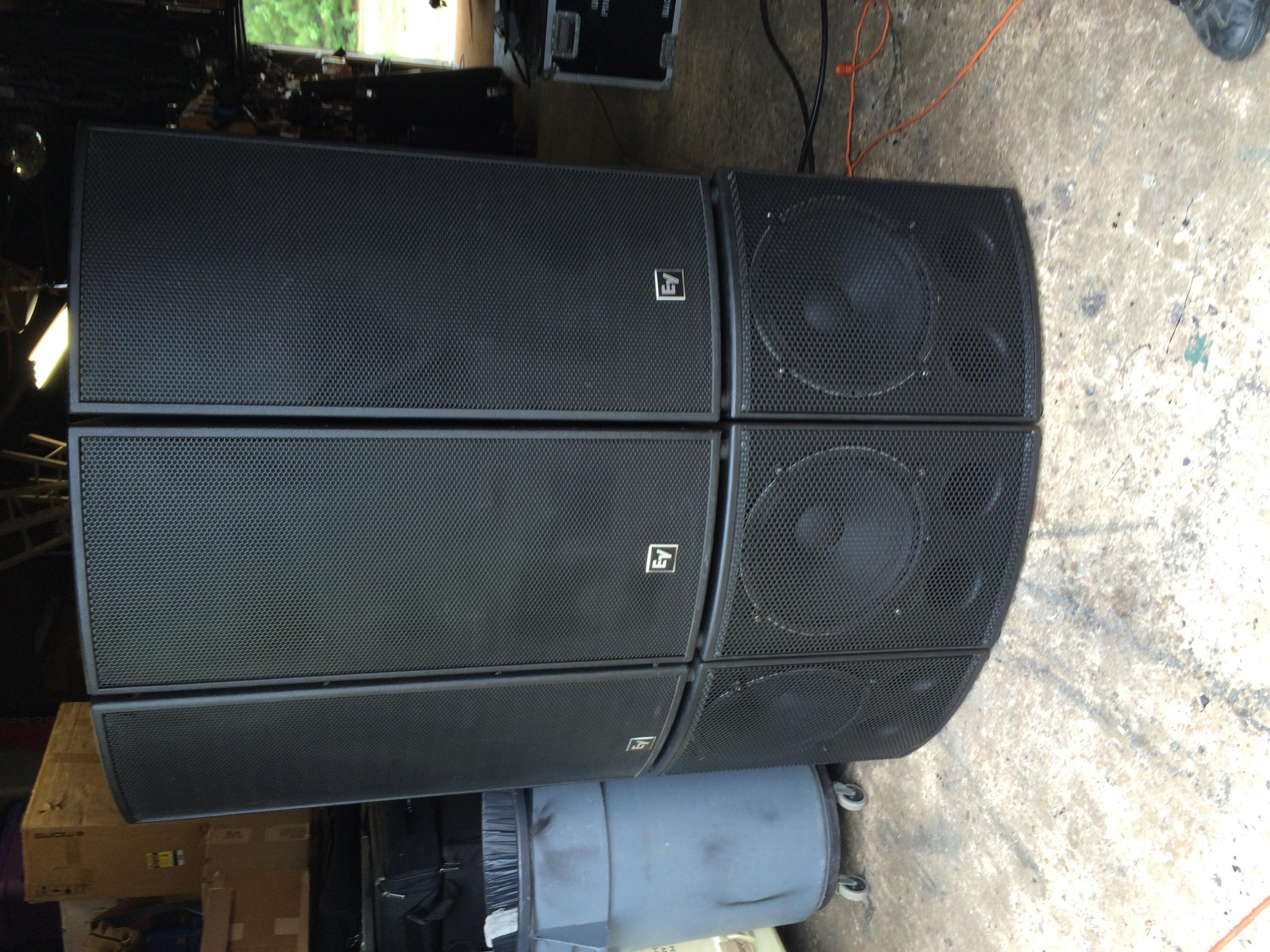

Single 15's
First the 115's and them stacked with the QRX.

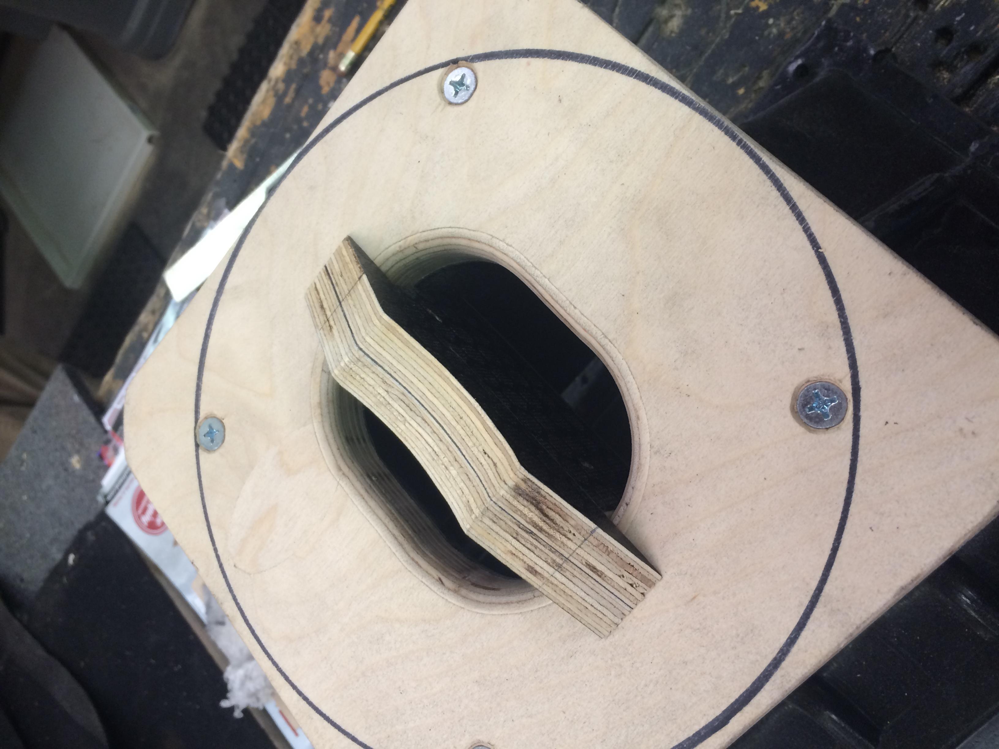

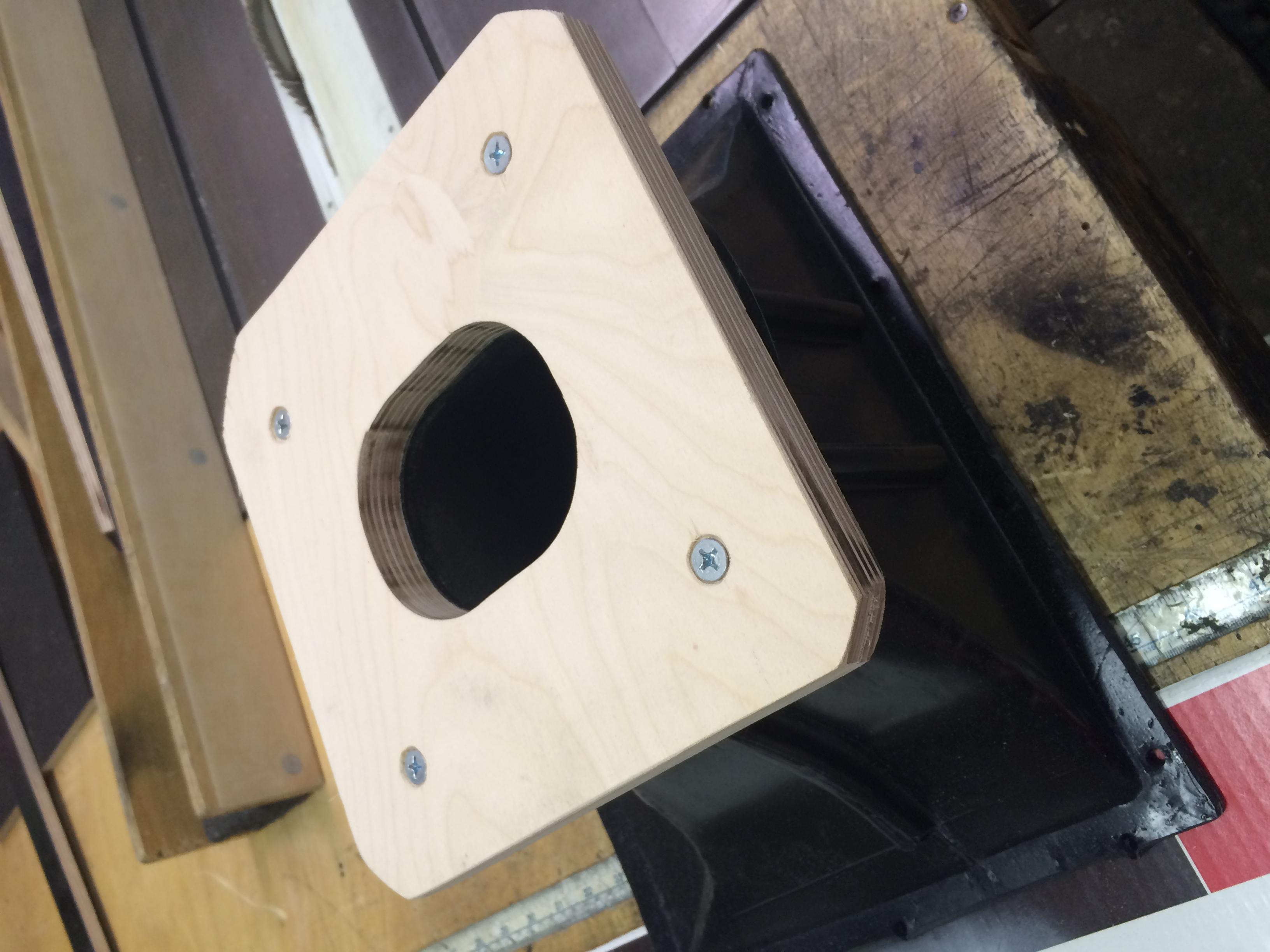

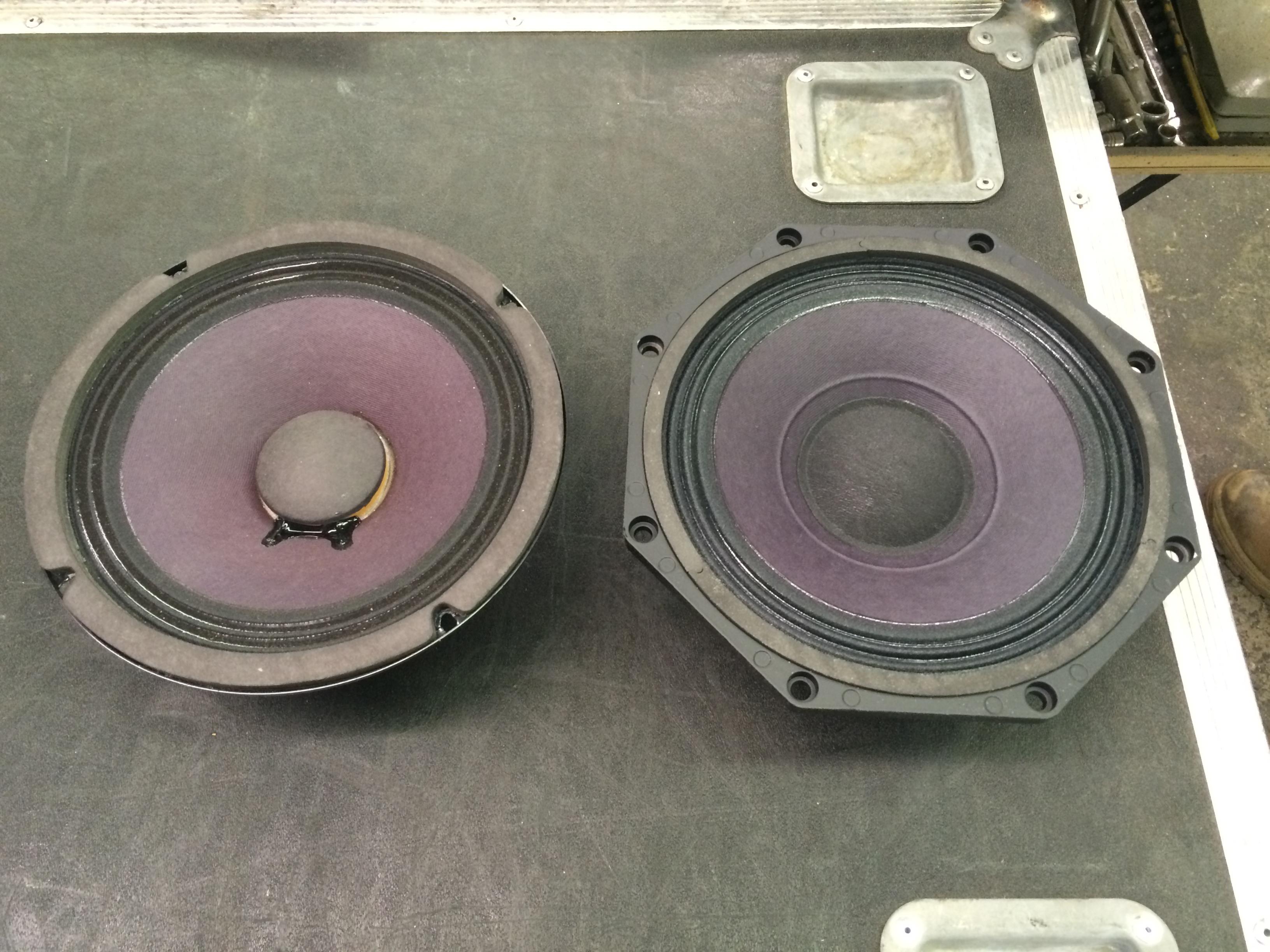

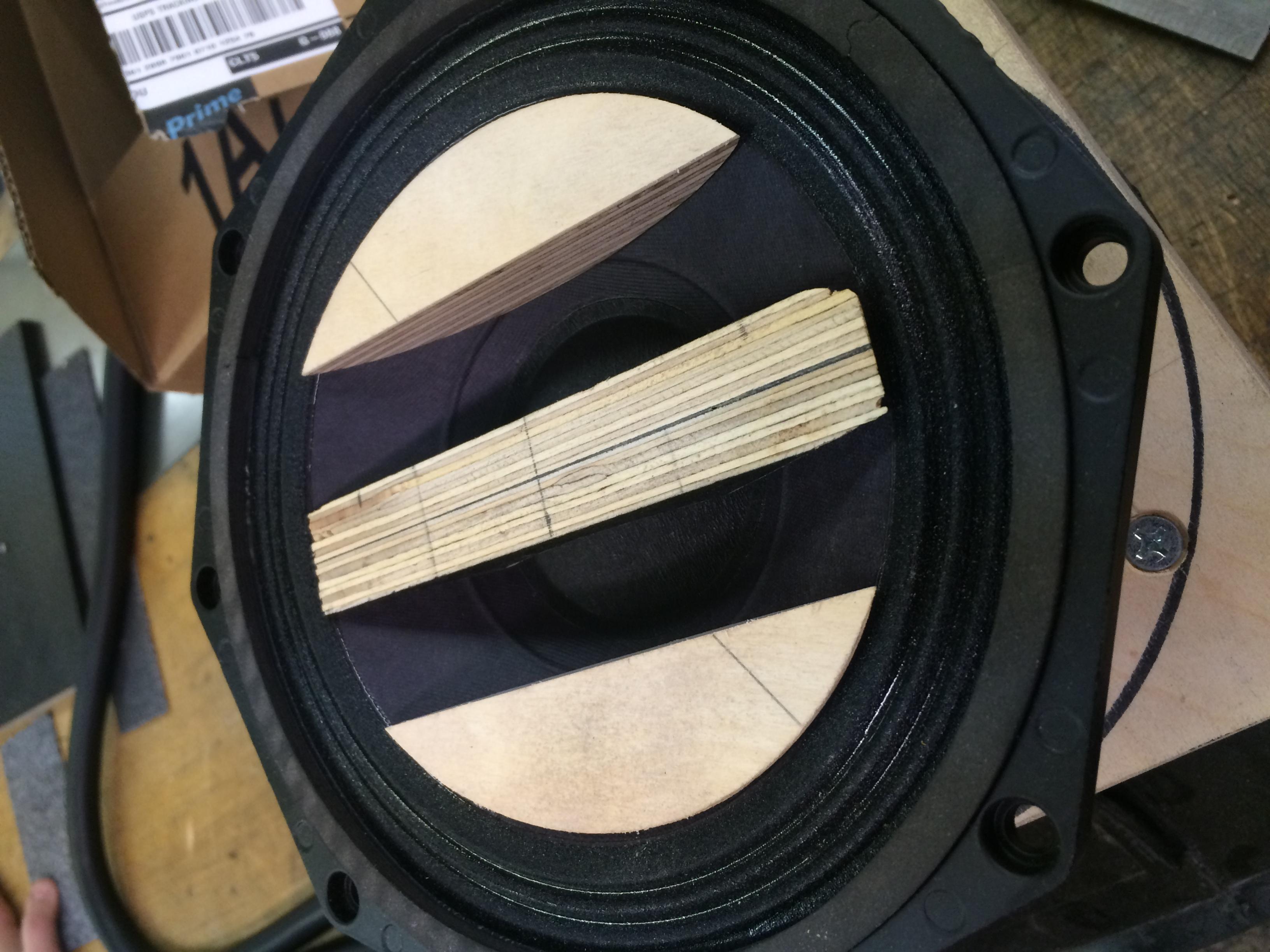

Pics of Phasing plug

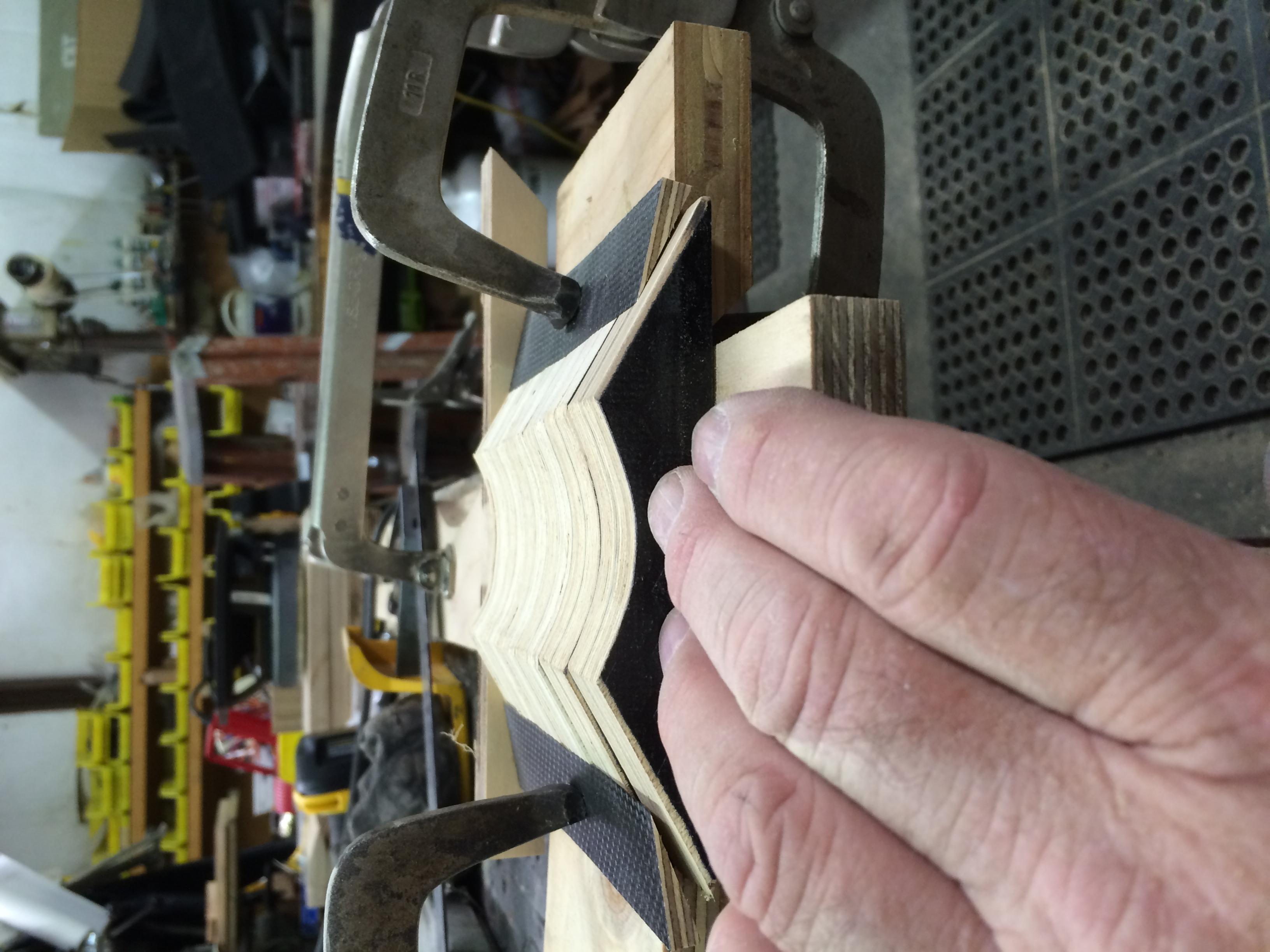

I knew I couldn't just slap the new 8" driver to the existing horn. Besides being physically impossible, the horn flange needed strengthening.
A heat gun, clamps and a large SS plate flattened the warped flange.
I cut a 10" x 10" 13ply square and put a 3" hole-saw opening in the center.
A 1/2" flushing router bit in a router table enlarged that hole to the horn opening
shape. The odd octagon shape of the B & C is shown next to the Eminence.
I knew this would make finding a back cap difficult. I really didn't have room to fabricate one from wood and the speaker cabinet narrows a lot where the handles
are in the box.

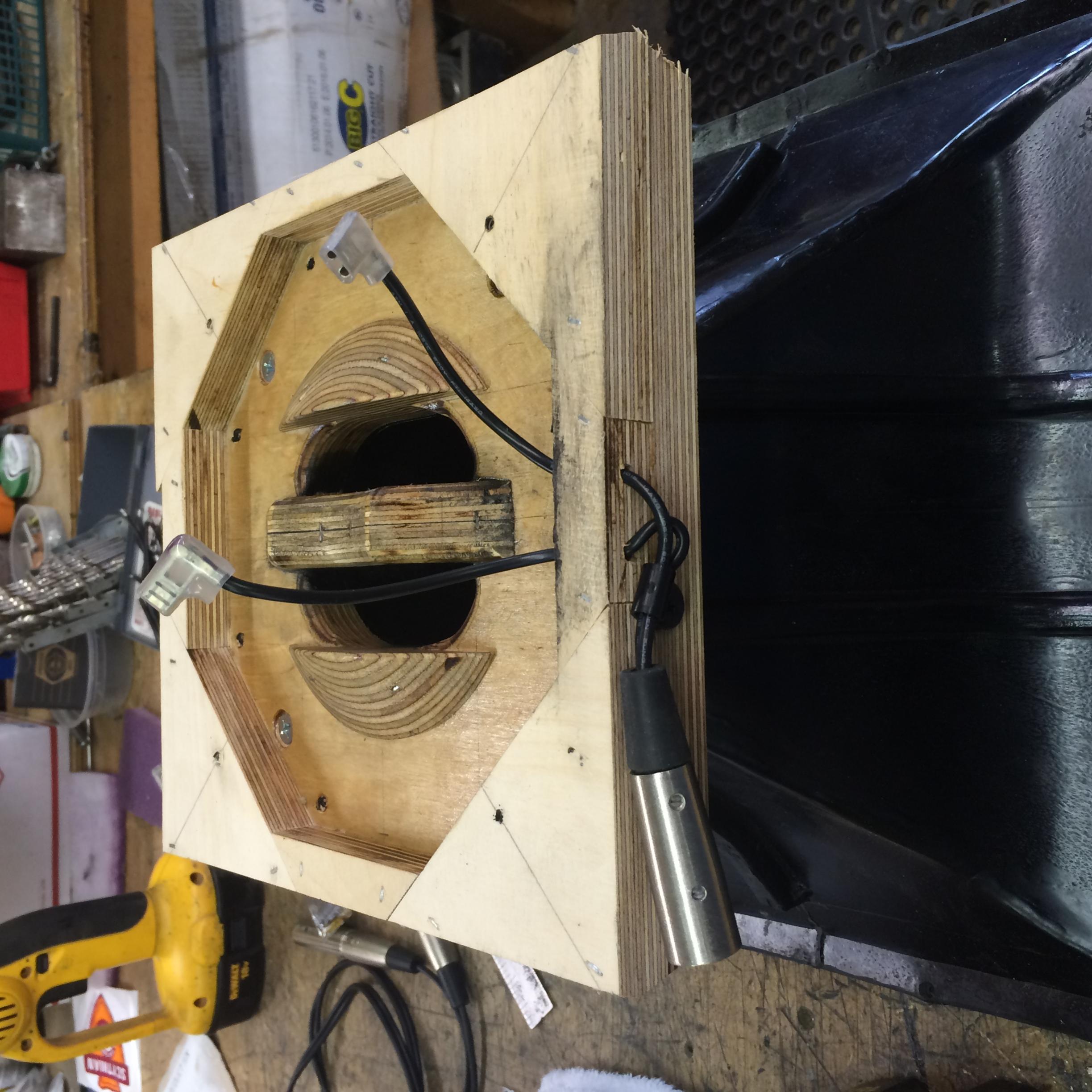

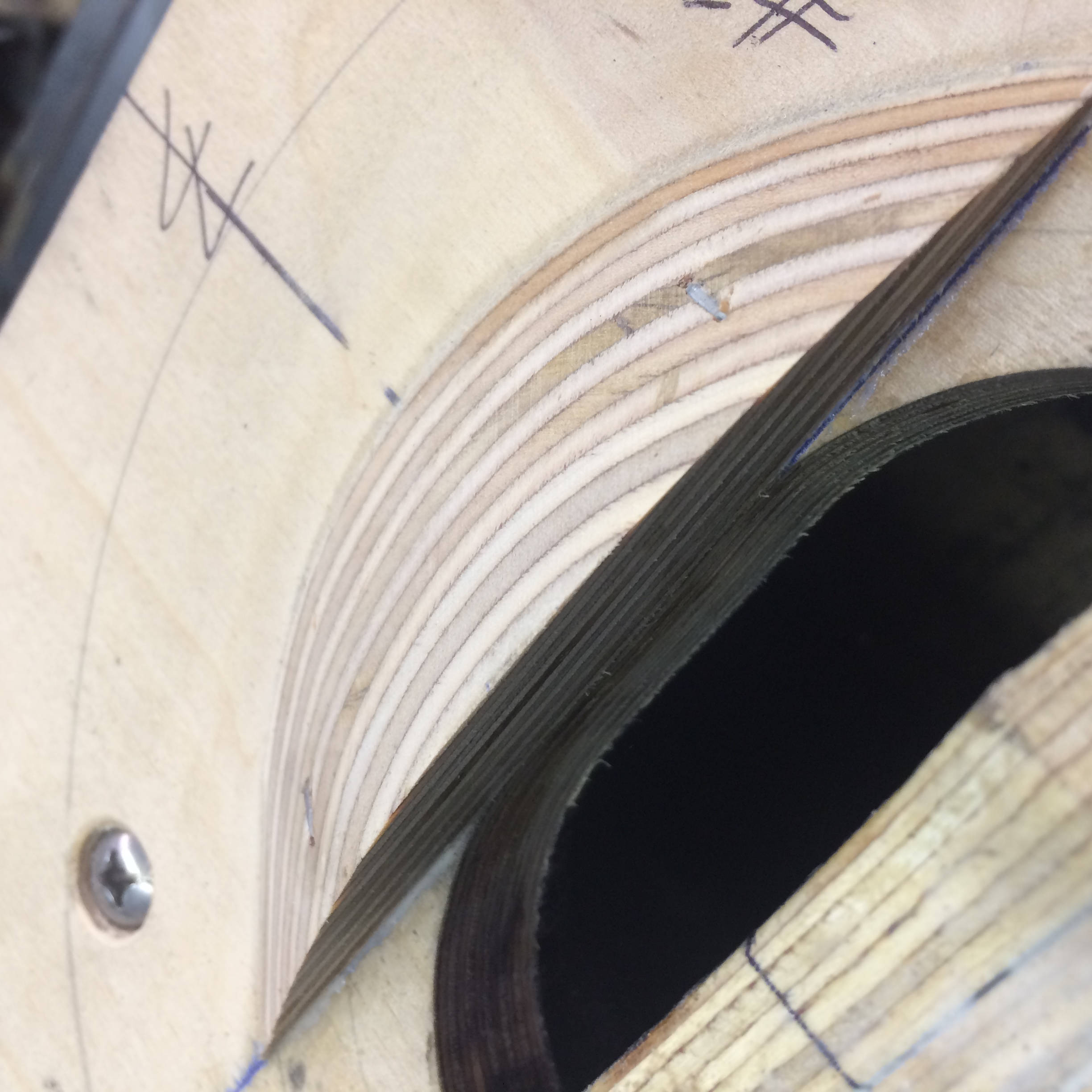

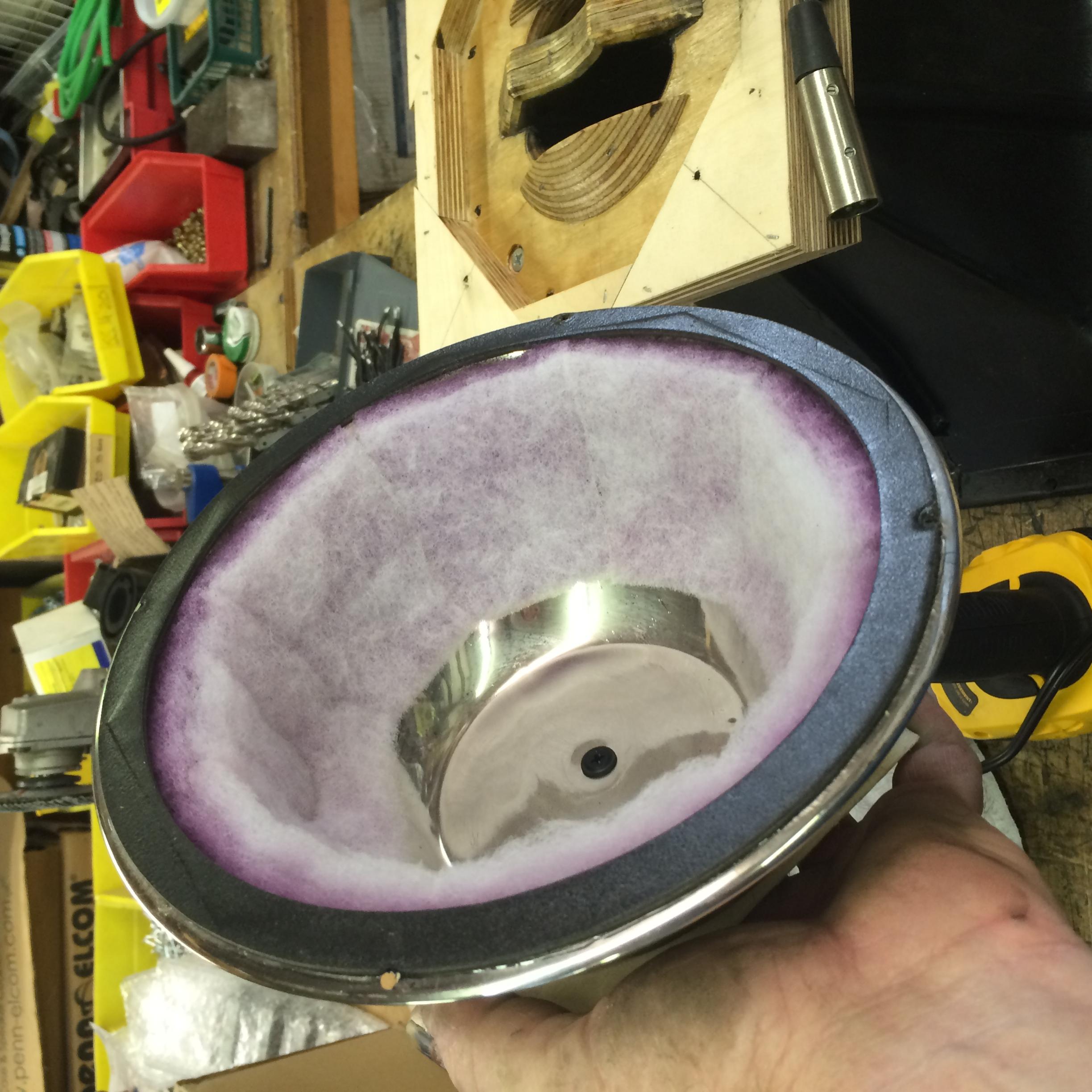

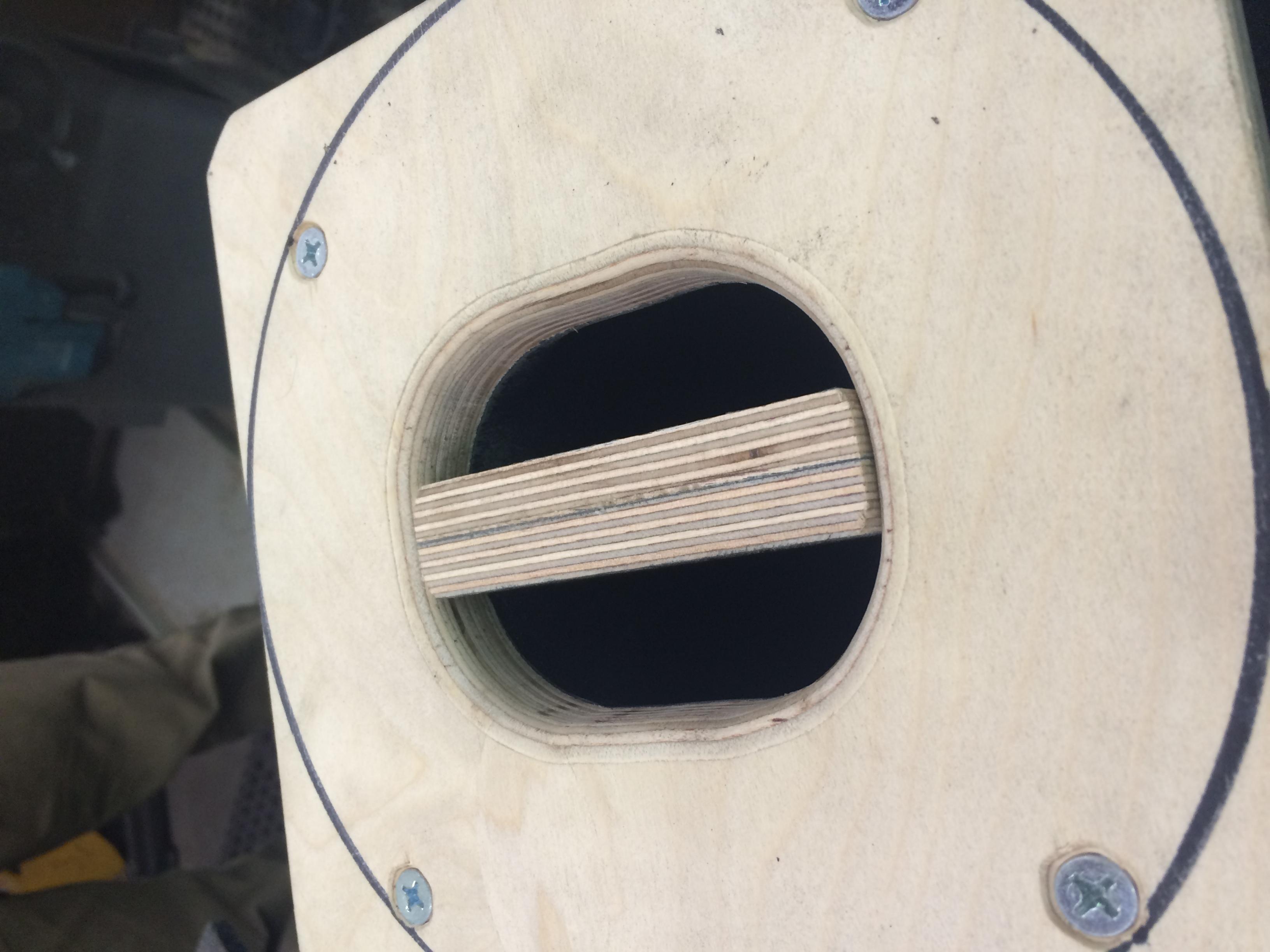

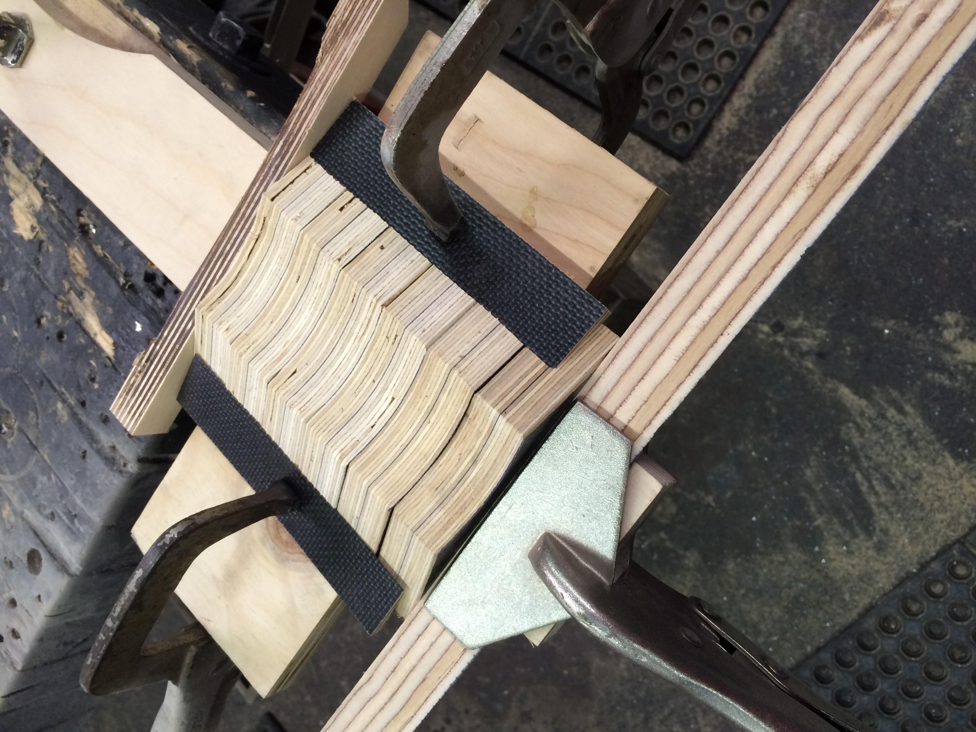

Aperiodic Wave Guide build
The biggest problem I heard with the factory horn not having a phase plug was it's "beaming" on center and the associated phasing when the boxes are arrayed in the triad array I use the most. I went with a center rib to help stiffen the horn itself and a rear center dividing plug. Those had to be in 2 pieces. Then I designed the remaining phasing plug in 2 separate L/R hemispheres. These were most difficult to make and get identical shapes (12 required).

Back Cap and speaker Standoff
Ah, the finale.
The back cap is a deep Stainless Steel salad bowl off Amazon.
I didn't want the speaker shearing off the screws if the box got dropped, so I made a speaker standoff 3/4" thick. That also gave me a way to get the wires into the driver chamber in a airtight way. The stainless got some air filter (polyester) acoustic treatment and since it was quite thin metal and wanted to ring, a damping square of 13ply (4 x 4) screwed and urethane'd to the back of the bowl solved that.
This is a very intense woodworking project and isn't for a beginner. There are lots of photos of jigs and table saw cuts that would not be of interest to most folks, only "sawdust heads". I'll be glad to share those with whoever is interested.

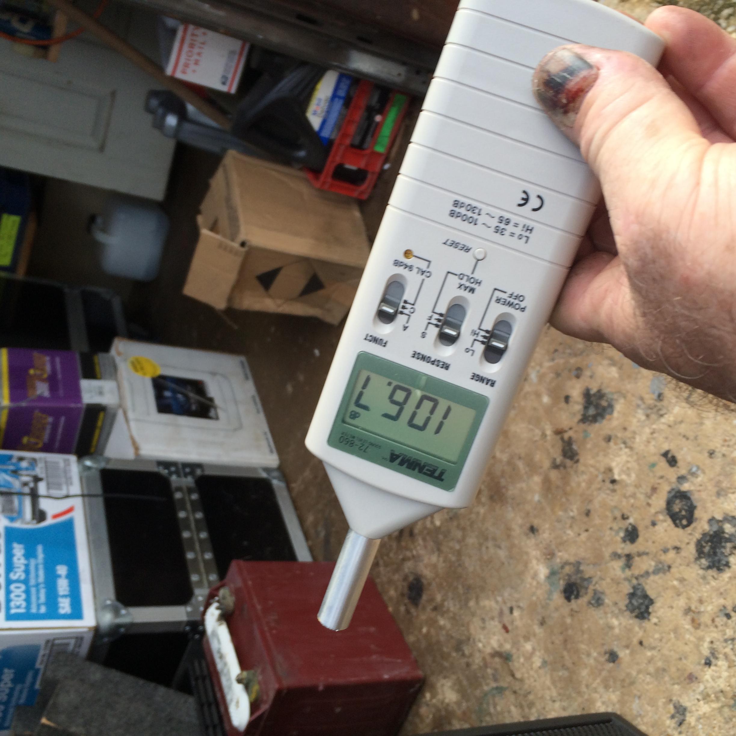

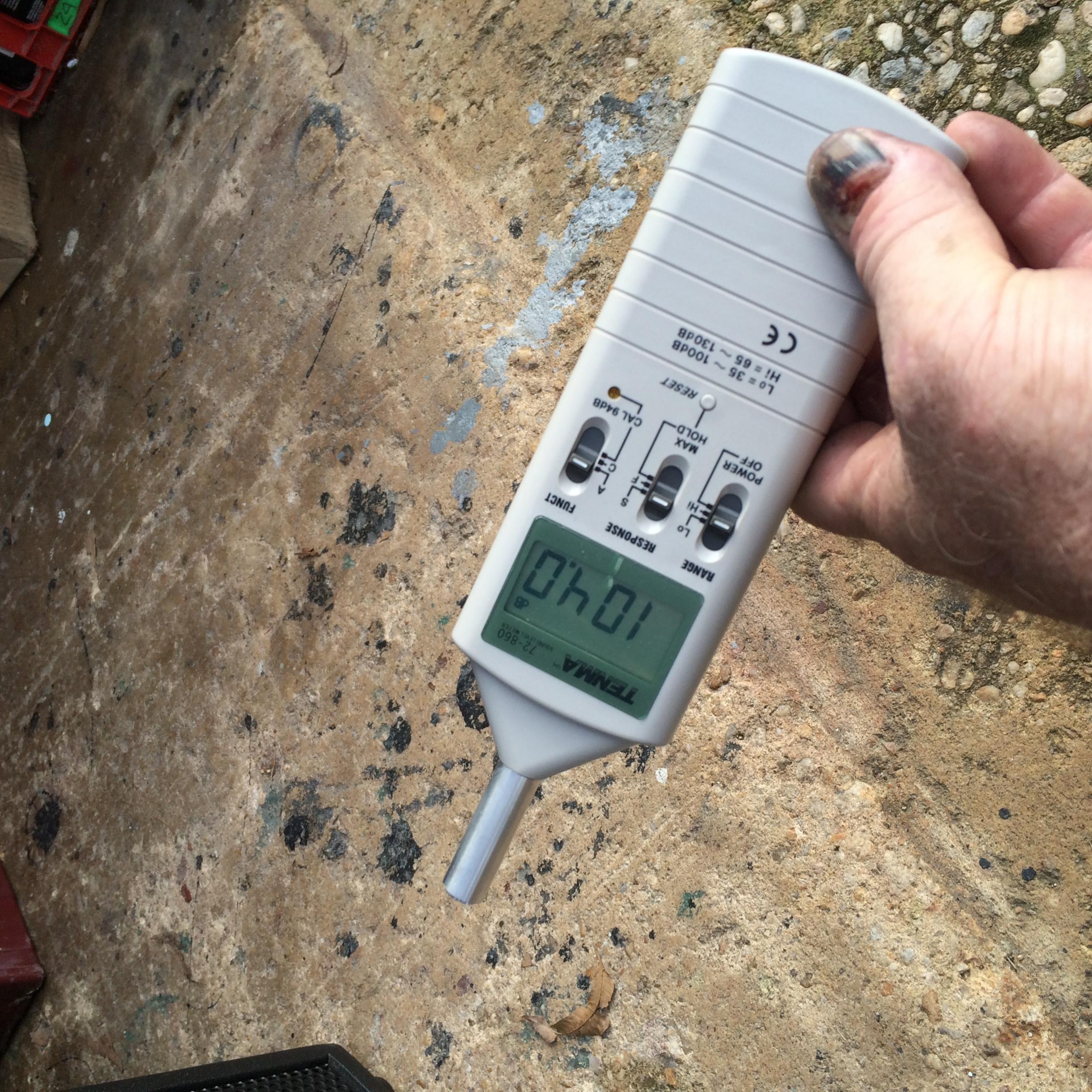

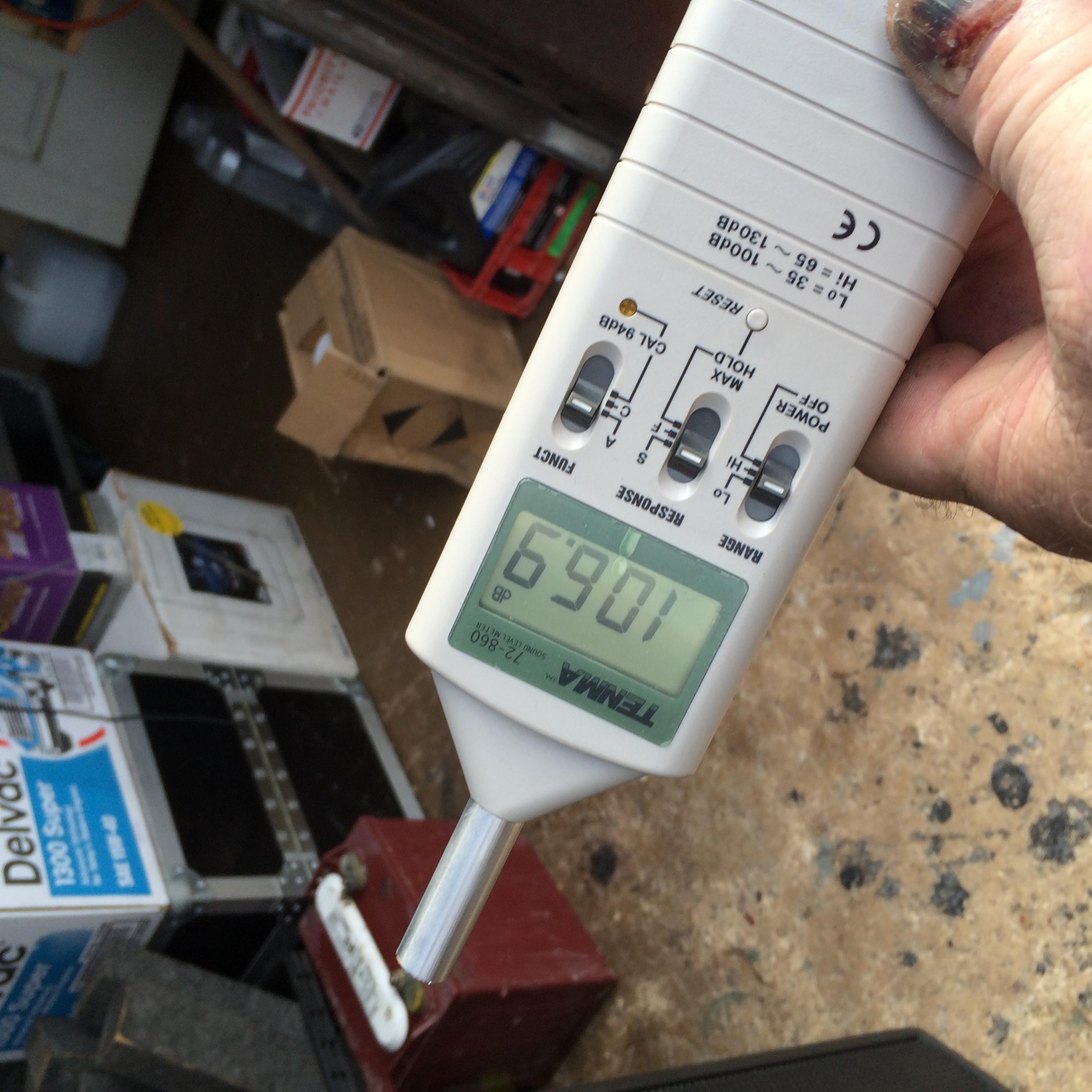

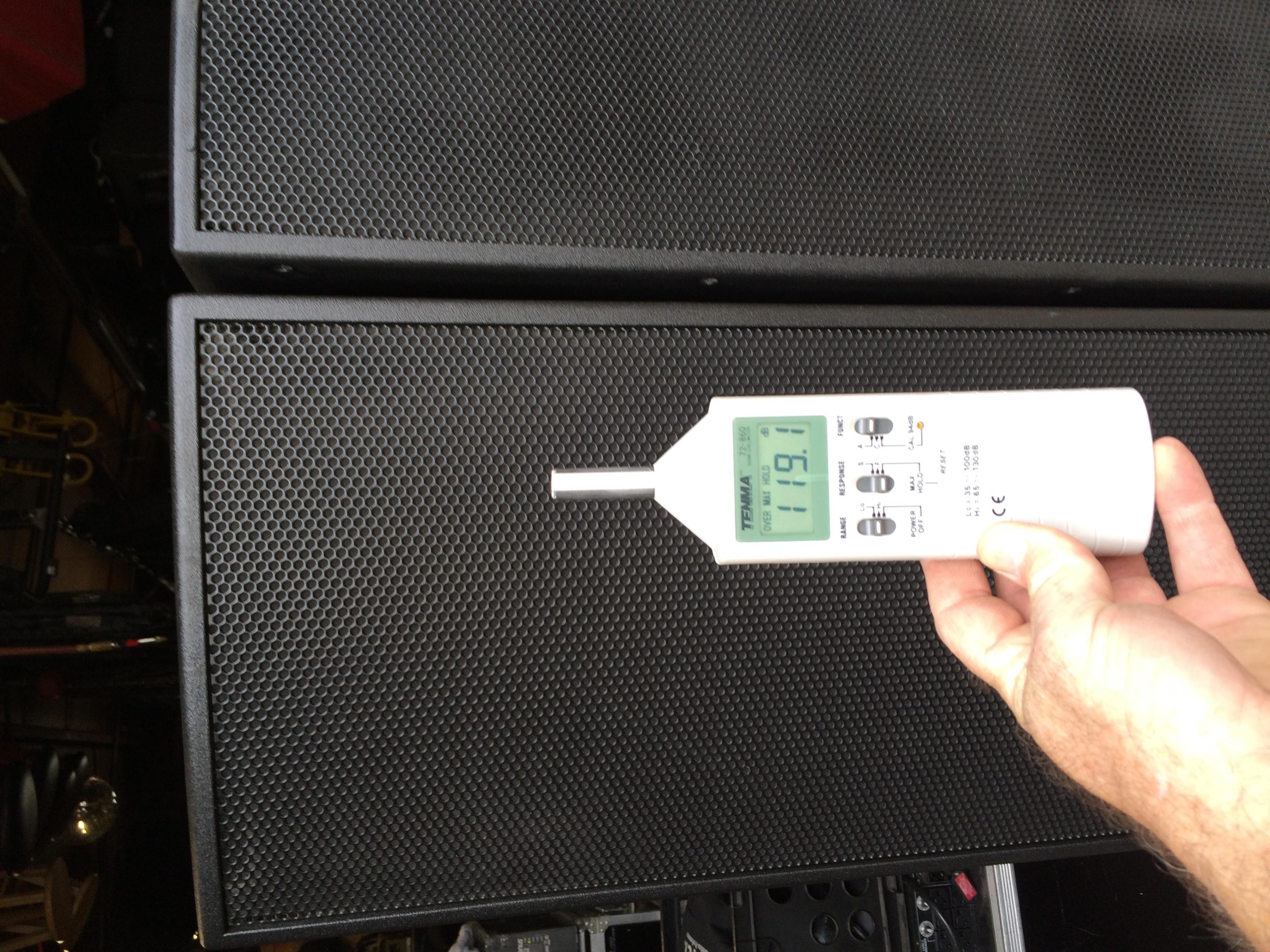

Testing and measurements, final thoughts, last call..........
I should probably add this is just the L/R cluster. 99% of the time I run subs on the center channel or an Aux of the M-32, so an ensemble of powered 18's (QSC 181's) go out with this rig. How many is dependent on the style of music.
Here's a pic of the dB meter during testing. The amp is hi-passed at 100z and the meter was still in the green LED's with this measurement. Measured amp draw was 7 amps at 120V RMS. Program was music, not pink noise.
Each NL-4 at the amp measures 2.4 ohms electrically on the lows and the highs.
Each side of the PA gets a single 10Ga. NL-4 cable with metal Neutrik 50A connectors.
All the short jumpers are 90 degree and can't fall loose.
Never though Class D would sound that good. I was wrong.

I'm putting up another pic to show how I arrived at the shapes in the horn throat.
I figured x-max times 3 for distance spacing from the cone of these shapes. That was just in case any LF just happened to get to the mid-driver.
Some design I've done was just guessing at what looked "right" and the materials I have available. I suppose if I could form fiberglass as easily as I can saw wood, and done a ton more research, the forms would have been different
in the throat. All told, I've spent about 2 weeks in the shop on this little project.

I reconed some Dl15s last year so I know what you mean about the frames, but these are lowend drivers IMO.. I had assumed all QRx boxes would have the EVX drivers like the subs. People slag on Eminence drivers but those neo Kappa/Delta drivers are a work of art.. I have some DeltaLite 2512s in some home brew tops i built a couple year ago and I have never had any problems with durability with this brand.. when the drivers are used within their limitations of course.
That is interesting about the phase plug, it's a relatively small piece but the shape isn't simple so creating a mold to make copies makes sense especially when you want quantities. Did you orient that vertically in the horn? Does it improve response in the both horizontal and vertical planes or did you measure that?
shapes

The vertical orientation came from not wanting to get into their 10 degree down-fire horn shape, AND it's just easier to do vertical.
I realized I could make the situation a whole lot worse if I didn't keep it simple.
Measuring a single box and taking dB readings in the coverage pattern it was pretty obvious there was about a 2dB on-center hot spot about 10 degrees wide up close (within 20' of the box). I did that outdoors with a 100db pink noise level, mostly at that 20' distance from the box. I'd noticed the hot-spot in ballrooms before, but had no opportunity (time) to SMARRT it with any accuracy.
Then, with the grills off the boxes and looking at/listening to the array, I could see two different 8" cones at the same time (the way the factory had it). And I could point a laser into the opening and hit quite a few spots on the 8" cones (left hemisphere, dust dome, right hemisphere) I was hearing at the same time. It was at that exact spot the phase problem was at it's worse (destructive interference).
I presumed there were many different arrival times in that spot causing the problem and figured if I could move the summation point further out into the horn throat, that issue would be mitigated a lot.
I also realized the Eminence driver was VERY efficient (FS of 514Hz) and a phase plug would give me some lost efficiency BACK in that passband.
Measurements now show I'm about 2 dB LESS sensitive than with the old factory driver, but I was making 6-8dB cuts in the processor graphic to try and lose the "awk" between 500 and 1K.
Since I split the horn vertically, the vertical response shouldn't change much.

The shapes I used were quite hard to make duplicates of. The prototype was one thing to decide on, making 6 or 12 exact duplicate parts of one another was what puts the difficulty of this project up a notch. It was WAY time consuming, and I've worked wood for a long time and have an extensive shop.
And yes, Baltic Birch is dense and hard as heck. Requires horsepower, some sharp carbide tools, and a lot of sandpaper.
And determination to keep your fingers.................

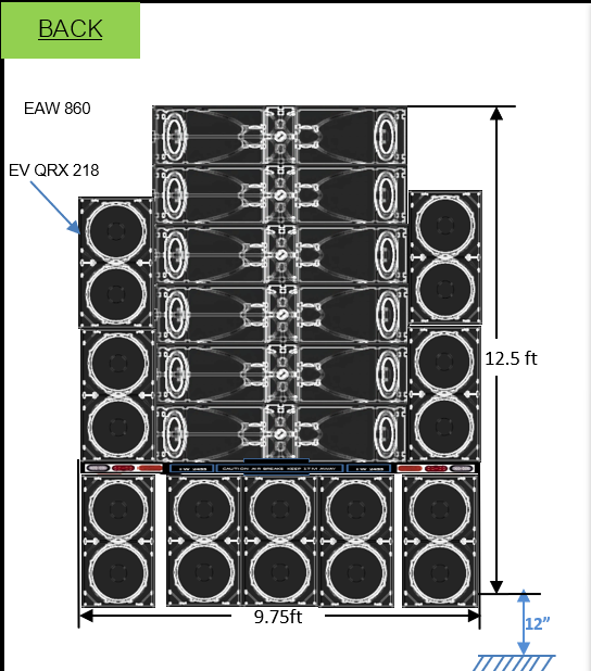

That IS my small system.........
The larger rig is a 32 box NEXO Alpha and the system beyond that is an 48 box EV Xlc rig. I'm trying my best to make the smaller system sound more like the NEXO.
That rig spoiled me..............
105dB is "A" weighted at FOH mix position averaged.
Make no mistake, 105 at FOH is pretty good. I don't want to beat that small system much harder than 120dB 1M from the box. It looses it's tonal balance above that and starts to sound "washy" at the two box junction lines.
That situation has been WAY diminished with these mods to the boxes, but it's slightly there at the higher SPL's. Most of the time, it's not run that hard at all.
Don't want it to sound like I beat it silly every weekend.
The array sounds very pleasant from 105 on down and it covers 110 degrees horizontal. That's all I need to ask of it.
Thanks for the compliment, it was an adventure and I learned a lot about mid-horns. It just took an investment in time and some fairly expensive mid- drivers. I'm lucky to have the wood shop I do.
Ah yes, I've worked on Nexo Alpha for a few years at a local venue. 5x M3, 5x B1, 3x S2, per side, in an 800 capacity nightclub. Pretty loud.
We kept blowing breakers, though, because 3x B1 in parallel drop to about 1ohm at around 100Hz. The Camco Vortex 6 was happy to provide the power. The circuit breaker really wasn't.
If this is your small system, that makes mine a 2-channel monitor rig.

That Alpha system stays in a 2,000 capacity room. Way more PA than is needed but the WoW factor is what is required for acts to be happy. They can get as loud as they want for soundcheck, BUT, we throttle them back to 105dB at FOH position for the show so people don't lose hearing standing next to the stacks.
It's still my favorite "desert island" PA for tone and bandwidth.
Nexo life.................

Hi guys I am from a country call Trinidad and Tobago. My system is pretty large 32 QRX 218 12 EAW 860s and 8 Smaller line arrays. My system is fixed install on a 40ft Trailer
I am looking for advice on the way I configured my speakers on the back of the trailer. The picture will show the configuration.
My concern if the bass is not loud as expected. I don't know if the configuration is the reason. Please note this is a space limited installation
