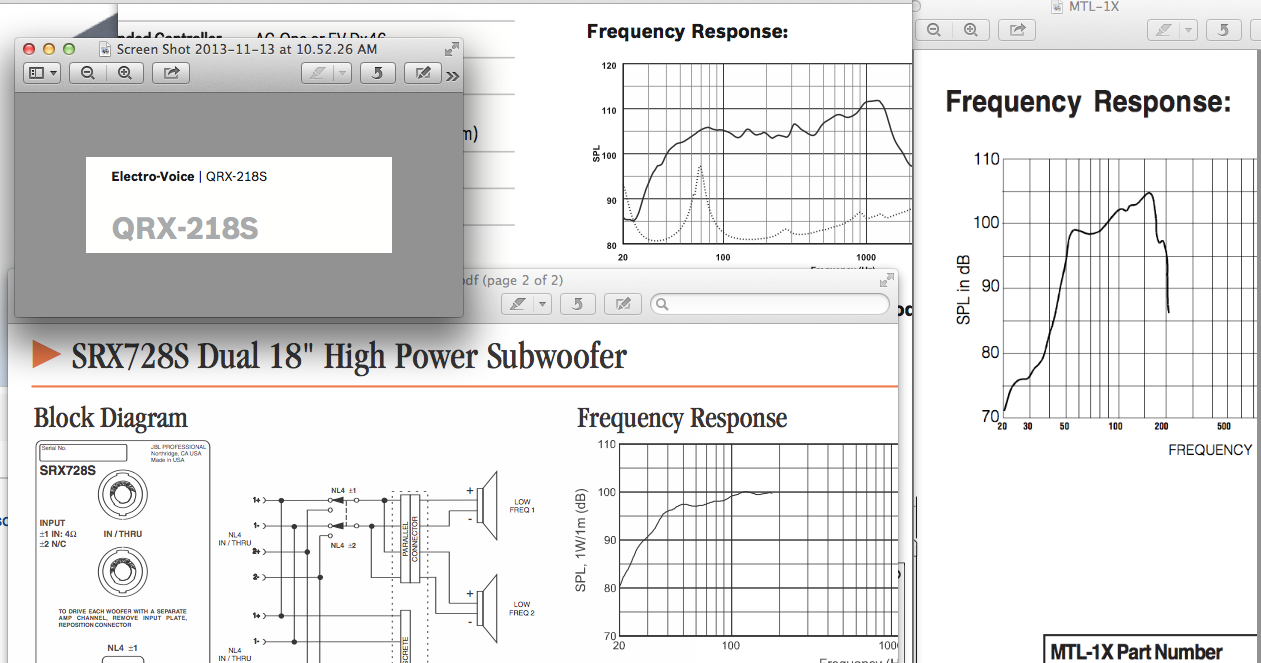

You can see in comparing the dual EVX 180B loaded QRX-218S bass reflex cabinet to the dual 18 MTL-1X that the BR has better sensitivity and actual LF extension, 100 dB at 40 Hz compared to only 83 dB for the MTL-1X.
The QRX-218S has around +4 dB sensitivity at 40 Hz over the JBL SRX-728.
However, the JBL SRX-728 uses drivers with more excursion (2268 has 8mm Xmax, 23 Xmech) and better power handling than the 6.4mm Xmax EVX 180B.
Granted, the JBL requires more power to get loud, but given the power, it will go louder.
A speaker with double the displacement has 6 dB greater low frequency output, assuming it can handle the power.
How loud a speaker can go is not just determined by sensitivity, but by displacement and power handling, how well the driver dissipates heat.

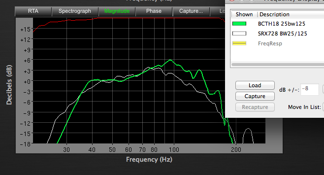

The BC18SW115-4 loaded Keystone has very similar sensitivity to the SRX-728, but due to the more capable driver, can put out more level.
The measurements below were done with the same drive level at two meters using 25 Hz BR 125 Hz filters.
As an actual real world example, on side by side stages I compared the output of four of my dual Lab 12 BR cabinets to eight Meyers 650P subs per side.
The Meyers 650P probably has fairly similar output to the EV QRX-218S.
The headliner (Michael Franti & Spearhead) frequently pushed the 650P subs into TPL (TruPower limiting) and Excursion limit. The spectrum was 60 Hz boom boom, about 6 dB more 60 than 40 Hz, which corresponds with the cabinet’s continuous rating and spectrum.
At FOH, about 125 ft out, the system was hitting 108 dBC, the hard limit, no extra VU swing resulted in any more output, though it did sound crunchier..
My stage was doing dance groups with recorded music and one live act. On the last dance group, with some fairly heavy LF content, my four 2x12” front loaded subs were hitting 104 dBC, spectrum looking pretty equal from 40-80 HZ.
+2 dB at 40 Hz, -4 dB at 60 Hz. Not bad compared to sixteen 18".
One Keystone has similar sensitivity at 40 Hz as two of the dual Lab 12, but almost 6 dB more output at 100 Hz. It has far less power compression, and more excursion, so given the same power, even more level.

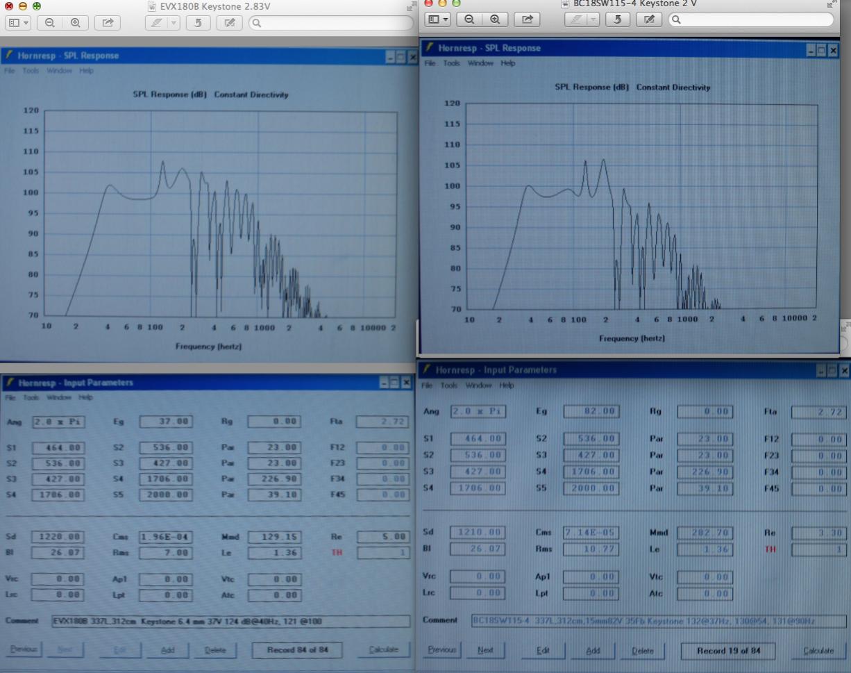

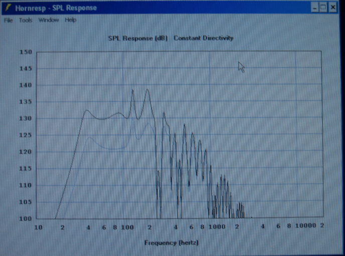

I am very familiar with the EV line, have been using their drivers since the early 1970s.
The EVX series was a big step forward when it was released almost 30 years ago, but it has been far surpassed in output (and cost per dB) by other drivers.
1)The Keystone TH design is almost 6 dB more sensitive than a "traditional reflex" of a similar size.
2) It uses a four ohm driver.
3) It uses a driver with almost 3 times the displacement of the EVX 180B.
EV's QRX-218S "traditional reflex" beats the MTL-1X in both extension and sensitivity below 100 Hz. As far as scoops or horns, the MTL-1X is lame.
I have not directly compared the Keystone to the EV cabinets, but I have compared it to the JBL SRX 728, which has been featured in sub shootouts, so the relative levels can be compared, and you can draw your own conclusions.
In speed trials, if car "A" beats car "B", and "B" beats "C", we know "A" beats "C", same holds true for cabinets.
However, as we know from car racing, there is no replacement for displacement, for A B C to compete on a level playing field, they all need to use the same 426 cubic inch format.
Here is where the real difference comes in, the BC18SW115-4 has almost 3 times the displacement of an EVX180B, like comparing a single 426 Hemi to three of the same.
In post #29 you can see EV's measured response of the dual 18" MTL-1X and the QRX-218S.
You can see JBL's measured response of the dual 18" SRX728.
You can see my measured response of the JBL SRX728 and the BC18SW115-4 (the 4 is for four ohms) loaded Keystone. These tests were done using the exact same amplifier output voltage in the exact same place, the unused cabinets moved away and shorted to avoid any influence on the test.
All the cabinets are four ohm, both JBL and EV use a 2 volt output in to nominal 4 ohm cabinets for their one watt test. Both companies have reputable and repeatable test procedures. The cabinets have been in sub shootouts, so we can compare them to the factory specs, and we find them to agree.
From the above sensitivity information, all from actual tests, we see this:
EV QRX-218S 100 dB @40 Hz, 105 dB @100 Hz
EV MTL-1X 83 dB @40 Hz, 100 dB @ 100 Hz
JBL SRX728 96 dB @40 Hz, 99 dB @100 Hz
Keystone 98 dB @40 Hz, 103 dB @ 100 Hz
So at one watt, we can see the bass reflex EV QRX-218S clearly kills the EV MTL-1X.
The BR design is smaller with more output, simply a better design in all respects.
The Keystone uses a less efficient driver, but is only 2 dB less sensitive than the QRX-218S, and is between the two for size.
As we know, what happens at one watt has little to do with ultimate output, which is determined by displacement and power handling.
All the cabinets are displacement limited below Fb (box tuning frequency), which for the EV MTL-1X is around 50 Hz (drops like a rock below), the BR and Keystone around 36 Hz.
At Fb, all the drivers are thermal limited.
The BC18SW115-4 handles 1700 watts, 1600 watts for the JBL SRX728, 1200 watts for either EV cabinet.
Roughly 1/3 octave above Fb, the cabinets run in to displacement limits before thermal limits. The JBL driver has only slightly more Xmax and power handling than the EV, so it has slightly more LF (excursion limited) output, but around 4 dB less output at 100 Hz (thermal limited).
Since the EV MTL-1X is the same sensitivity at 100 Hz, but less power handling, the SRX 728 has about a 1 dB advantage at 100Hz, and around 15 dB more output at 40 Hz.
Comparing the Keystone to the SRX728, thermal limits are similar, but the BC18SW115-4 has nearly double the excursion (2.5 times more than the EVX) and better sensitivity, it has more than 6 dB more output at low frequencies and about 4 dB more at 100 Hz.
Back to the EV MTL-1X, the Keystone has about 21 dB more output at 40 Hz, and 3-4 dB more output at 100 Hz.
By any metric, the Keystone beats the MTL-1X, but since EV's smaller bass reflex cabinet also does, not hard to do.
Art

EV's measurements clearly show the EV MTL-1X to be less sensitive than their bass reflex cabinet using the same drivers.
The Keystone tapped horn design is about 6 dB more efficient than a BR, which equals the +3 dB in doubling cone area and +3 dB power of a dual BR design.
My observations are not based just on one watt sensitivity ratings, they are based on high powered real world testing and comparisons to other commercially available cabinets as well as my own designs using EVX speakers.
You can see the results of sine wave testing at 77.5 volts (1500 watts in to 4 ohms) in post # 12 here:
http://www.diyaudio.com/forums/subwoofers/185588-keystone-sub-using-18-15-12-inch-speakers.html
Distortion averaged only 5.438 % at that power level.
I have fed the Keystone 120 volt 60 Hz sine waves (3600 watts). With music or pink noise 4000 watt peaks are no problem for the B&C 18SW115, though I have seen DJs take out the EVX drivers with 600 watt amplifiers.
The B&C driver gets rid of heat far better than the EVX, it has less power compression, so at high power the advantages become more pronounced.
Between Electro Voice's tests and my tests the evidence clearly show that the B&C loaded Keystone has a higher sensitivity below 100 Hz than the EV MTL-1X.
Given the fact that the B&C loaded Keystone is 15 dB more sensitive at 40 Hz and 3 dB more sensitive at 100 Hz than the EV MTL-1X , and has more than double the excursion (+ 6 dB) handles more power, and has less power compression, it is a no- brainer to guarantee that it can go much louder.
What makes you think that a cabinet with higher sensitivity, more power handling, and almost double the excursion would not have more output than the lesser rated speaker?
Art

The EVX 180B is more efficient than the BC18SW115, the fact that the Keystone is more sensitive than the EV MTL-1X is because of the cabinet design, not the driver.
Hornresp sims say the EVX 180B in the Keystone is 2 dB more efficient at 40 Hz, but ultimate output is 8 dB less at Xmax ( 6.46mm vs 15mm). The sims don't reflect the upper response of the Keystone correctly, the real cabinet show more SPL in the 100 Hz region than at 40 Hz.
That said, the sims predict the EVX 180B only requires 37 Volts (171 watts) to hit Xmax, while the BC18SW115-4 requires 82V (1681 watts), 10 dB more power for 8 dB more output.
If you used a pair of EVX 180B loaded Keystones, they would come within 2 dB of the LF output of one BC18SW115-4 Keystone, and would only require 1/5th the power.
And they would probably smoke a pair of EV MTL-1X in the LF, even in Jamaica, mon 🙂.
Art
