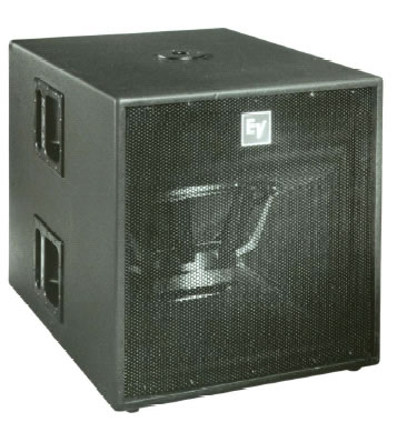

OMNIFEX,
In your previous post you did not give the proper model number for the Phoenix PX2181, you called it an EV 2181, which is not a valid EV model #, so I could not find specifications.
Closest thing I found using the EVX180B was the EV QRX-218S, the specs of which I listed.
Now that you have given me the proper model number your wish is my command 😀.

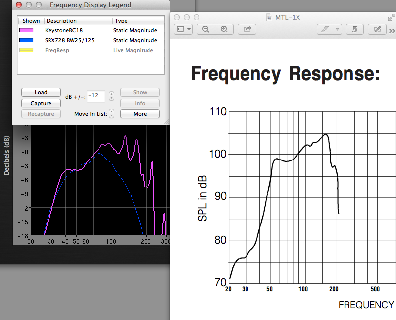

Per your request, the Keystone compared the Phoenix 2181 are below, "0" on the Keystone measurement is 100 dB.
The EVPX2181 uses different drivers and cabinet design than the MTL 1X, and has a much improved response, though it is larger and has less output potential than the EV QRX-218S.
I have not found TS parameters for the DVX3180 drivers used in the EVPX2181, but having lesser power handling, lets assume a similar or slightly less excursion capability until proven otherwise.
So now, the line up for sensitivity, excursion and power looks like this:
EV QRX-218S 100 dB @40 Hz, 105 dB @100 Hz (6.4mm Xmax) 1200 watts
EVPX2181 95 dB @40Hz, 105 @100 Hz (Xmax unknown, probably <6.4mm)1000 watts
Keystone 98 dB @40 Hz, 103 dB @ 100 Hz (14mm Xmax, 16mm Xvar)1700 watts
EV MTL-1X 83 dB @40 Hz, 100 dB @ 100 Hz (6.4mm) 1200 watts
JBL SRX728 96 dB @40 Hz, 99 dB @100 Hz (8mm Xmax) 1600 watts
Doubling power up to reaching Xmax allows +3 dB untill the voice coils heat up and power compression sets in.
Doubling Xmax allows 6 dB more output.
As is obvious to any one that has been to, or looked at the results of a sub shootout, (which I have conducted many times), a sub with the same sensitivity but higher Xmax is louder when given more power.
Subs will in general "flap" and distort when hit with power much below F3 or pushed above Xmax in their usable pass band.
Subs pushed above their AES power rating generally suffer from thermal compression, more power does not make them louder, and eventually burn up.
Using the above observations and some common sense, it does not take a rocket scientist to predict the outcome of a high power shootout for the above subs, it would look like this:
1) Keystone
2) EV QRX-218S (slightly louder lows and softer top at low power levels, above 1200 watts Keystone takes over at 40 Hz)
3)JBL SRX728 (+3 at 40Hz and below, EVPX2181 + 6 in the top end)
4) EV MTL-1X (- 13 the low end, -5 dB in the top )

One Chart (TEF, AP, or CLIO) showing your Keystone box with an Electrovoice MTL 1X or Electrovoice Phoenix 2181
For example:
What I am not requesting
JBL Comparisons
EV Comparisons with the Exception to the MTL 1X or Phoenix 2181
1-watt/1metre charts from the manufacture
Xmax estimates
Simulator charts (Horn Response, Bass Box Pro, WinISD, etc)
If you cannot provide a chart as the one listed above, bring your box to a subwoofer shootout. It will not only give many the opportunity to hear your creation, you will have a TEF, AP or CLIO chart which will compare your box to the other contenders present.
