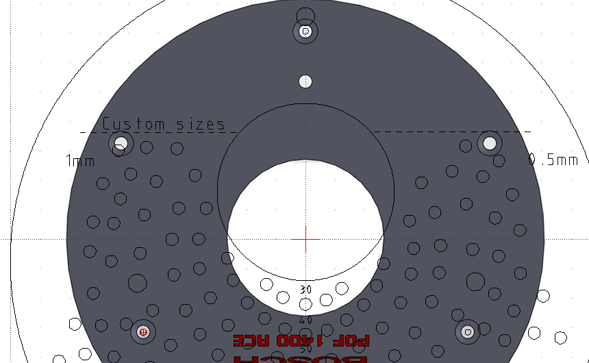

Hi, good questions.
The scales in the middle show the radius for a 16mm bit. If you use an 8mm bit, you have to subtract 16-8=8mm, so on a 8mm bit the 100 scale will actually be 92mm. The two sides from the center hole scales are 1mm and 0.5mm resp. That means the radius to the left where it says 1mm is reduced by 1mm for every consecutive hole. So, 100 - 99 - 98 ... 9N (so diameter changes by 2mm for each step). The 0.5mm solves the problem so they go to the right as following 100mm - 99.5mm - 98.5mm ... 9N.5mm, hence the even diameter numbers go to the left and the odd diameters go to the right. Every step is 2mm on both sides, just the left is even (so d= 200 (center), 198, 196...19N) and the right is odd (so d=200 (center), 199, 197, 195...19K).
The handle is any standard plastic handle (spherical ones work best) M12 bolt. I have threaded all, including the spare 4mm leading pieces holes (so you can keep them on the jig, I always lose them around in the mess whe nI build something). To make it work best, you may add a nut first which can then be tighted against the jig to provide counterforce and keep the handle away of unwinding when you rotate the router to cut the hole. See this one for example: https://www.kipp.com/gb/en/Products...elements/Grips-and-knobs/Spherical-knobs.html Such handles are easily available from shops specialized in selling bolts/screws amd are cheap, EUR2-3 each.
The handle I added as optional. The reason was that in some rare cases I would need to push the jig so it doesn`t lift off from one side. So I put this to add either a knob or a ounterweight. Gives more control but has a drawback - the cable of the router may become entangled into it and that would be annoying.
More to this, if you`re using like a 1000-1200W router, you might operate it with one hand but I wouldn`t recommend doing it. On more powerful routers just avoid using it and keep your hands on the router, a few months ago I routed a piece of hardwood with a 2kW router and on one occasion it pulled me like a toy, so be carefull if using this with a more powerful tool. I would really abstain of using the handle unless the job really requires it (sometimes I does, unfortunately).
As noted in one of the first posts, the jig will cut slightly larger diameters than the radius shown on it, by 0.5mm in diameter larger. Reason is tollerance is loudspeaker basket design. It should enhance fitting and will reduce any andpaper grinding required. That said, when you do a 200mm diameter, it should really be 200.5mm.

Can anyone confirm it fits well the Bosch series of routers? I had to transfer their base manually and would appreciate any input if it fits as required.
Chris, I have none left as this was a one off. However, I was asked by others for more jigs and I sent them the files. Would that work for you?
The jig required its 12 o`clock hole to be moved to the left and down, when it was perfectly symmetrical it didn`t fit the DW625 base. I got edition 5 of the router. There is a possibility that the casting is not precise enough but it could also be on purpose - mentioning all this to keep it in mind. Before to proceed, I would suggest to print the .pdf file which is a real size export of it, punch the holes and see if it fits your tool
I will post them on here anyways for download but want a confirmation that the jig fits well with the Bosch base.

I don`t understand, one of the recipients told me in a PM that it fits ok. I have attached the base of the POF1400 put against the jig below?
Are you mounting it using the screws that hold the plastic base plate (5 screws, 3 are used to mount it) or are you using the other 3 holes on the router base (these are for table mount)?
