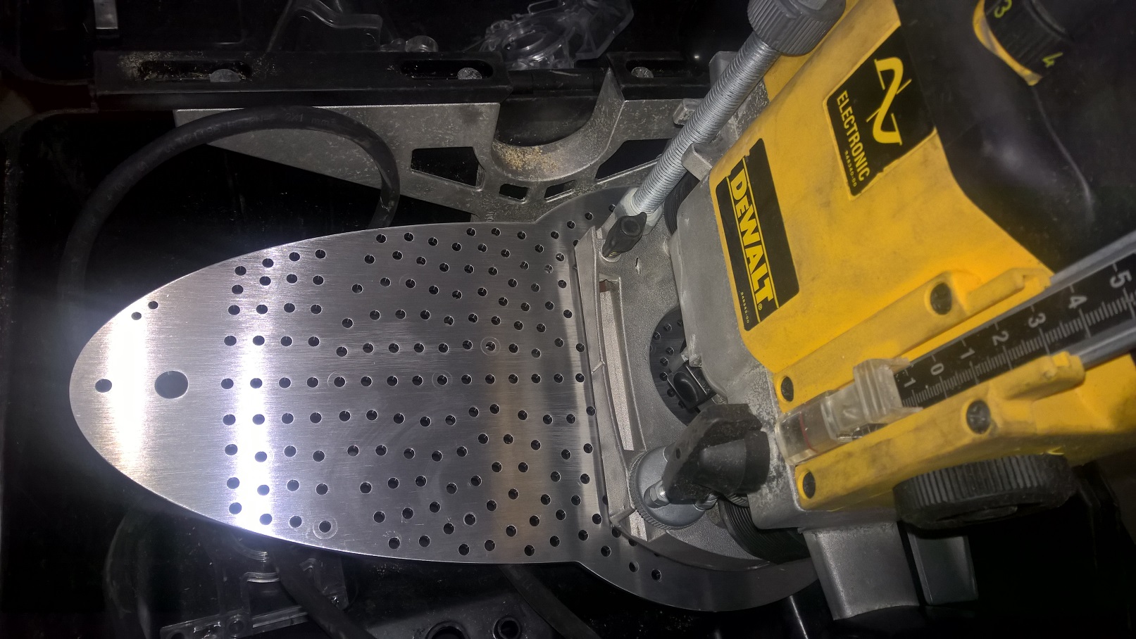

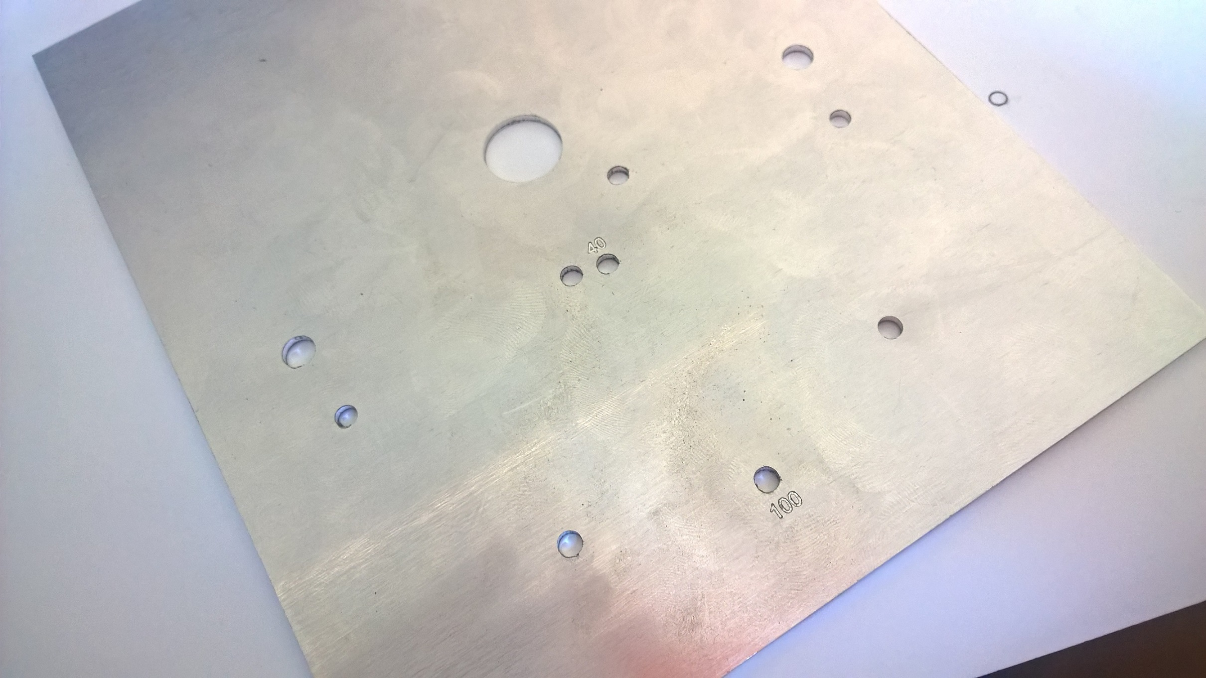

We made a test piece to verify how it fits, it does fit beautifully on the POF-range but for the 625/624 family required two holes to be moved 1mm away. The radiuses are correct, I asked for a few test holes. It is now finalised and I have confirmed the order with the aluminium cuting company. Sheet will be delivered to them on Monday so I expect them to be done by Friday.
The test piece has two engravings on it, here`s a photo of it - I think engraving looks nice. It is of 2mm aluminium, standard grade 1050 and it is stiff enough, we did overdo a bit with the 4mm high-strength one but thats the beauty of DIY 🙂

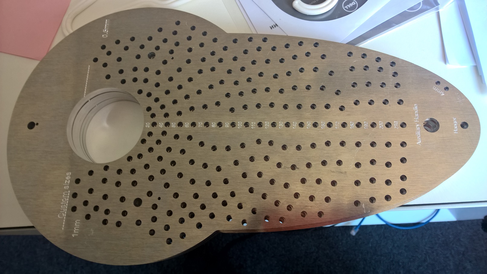

Got them, they`re with me in the office. Will post photos later today. Aluminium looks more like stainless steel. One bad new - the dashed line at "Custom sizes" is not centered properly. All else is prima. Pics - later today.

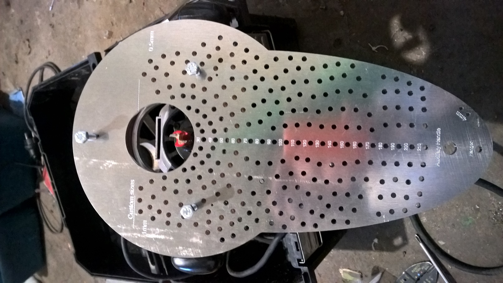

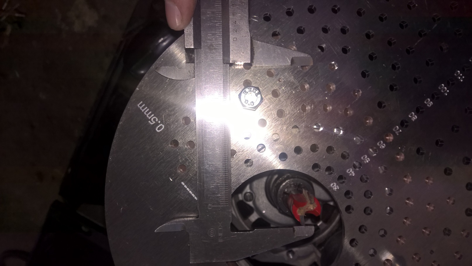

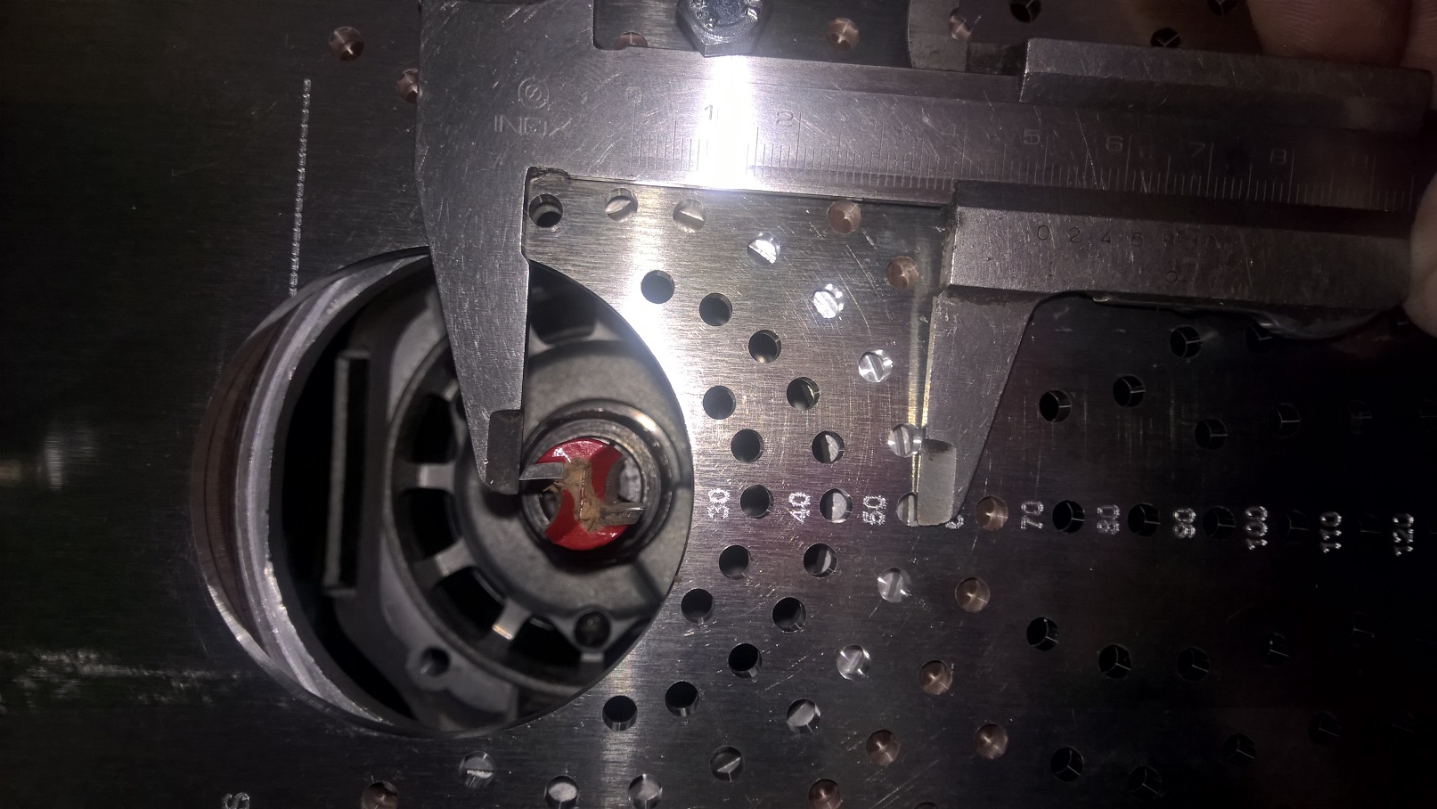

Here they are (not yet anodized). I checked with a 16mm router cutter and two random holes at 50mm and 76.5mm - spot on 🙂 I had to check who ****** up the dashed line (really not an issue at all but...looks non-symetrical now) - its not me, the routing company did, my file is fine 😀

Yes, 16mm is the default one. You can vary it, so if you go for a 8mm one, the radius will be smaller with 4mm (8-4=4) so you can cut even smaller diameters.
Hi Heinz, was very busy at the office and had little time if none to work on them. However, I managed to chamfer the mounting holes yesterday (didn`t work with the restrictors so I bought a chamfer tool we call a "zenker" here, looks like a 45 degree router bit). With that said, I am ready to bring them for anodizing, finally.
I had a question no one answered - what is the plate screw diameter on the POF routers? I don`t have one and found zero info (one website mentioned M4 but I need it confirmed). I need it to drill the holes for the router attachment bolts/screws, now they`re 1.5mm only (to lead the drill bit straight).

If it is the diameter of one of the 5 screws that holds the smooth brown phenol plate, I just measured them to be 4 mm

On the POF 1200 there are 3 holes that you can use to mount the baseplate to eg a jig. I use m6 screws with a cheap eBay circle jig.
Silasmellor
That's not the same holes we are talking about.
I am talking about the holes that keep the brown plate in place.
the other 3 holes are more like 8 mm Ø
The 3 holes you speak about are for router table mounting. I was referring to the base ones. I will predrill them today at 4mm on all then 🙂
