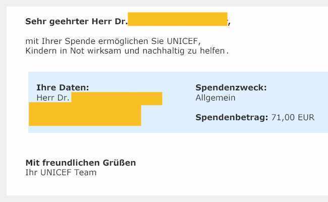

So finally I heard from everyone. All have received their FETs and seemed to be happy. I have arranged the donation of 71 Euros to Unicef to be done this week. So a satusfactory end to the group buy.
I have not received all the money from those who reserved the "left-over" FETs yet. So that part of the donation still to follow.
Happy soldering and group buy declared closed,
Patrick
