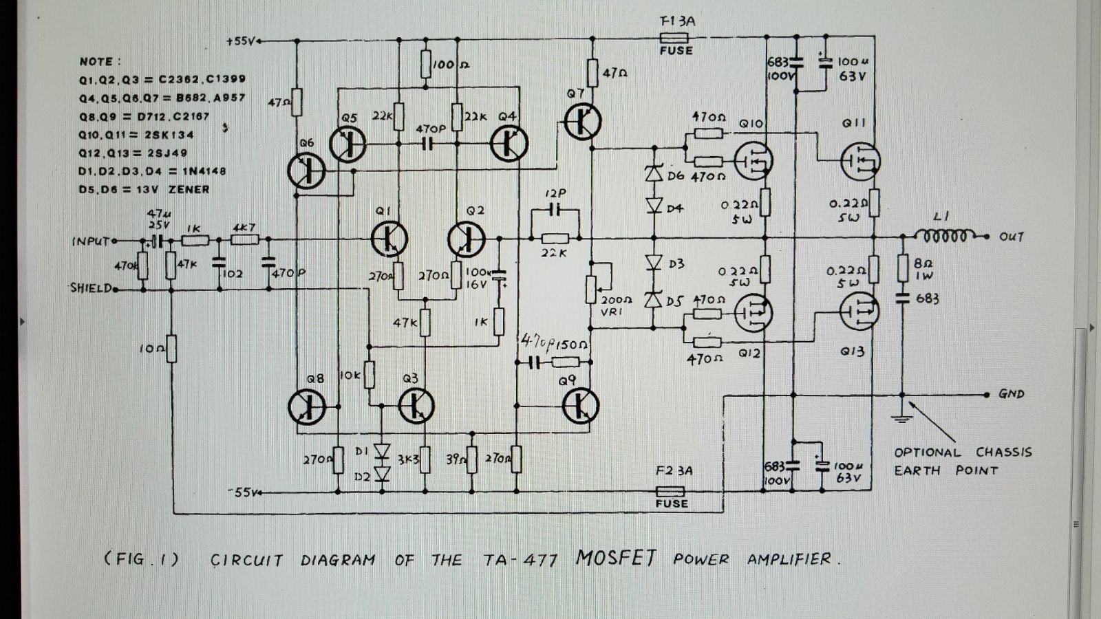

ta 477 kit
see attached

see attached
Thanks Arthur, I can see a few component changes in your schematic.
A couple of quick questions please.
The position of R16 and C5 are reversed and the voltage of C5 reduced from 25v to 16v in your schematic. Is there a reason for this ?
C6 (10pF) has been increased to 12pF in your circuit. (NFB)
Cap C14 on the base/collector of Q6 is increased from 220pF to 470pF in your circuit. Is this to stop oscillations ?
Gate drive resistors increased to 470 ohm
Gate clamp zeners increased from 12v to 13v .
Diodes changed to 4148's
C3 on the input leg has been changed from 330pF to 470pF.
C10 and C11 increased from 47nF to 68nF.
Values at output zobel(?) changed
I would be very appreciative if you could take the time to explain to me the reason why these values have been changed.
