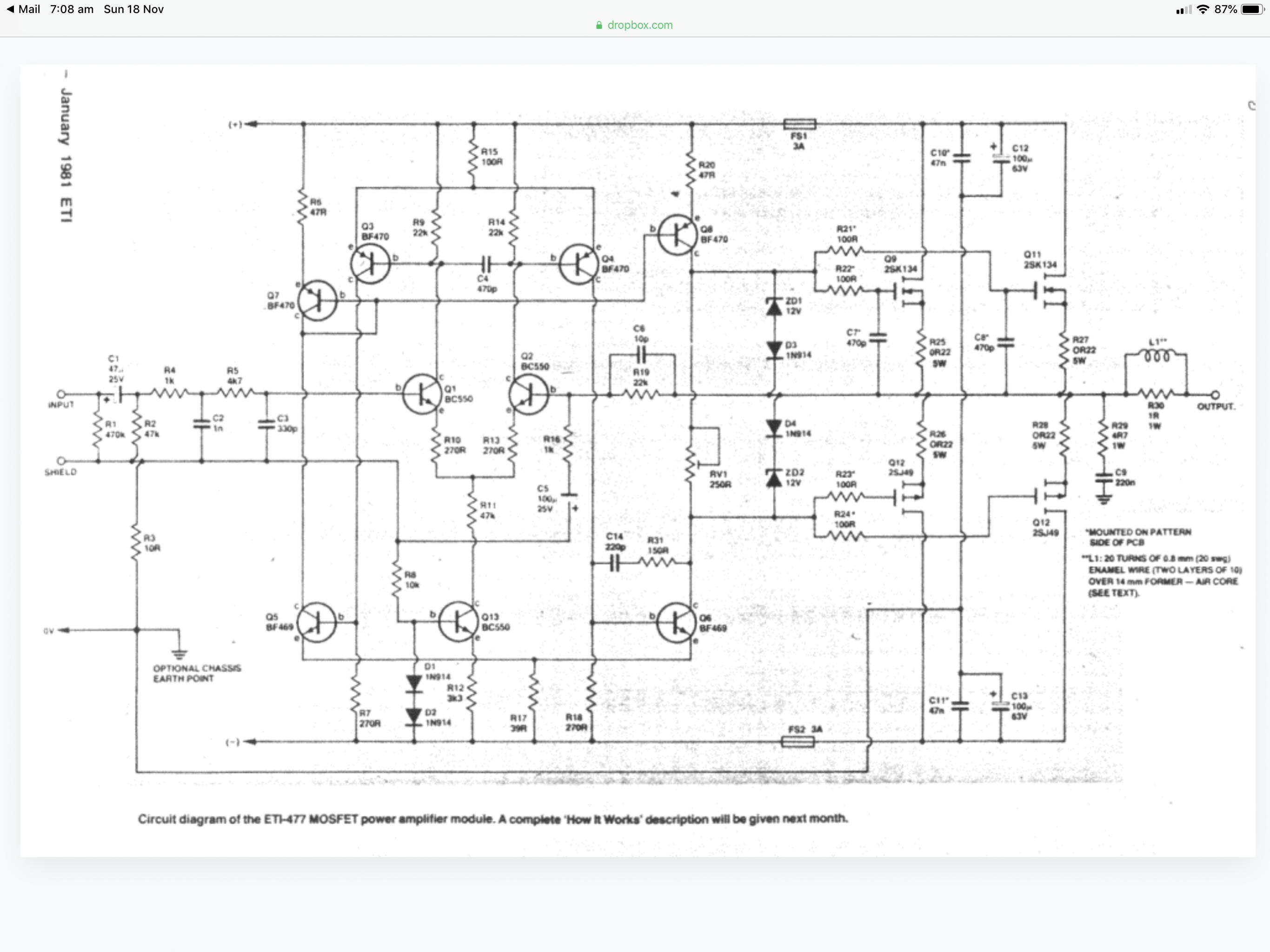

The zener goes between the collectors of Q7 and Q8, making the balance better between sides of the second stage diffamp.
Alternatively insert another 200Ω trimmer and adjust it so it so the two sides are equal.
Thanks for the suggestion Suzy.
Any chance you could elaborate on the details ? What needs to be equal ?
I am only a humble hobbyist with a good soldering iron.
A rough sketch of that part of the circuit would be all I need !
Thanks heaps
David
I was reading from a very blurry schematic. I meant Q7 & Q5. The zener ensures the dissipation in the Q5/Q7 pair is equal to that in the Q6/Q8 pair. A resistor would do similar. Adjust so the voltage across it is the same as that across the bias adjustment pot for equal dissipation.

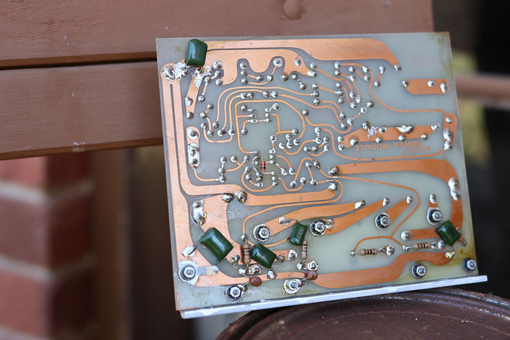

David, The image is of one of my boards. The one that did not get burned up.
The added Zener and cut track are visible. What may not be too obvious is an extended pig tail on the feedback resistor going to one end of the inductor.
Keith
Thanks Keith, your photo of the zener very clearly shows how it is connected.
The feedback resistor is a bit harder to make out but looks to me that it is now connected to the same point as the inductor ?
