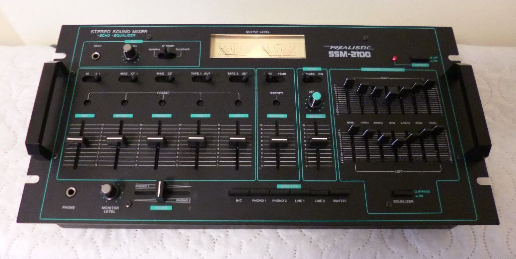

That big ETI-466 dual mono made me a lot of money in commissions and I will never forget the joy of manhandling it (the handles were spare part SSM-2100 Realistic mixer handles) into a cabinet with the sticky rubber feet I used. (I can't believe I remembered the model number of the mixer!)

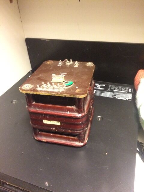

I will use a transformer at 49.5x2 Vac, Dont have the spec on it. I can upload pic tomorrow, a pretty cool one.

Wow, an industrial museum piece!
I thinks it cool.
anybody know if it has any value
2x49.5 volt and 1x16.5v
but maybe have plans for this in a build of mine.
can you tell us how it weighs in kg?
what is the primary dc resistance, and dc resistance of the secondary
windings?
windings?

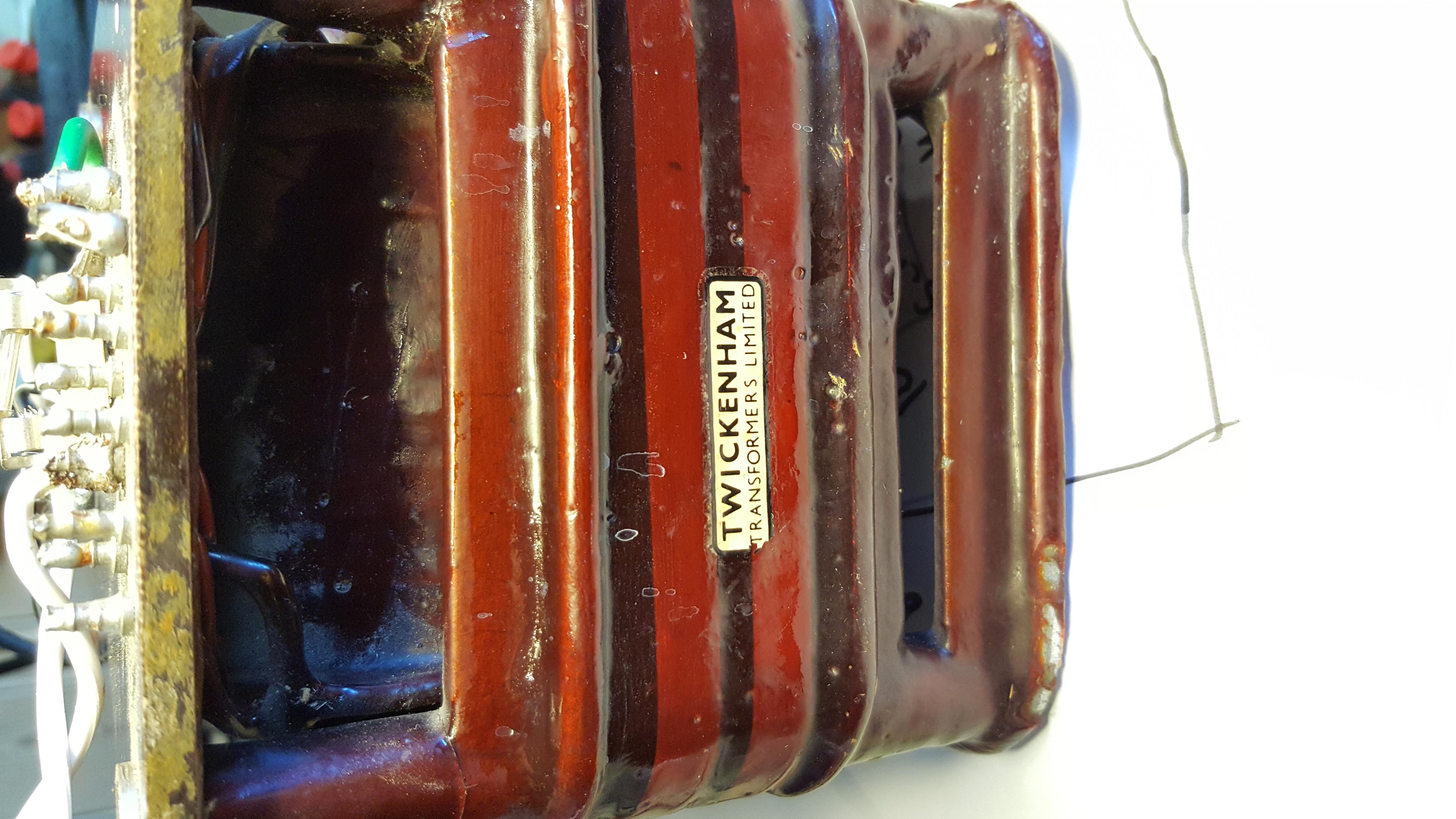

It does look cool, but I'd be concerned with the insulation and the condition of the wire in general. It must be 80 years old by the looks. It looks like a ceramic outer frame?
Get it thoroughly tested by a transformer winder.
twickenham
it weights 7,5 kg and the resistance is 0.2 ohm on secondary, and i belive it was 9 ohm on secondary, could been alittle more.
testet on a amp module and worked fine 🙂
windings?
Twickenham
It a iron cast around as frame, and it insulation i dont know but it Works good.

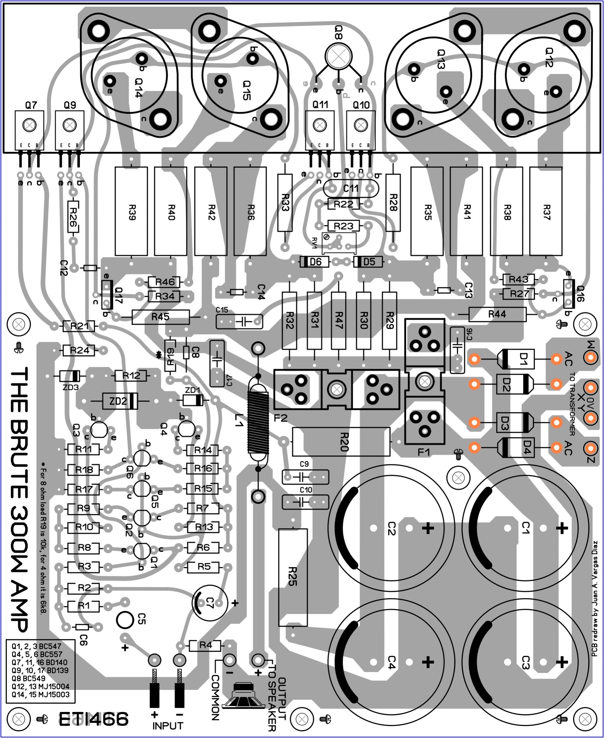

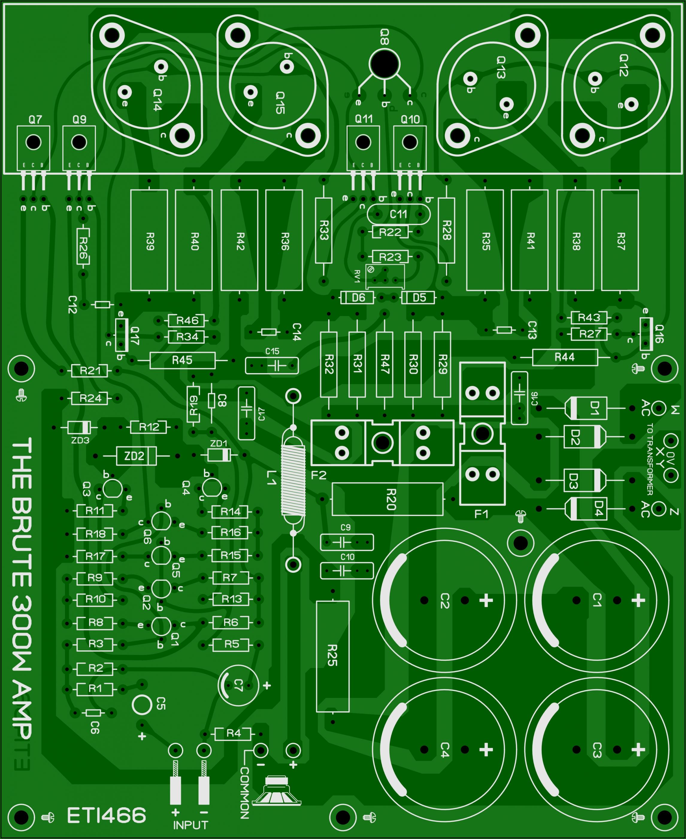

Hi a simple question, what is the value of the resistor that goes in parallel with the L1 on this design ETI 466?
That's unimportant, since it is shorted by the coil. I'd probably use 1 ohm myself.
Thanks for the response, ok 1 to 4.7 ohms then, did you like my redraw of this design PCB? 🙂 also any suggestions on mods for this design?

PCB redraw looks fine here. You'll find a ton of information on them, including the original ETI article, at ETI-466 Amplifier Technical Review

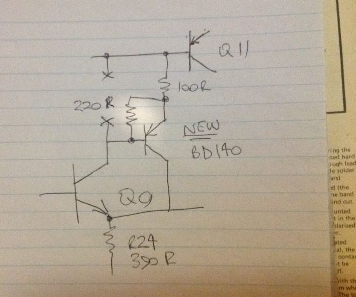

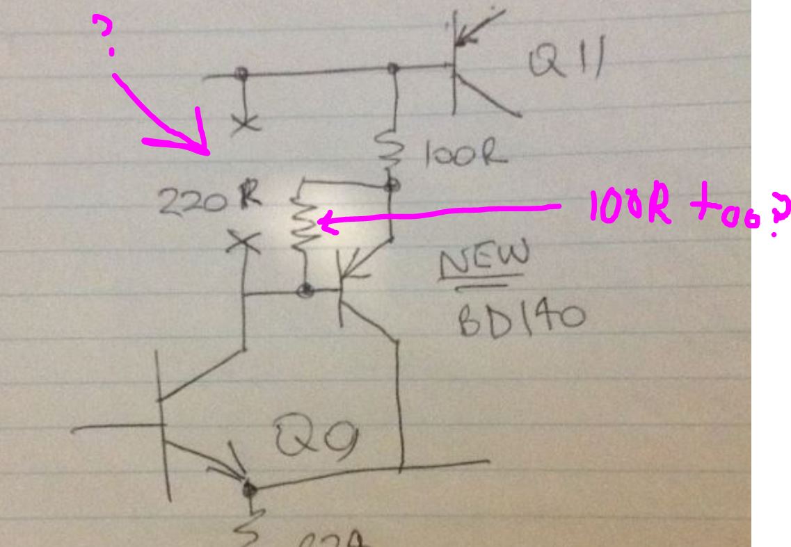

1. First thing, get rid of the electrolytic at the input and insert a 10 uF bipolar cap.
2. Next, replace emitter resistors in the output stage with good quality low inductance types (if necessary) to ensure it doesn't explode and take out all the output transistors. Noble and IRH brands are known to be suitable. I wouldn't use anything except genuine Motorola parts there either.
3. Lift the collector leg of Q9 (BD139) and insert the circuit attached, which consists of one new transistor and two resistors. You will need to then remove the fuses and redo the bias adjustment procedures.
Hope that helps.
