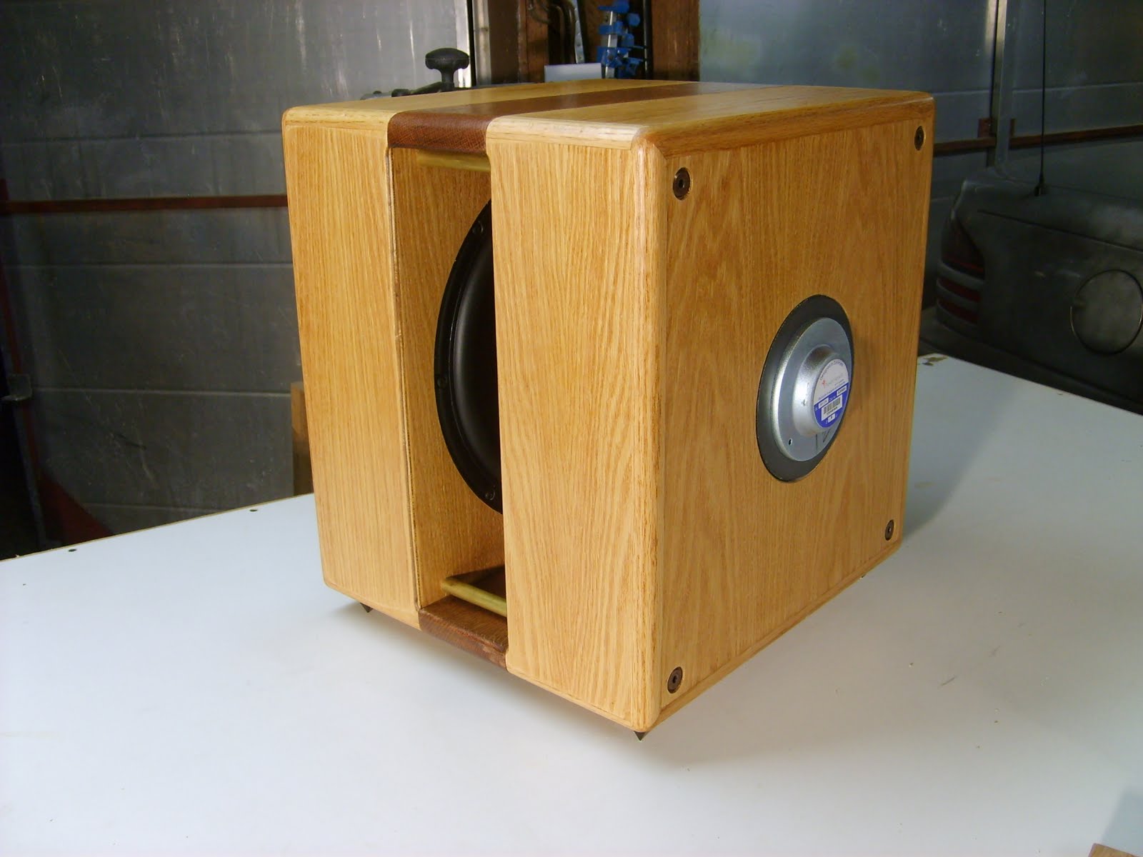

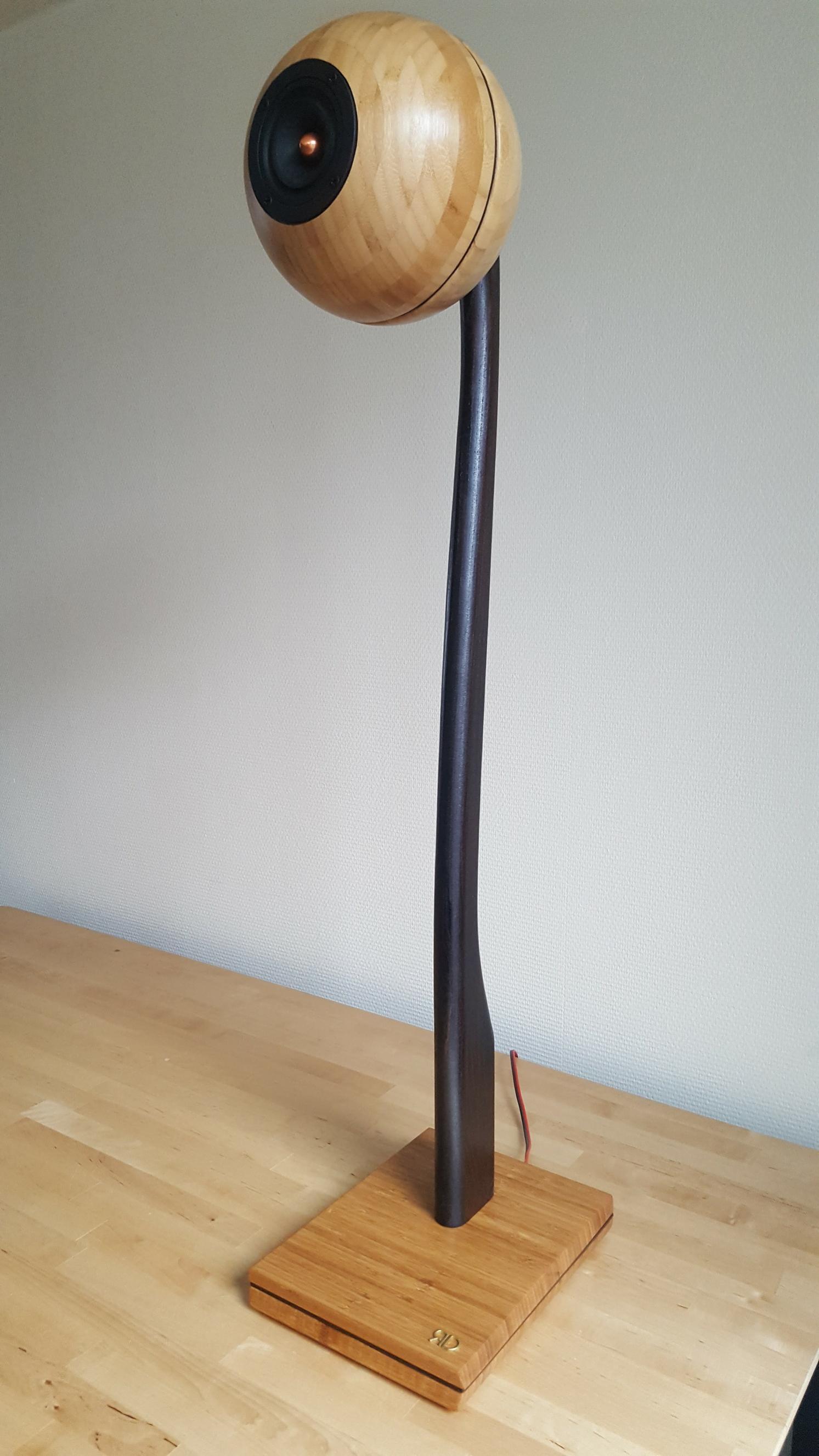

Hello all! I am planning a new loudspeaker pair for my home use on my small listening room. Hopefully you can give feedback on what to improve on my plan. All crossover duty will be handled by MiniDSP 2x4 HD. The woofers will be driven with TDA8932s, one per unit. The full range drivers will be driven by NAD 912 amplifier. My listening levels are not very high, so they should manage. Listening height is almost exact 1 meter. Measurements of drivers:
ScanSpeak 10F/8424
Peerless SLS 12
The current plan is to have a pair of Ripole subwoofers producing the 20-250Hz bandwidth. They will have 2x Peerless SLS-12 woofers in them per unit as per the original Ripole plan (attachment 1 & 2). They will be on 20cm legs to adjust the listening height. Nothing special with this, it's a well-proven design good for combating room modes. I am thinking of using 21-25mm BB plywood for the construction, should be very solid to push the internal resonances way up past the operating bandwidth.
From the back of each Ripole sub leaves an axe handle which 38cm upwards from the top of the subwoofer connects to an IKEA Blanda Sphere which houses the ScanSpeak 10F/8424, which will handle rest of the range from (200-300Hz upwards). This is pushing the capabilities of the driver a bit, but I'm fairly certain it will manage. The CTC distance between the drivers would be 58cm, which stays inside 1/2 wavelength of crossover frequency. The sphere itself will be made of the 20cm diameter Blanda Matt bowls, which would mean that the lowest point of the bowl will be 28cm from the Ripole surface and the top 48cm. Center of the SS driver will be 38cm from the surface. They bowls would after damping and bracing equate to around 1,5l internal volume enclosure (attachments 3 & 4). This would mean a critically damped enclosure of quite low Q.
Bushmeister has a good description about the advantages of spherical enclosures in his thread: http://www.diyaudio.com/forums/multi-way/307837-great-balls-prestige.html
The 10F will attach to the enclosure with a bolt and nut, having a 3mm Sorbothane gasket between the enclosure-driver and enclosure-nut. I will break all solid connections between driver and enclosure to minimize vibration transfer between them along with dampening the sphere properly.
Last but not least, a somewhat to-scale drawing of the total system (attachment 5). First time my wife saw them she commented that they remind her of ET, which I kinda agree to :D

running the dipole sub up to 250Hz is certainly ambitious :cool:
In the Sim You can just detect the chamber resonance as a small wobble in the amplitude response ~280Hz.
Even when You notch out the peak perfectly the resonance may still be audible due to its longer decay.
I´d suggest to xover at not higher than 200Hz.

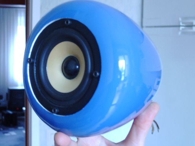

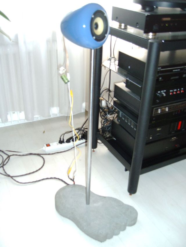

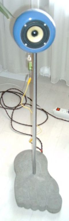

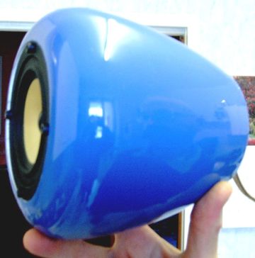

In early 2004 I built a very similar concept I called Drops, featuring the Vifa 10BGS119/8.
I used it combined with a single Ripole made from two 8" Peerless drivers (one of Axel´s original designs under the label of AudioElevation).
I put the Vifas in a small flower vase I bought in a 1€-shop (whereelse could one find such a ugly blue vase anyway?).
Trimmed the opening with a grinder to slush-fit the Vifa basket and milled a hole for the cabling into the bottom and a hole into the side for mounting purposes ... so much for convenience.
The Vifa showed a much smoother amplitude response than mounted to a flat baffle (compare to HobbyHiFi project PicoLino, 4/2001).
It still required a soft notch in the upper midrange to linearize the response ... as almost all FR do.
As the volume of the vase was so small it´d resulted in too high fb and Qtb, I used a large series Cap.
A series cap of appropriate value functions similar to a BR-port.
It equalizes the high Qtb-peak and shifts up the amplitude response below fb.
That way the Vifa could be linearized down to nearly 80Hz in a 1L cabinet and 470µF Cap.
I could have used a active crossover equalizer instead, but I just wanted to try the passive series cap thing anyway.
The bottom of the Vase got closed by a black plastic dome ... originally a egg cup :D with a opening so that a cable would fit through (the thick Neutrik cables ... which looked a bit weird considering how small the Vase was .... it rather looked like ... well ... ahm ... a sperm.
Mounted it on a stainless steel rod and a concrete garden plate in the shape of a footprint (only 5€ a pcs).
I don´t recall where I crossed the subwoofer but I think it was somewhere around 150Hz.
Sonically the combination of this little fullranger and the dipole woofer astounded everybody who gave it a listen.
Of couse the dynamic limits only allowed rather soft -but mostly sufficient and certainly more than one would have expected- volume levels .... but within this limit it played very neutral, focused and with great staging.
The tiny subwoofer reached down to almost unbelievable 25Hz.
It completed Drops in a way that the combination sounded like a true big system.
I assume Your project will lead to very similar results. ;)
The 12" Peerless will allow for more authority in the lowest registers ... and the FR will rather be the dynamically limiting part here.
You may equalize the FR either with a series cap or with the DSP to reach down to ~150-180Hz .... using 4th order Filters could reduce problems of both, the FR at its lower end and the dipole woofer at its upper end.
Attached are pics of Drops ... not fully completed.
The holding hand just gives an idea how small those thingies really were. :)

As of currently, I think I'll build Ripole + Blanda FR spheres on, but I'll make the joint so I can change the spheres later if needed. So Ripole + axe handle will form the bass-stand for the speaker :)
Question: From the plan, are the drivers surface mounted to the middle chamber? If I surface mount them, should I make front chamber wider?
Another question: if I go for the plan of 8cm wide front chamber (drivers surface mounted) but change the rear chambers to 12cm width to accommodate the whole driver (no hole on the sides), how much the performance would change from the simulated on the first picture? I assume the first one is with magnets protruding from the sides? I am very new to open baffle dynamics so please bear with me :)
the front chamber beeing much smaller dominates the response by far.
Increasing the back chamber width to 12cm results in almost negligible differences.
Sim says the Fb will rise by ~0.3Hz and chamber resonance will sink by ~5-6Hz.
The Peerless basket is made from steel and features a rather thin outer rim.
Theres no requirement to sink in thie basket into the mounting wall, but You may if You wish.
jauu
Calvin

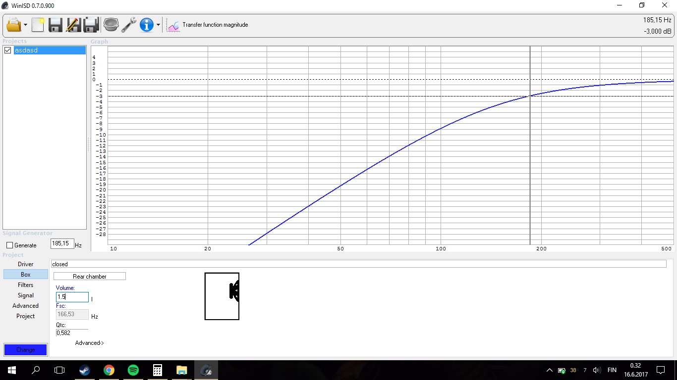

In a sealed box the SLS could be pushed higher than 200Hz to relieve the 10F steeper slopes would probably help. Byrtt has a 10F FAST that use some pretty high slopes and he seems to like it.
This is a good point I hadn't considered. I will make the woofers separate and have the full range at stands.

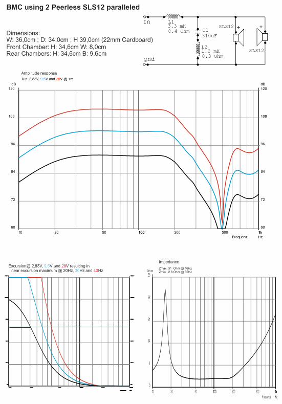

To compare the 2 x 10" woofers I have per side have a Volume displacement of 1016 cm3, the 2 x 12" SLS have 867cm3.
That´s wrong ... in a Trump-style WRooONnnG ;)
The displacement volume of a pair of SLS12 is 2x540cm²x1.6cm=1728cm³ if displacement is calculated as VC-length minus height of gap.
If You add 25% as many manufacturers do then it increases to 2160cm³.
Quite a bit more than two 10"ers ;)

My calculation used Sd x x-max (from manufacturers spec sheets)
Peerless 830669 Sd 522.8cm2 / x-max 8.3mm 0.83cm
522.8 x 2 x 0.83cm = 867cm3
You have used Sd x 2x x-max which I don't think is right.
But if I had used your formula on my 10" drivers
Seas L26RO4Y Sd 363cm2 / x-max 14mm 1.4cm
363 x 2 x 2.8cm = 2032cm3 so you see that ratio is the same, my two 10" drivers have a lot more x-max which overcomes the reduced amount of Sd.
If I then added 25% I get to 2541cm3
Whichever calculation method you choose the 2 x 10" woofers with 14mm x-max have more Vd than 2 x 12" with 8.3mm x-max.
Can you find someway to disagree with that? Fake news maybe?

As Calvin was so adamant that the calculation I used was so wrong I had a think about it because I would prefer to know if I have misunderstood something.
So here is a fictional example with simple figures to make the maths easy.
If we have one woofer with Sd of 500cm2 and 10mm (1cm) x-max it's Vd is
500cm2 x 1cm = 500cm3.
If we then add another woofer the same we will double the Vd which would be 1000cm3.
So if we use the calculation I showed
500 x 2 x 1 = 1000
If we use the formula Calvin showed
500 x 2 x 2 = 2000
To me that confirms I had it right.
We can compare the Vd figures quoted to Small's graph for SPL vs Vd in a sealed enclosure that. If two Peerless 830669 woofers had a Vd of over 2000cm3 then they would be able to produce a peak spl of nearly 117dB at 30Hz which does not seem likely.
At 867 it goes down to about 110dB peak which seems about right.
