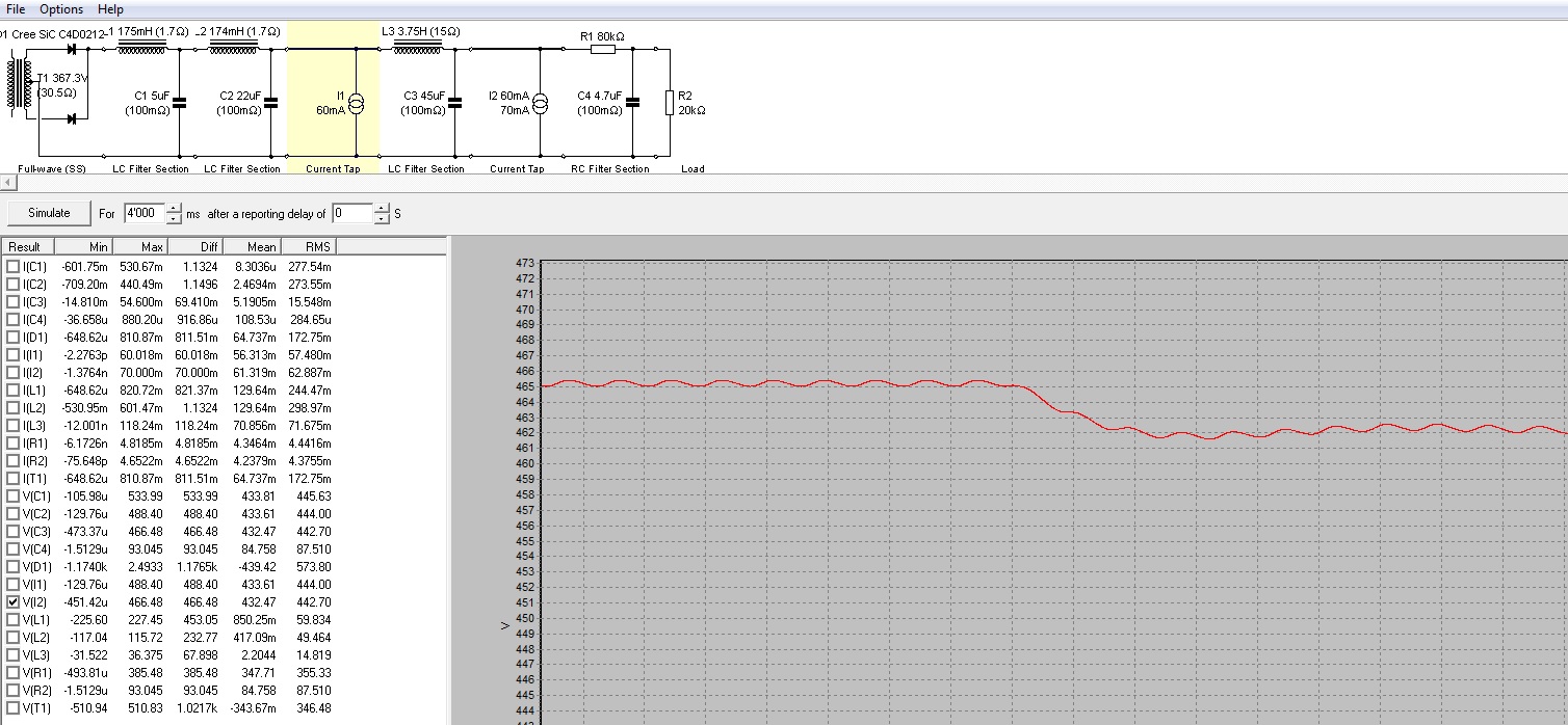

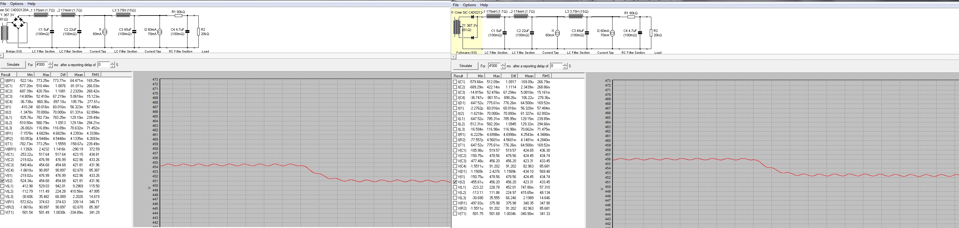

To answer the question as cleanly as possible wrt full wave vs. bridge, I did a simple simulation using silicon diodes. Since they have such low DCR. If I used damper diodes, I would have to factor in the Ri of each tube.. etc. I Don't use silicon diodes this way btw - I use damper diodes in my builds - this is just a test to see how PSU II behaves.
In the first screen shot, I just changed from bridge to full wave with no change in secondary impedance. The voltages are nearly identical - a bit lower for the bridge (I guess those silicon diodes do have a tiny bit of DCR after all).
In the second screen shot, I cut the secondary impedance in half. Look at how the B+ shoots up now (which is incorrect for that supply).
These pictures should tell you everything you need to know.

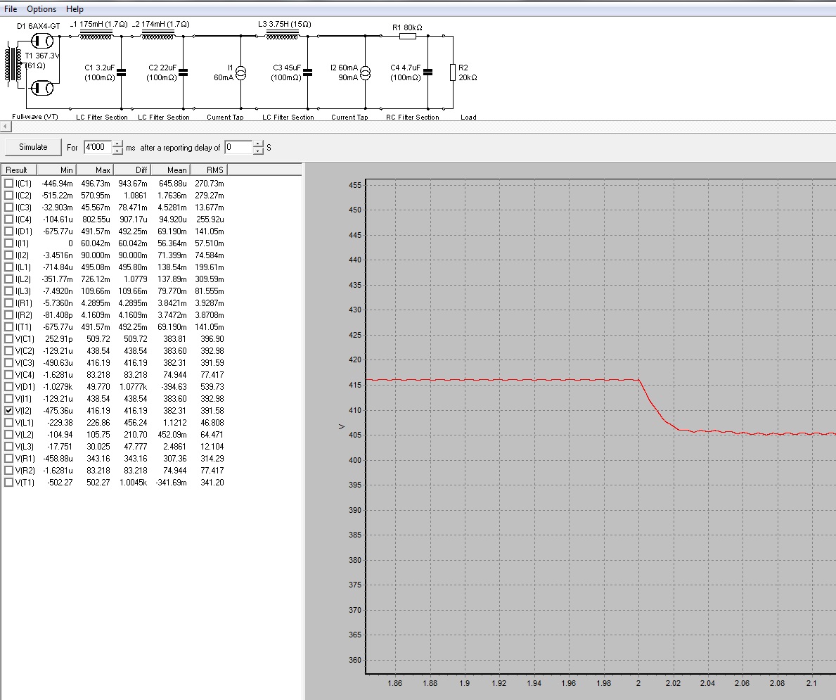

Just an aside, but that supply settles after a 30mA current change, without ringing or much overshoot in 20ms (even when you use 6ax4-GT) in simulations - which is not bad. Try to beat it if you can. Of course today we have the possibility of fully regulated solid state supplies which can do even better. Alas, those supplies do not have glass bottle that emit heat and a pretty spectrum of photons. My wife prefers the kind that glow.

Here is what I used in that supply.
It performs just like simulated. The power transformer and chokes are from Thomas Mayer. All caps are film. Nice Q factor? 😉
