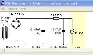

In trying to design a PSU, I am not sure how to calc the estimated load, and the current requirement for the transformer. I would like to use some relatively high plate current tubes (starting to try and design some things, but want to use something like a 6W6, 6AS7, etc). This thread recommends putting in a current tap for the estimated current draw of each tube: http://www.diyaudio.com/forums/tubes-valves/196009-duncan-amps-psu-designer-ii-help.html but I want B+ to be constant across the circuit. For illustration, let's say I have four tubes, two that draw max 50mA and two that draw max 5mA. Can I just put in one current tap for 110mA? May I use a 110mA transformer and then just plug in capacitor and resistor values that meet my B+ and frequency response requirements? Or do I need to use a 250mA transformer which is the RMS value for I(T1) on the PSUD, or 350mA which is on the graphical display. I can't seem to find the answer to this anywhere. For this illustration I have a 250v transformer, the values come up with about 250v B+

Hah, that is part of my learning curve. I am starting out with simple two stage triode (or triode strapped pentodes) preamp circuits. The triodes will be in separate bottles. (Proposing a high mu triode and then a low mu triode strapped pentode for each channel. ) I am assuming class A. The first stage current draw is a few mA, in my example 5mA. The second stage is going to be around 20-30mA, so I picked 50mA. So do I put a constant current of 110mA for the PSUd? or two taps, one for the pair of triode strapped pentodes and one for the triodes? And then how to I calc the current req't for the transformer. If I'm reading the PSU designer correctly, I'd need a transformer rated at 250mA. The main question is 1. how to determine the load for the PSU (i.e. what and where to put the constant current) 2. how to determine the current rating of the transformer I can see the need for additional filtering, but if I add another RC stage, What I am want to know is how to estimate the load for the power supply, and the current rating I will need for the transformer. I do not know how to put a resistive load or a constant current for the designer. E.g. if I have two tubes that draw max current of 50mA each, do I put a current sump of 100mA for the calculator? And if so, what is the current rating of the transformer
The latter, two taps.
Well from what I can extrapolate from the information given without a schematic I assume the current will be somewhat constant in your circuit. I am not really familiar with the software but I am assuming that the 250mA for T1 is for the primary, 110mA at 250v (secondary) or 220mA 120v (primary). Kirchoffs law?
So if you plan on pulling 110mA then that is the minimum rating of a power transformer you need.
The load is 110mA, you put the current taps on each node. So for you there would most likely be two, 100mA for the low mu triode strapped pentode, and 10mA for the high mu triode.
You don't have grossly huge capacitors in your power supply so they won't have a ridiculous inrush current, 110mA is your secondary load, primary might be more due to other secondary loads like heater taps.
If the two tubes drawing 50mA are on the same node then yes put the sum of both those tube as the current source. The combined sum of current sources will be your rating spec.

OK, I think I see it.
So if I am understanding correctly:
I have four tubes. From the plate curves I've drawn, V1 and V2 will each draw 5mA, V3 and V4 will each draw 50mA. Total equals 110mA. I draw a PSUd with two B+ nodes B1 with a 100mA sump and B2 10mA. So far so good. I connect the low mu tubes to B1 and the high mu to B2.
I need a transformer secondary rated at 110mA.

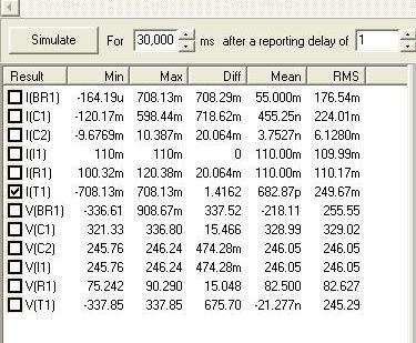

What was throwing me off is the simulator was saying I(T1) is about 150mA, which I now see is what the PSU itself is drawing from the mains.
No. DC current draw of 110mA does not equate to a transformer secondary AC rating of 110mA (unless you are using a choke input supply). The transformer must be rated for the RMS current, which PSUD2 will give you. This will be rather greater than the DC current.
You can relax this requirement for a Class B amp which will be amplifying real music, as it will have a low duty cycle. For Class A or highly-compressed music you have to have a bigger transformer.
250 mA is a safe rating to use. The transformer will likely have more series resistance than 31 Ohms and some leakage inductance, which will result in a bit less RMS current. So you MIGHT get by with a 200 mA transformer. But the current carried by the transformer is always more than the DC current when you use a full-wave bridge with cap input. RMS current is the value you need to look at, as that's the value used for a transformer rating.
As far as the transformer is concerned, yes you can put the current source where you have it now. Ultimately it is sucking 110mA from the raw power supply, just like your imaginary amp circuit. But if you were modelling multiple filter stages then you would put your current taps in the corresponding places where the valves would be placed in reality.
As already pointed out, it must handle the RMS current, or about 250mA in your example. However, your transformer winding resistance is rather unrealistically low (31 ohms). I would expect about 100 ohms. This will reduce the RMS current. In reality you should find the RMS current is about 1.5 to 1.7 times the average DC load current. For your 110mA example, I would use a 170mA transformer as a minimum.
But how do I know how much transformer resistance to use? Well it's a bit of iterative guess work. You're currently looking at a 250V, 250mA transformer right now, or 62.5VA. A transformer of that size will most likely have a regulation figure of about 8%. In other words, it will deliver about 270Vac off load, falling to 250V when the full 250mA is demanded. That's a source resistance of 20V/0.25A = 80 ohms. But such a transformer would be overkill; in reality a 200mA transformer would be more than enough in this application, and would probably have a source resistance of at least 100 ohms. I'd use that figure to begin with at least.

For a Class A amp the load current is substantially constant, so either a resistor or current source works equally well. I prefer to use resistors as they are somewhat more representative of how a real amp works (i.e. if the supply voltage rises, the load current will rise too).
Yes.
