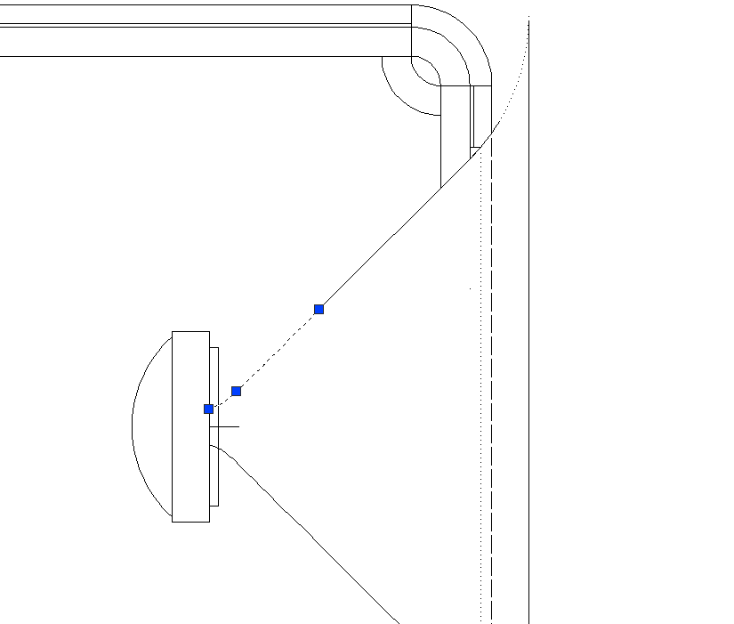

would you have the curve without the red reference lines? If so, I could use the squares to read twice the number of points for a better accuracy. But, perhaps it is not necessary?
Kindest regards,
M
If I delete the red lines then the dimensions will also be removed.

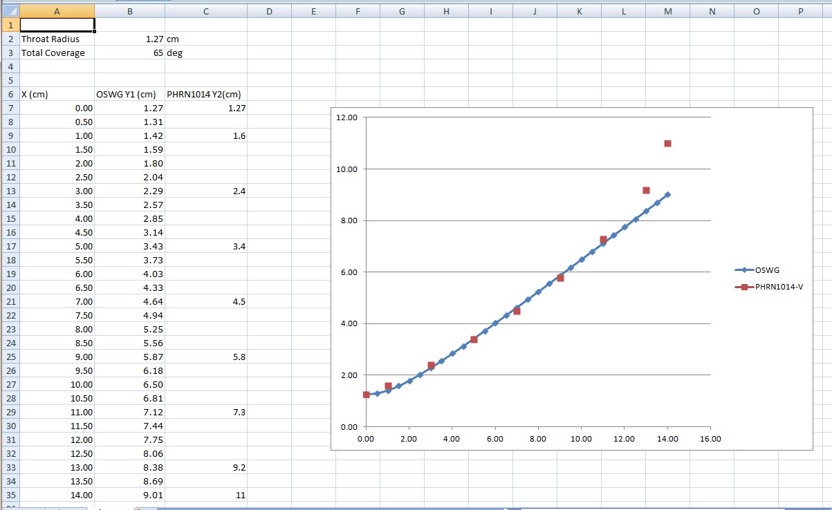

I've compared the vertical PHRN1014 profile to OSWG. I would expect this to be similar to @mabat's ATH where some portion (first 50%) is OSWG then some portion is mouth termination (last 50%). It looks close but it could also be a Quadratic which is close to this curve. You can see the deviation for mouth termination starting at 10cm. As I said, manual measurements have some noise that's why I used FreeCad's B-spline to smooth the curve.
I've included the xcel spreadsheet if you wanted to experiment.

thank you for the spreadsheet. I have recalculated using your spreadsheet with 60 deg angle, which yields the same figure as I posted.
I agree with your description of the B52-PHRN-1014 curve vis-a-vis the ATH4.

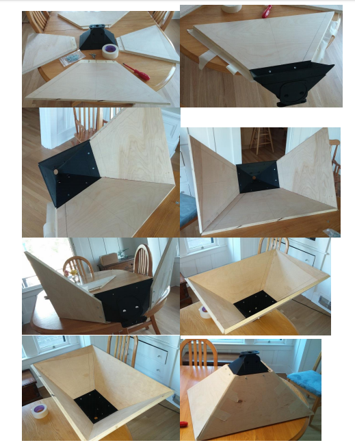

This is quite big I wonder if foamboard and fibreglass will work out. mark100 had trouble using this method of construction putting extra flares on one of his builds.
I do have same experience with such a structures, so I am rather confident that this might work. Look at the hand-launched airplane models, their wings are rather thin, they are subject to high forces on launch, yet they are built by this technology.
Regarding Mark, if I recall correctly, he had a problem with the joint between the plywood conical section and the Styrofoam end sections, and he did solve it.
