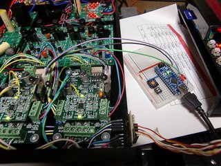

One of SDTrans192 Rev. 3.0 users, sunacchi in Japan, reported his recent achievement in his blog page (In Japanese).
BaffaloII‚ÉArduino‚ð•t‚¯‚Ă݂½: Ama Ama Audio Visual
His DACs are dual mono configured Buffalo IIs ( with Fidelix 96MHz oscillator) and controlled by Arduino.
Even for 352.8 kHz/24 plays, he said he succeeded in maintaining locked state for a long period(but not perfect). I think his special enhancements on power supplies of both SDTrans and Buffalo IIs resulted in "the lowest" setting.
Does anyone succeed in applying "the lowest" DPLL Bandwidth parameter for I2S input with OSF/On, Jitter-eliminator/On?
Bumpei, nice link. I think it is because of cleaner power, although the author does adjust the quantizer registers (I don't know if that has anything to do with it)
